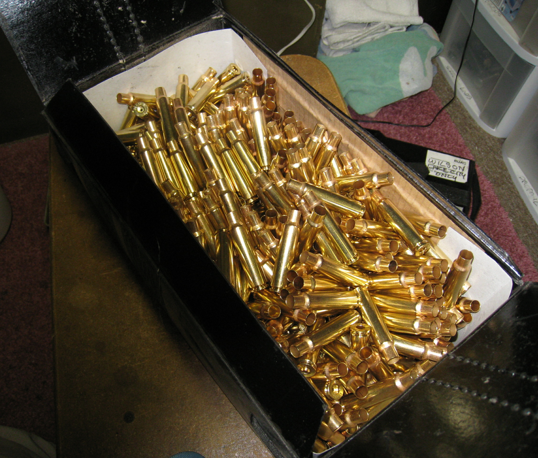

    And this is all "Ruag gold" being prep'd and weighed for precision shooting.
Name:	RUAG GOLD.jpg‎
