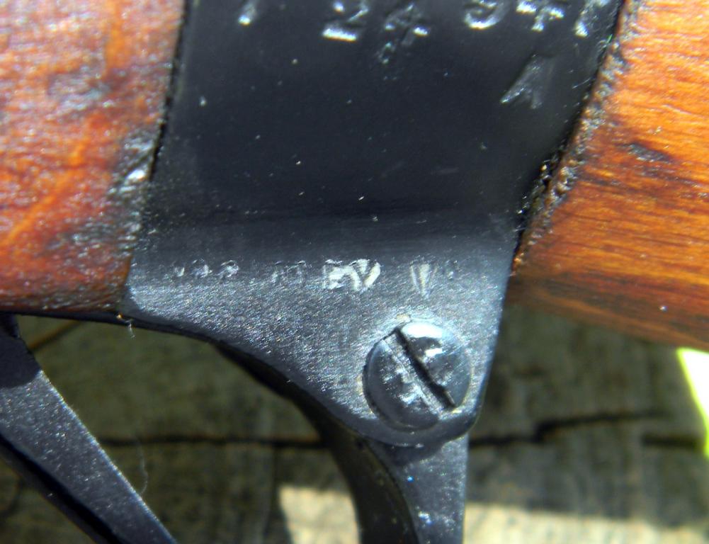

    I forgot to add that I have one of those original rifles in stock and for sale. Purchased from me in 1990 and consigned from the son of a lifetime friend who passed away unexpectedly a couple of years ago. It's a '44 BSA. It sports the '46 post war stamp on the left butt socket and is still in its original blackened finish. No one seems to know where they were inspected, repaired and marked but I suspect it was a pooled ordnance workshop in Europe. The Britishicon and Canadians had them in Germanyicon and possibly Italyicon. When I imported hundreds of the former Greek issue Long Branch rifles in 2001, many of the wartime dated rifles had the '46 stamp on the left socket too.

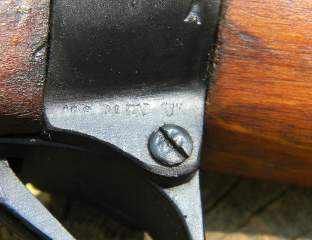

    Thank you, Brian.
    I looked at the import mark on the bottom of the buttsocket under magnification and could not make anything out to be legible. It honestly looks like a vise-grip mark or similar. But I'll try to take a closer macro-pic.
    Thanks also to all who are trying to decipher this specimen.

    Here's what it is: "IAC ALEX VA", short for "Interarms Corporation Alexandria Virginia". I think they caught Hell from BATF&E and that's why they changed to engraving on the left front bodyside.

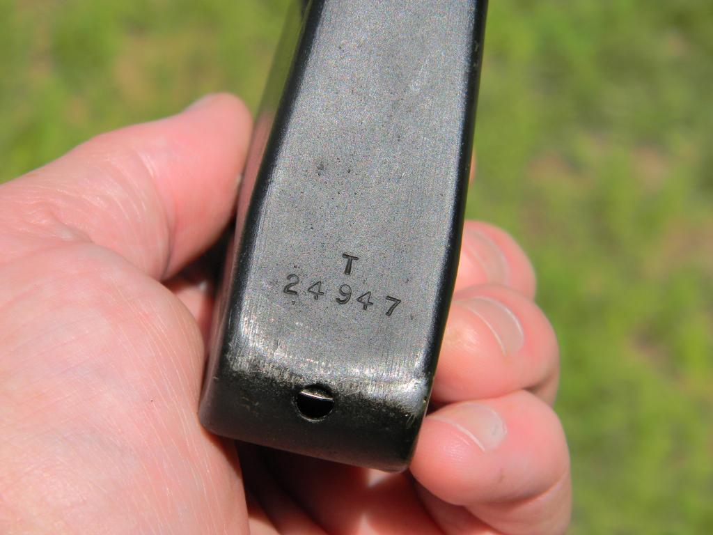

    If there are any particular areas you would like to see photographed, let me know in the next hour or two from this post time stamp when I will have time to take more pics. Thanks.

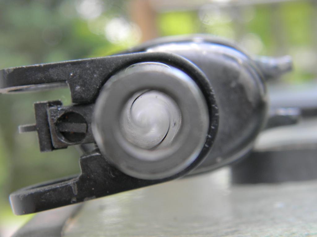

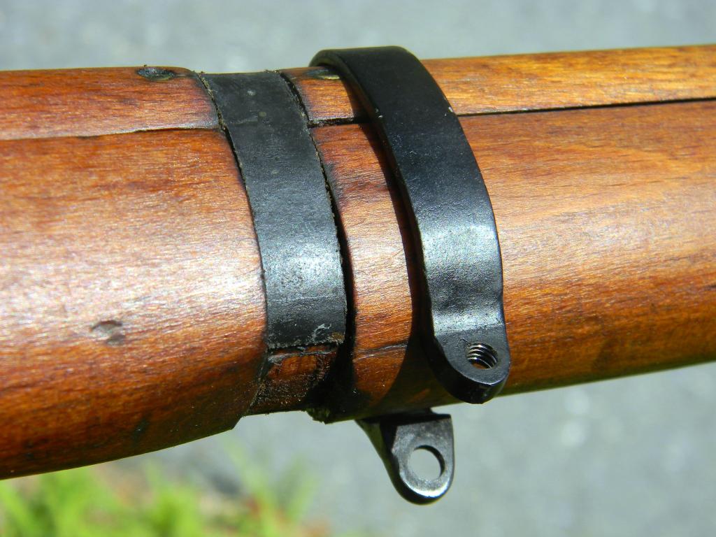

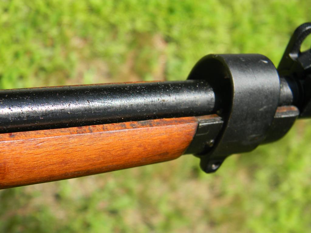

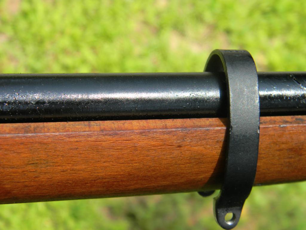

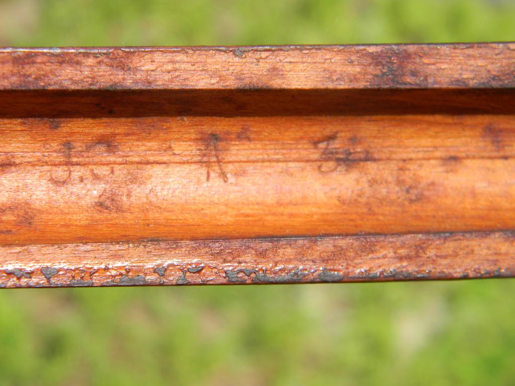

    Under the handguards, it looks like a greased barrel. There is a gasket-material shim under the middle band, Rear guard has "J.S. ^ 3" on the inside channel.
    ---------- Post added at 02:04 PM ---------- Previous post was at 02:03 PM ----------
    The import mark still looks like a few scratches, at best.
    ---------- Post added at 02:07 PM ---------- Previous post was at 02:04 PM ----------

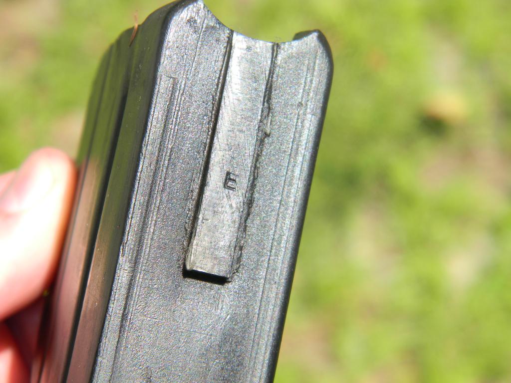

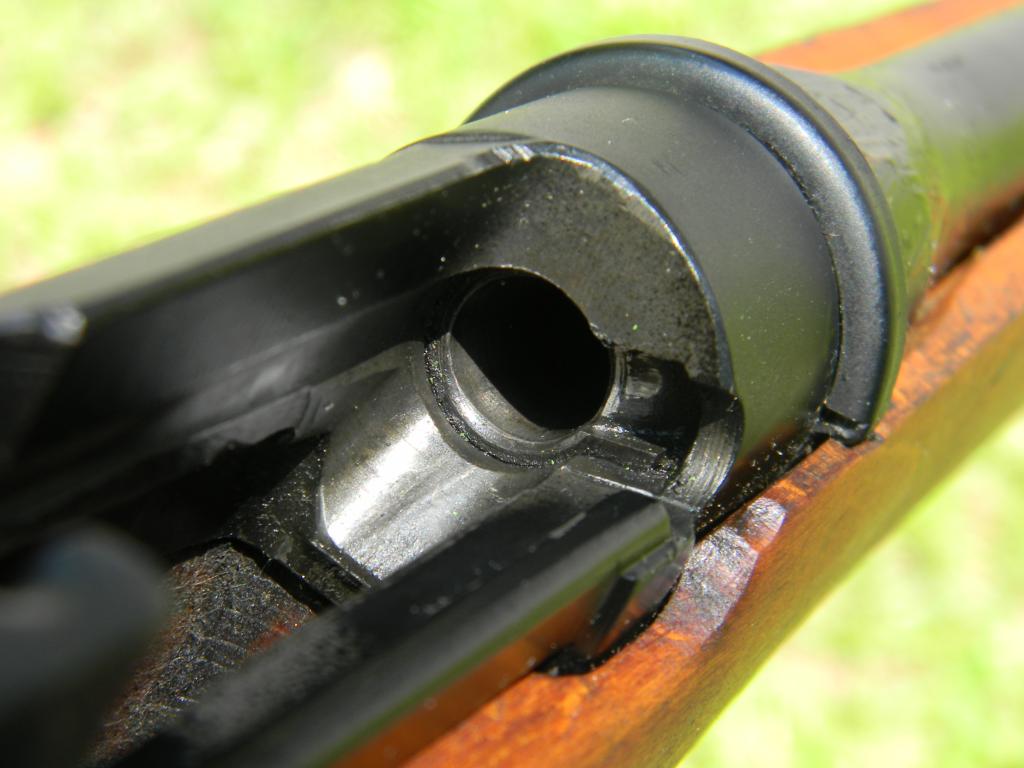

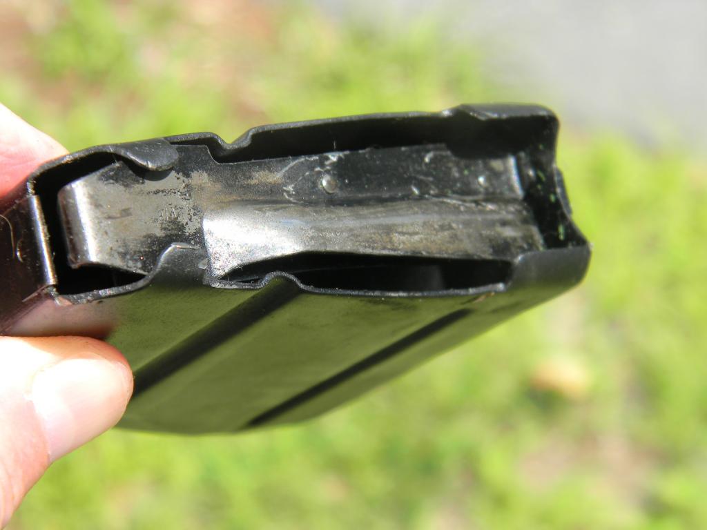

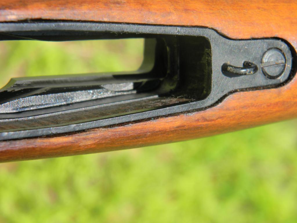

    Mag well, mag, and feedramp/chamber.
    ---------- Post added at 02:09 PM ---------- Previous post was at 02:07 PM ----------

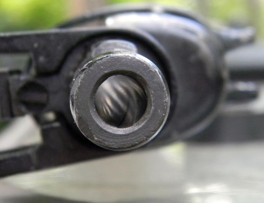

    Nice, two-groove bore and flat crown.

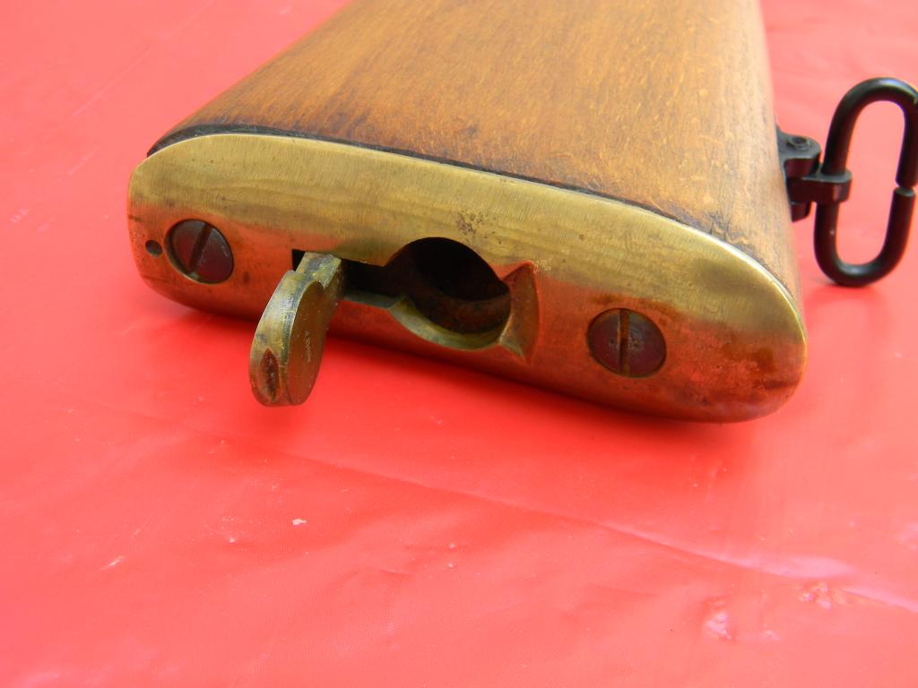

    Brass buttplate and trap.

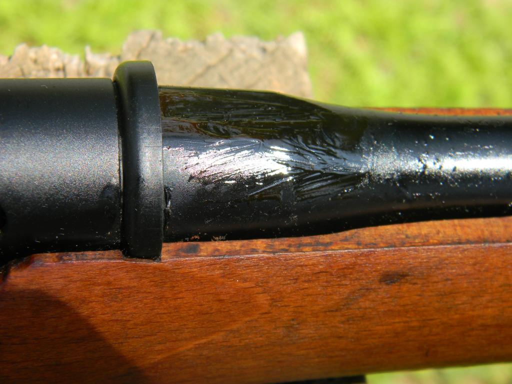

    It's a roughly-made 1942 rifle which has been massaged by someone to present a sort of post-FTR appearance. Look closely at the "import marks": do you see fresh phosphating where the paint has flaked off? Can't say I do, but not that close a photo. Were it a service overhaul from all Peter has told us over the years, we know it should be there. In my experience any kind of paint over any decent phosphating with a good crystalline structure will bond like hell, so that sort of flaking means either crap phosphating or none at all.
    The proof of the work "down the shed" is the serial number added to wrist of the butt, as though on a No.4(T) Notice how heavily sanded the woodwork is? I venture an armourer would have re-stamped the forend number.
    Some wanker who didn't know his game well enough. He might as well have taken the trouble to round off the all the nasty sharp edges left during original manufacture, that at least would have been some improvement.
    The fugly welding in of the charger guide bridge might be a souvenir of the superb original craftsmanship, or one of those ham-fisted repairs one sometimes see where they couldn't be bothered to grind off the blobs of weld after. IRRC this could be an original feature or a post-war job.
    From somewhere an apparently brand-new backsight has been found, but the lack of any maker's mark we can see and the strange horizontal lines on the back of the sight arm suggest perhaps a factory reject which has subsequently surfaced and been resold. Such things did occur, witness the many reject, but original No.5 flash-hiders that turned up about 25 or so years ago.
    It would look like that.
