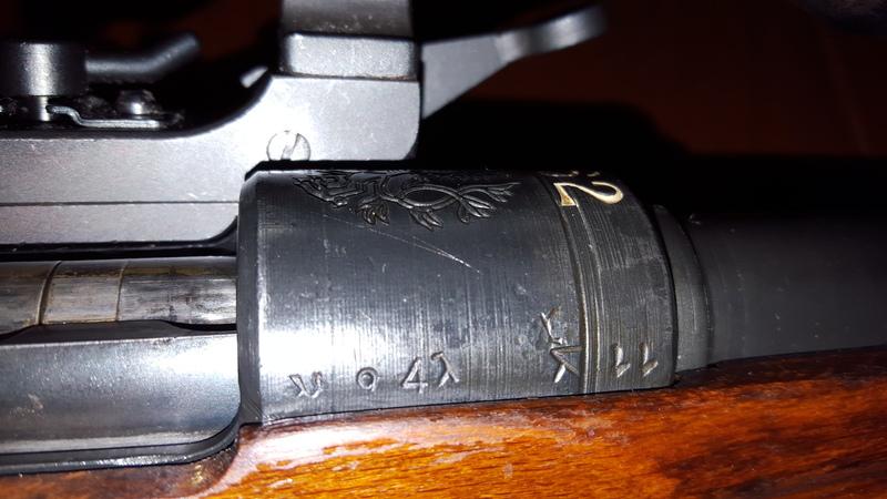

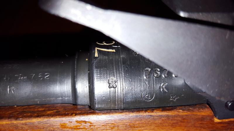

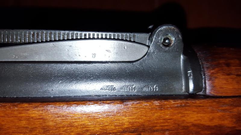

    John, are there any Waffen Amt markings left on your rifle which you have noticed or have they all been removed by the Israelis in their refurbs, please? It looks like a nice rifle.
    There are a few waffenamt stamps on the rear sight, but non that I remember on the receiver (did the Czechs have waffens on the receiver?) And of course non on the barrel.
    And thank you! It is a VERY nice rifle! I was very fortunate to get it.
