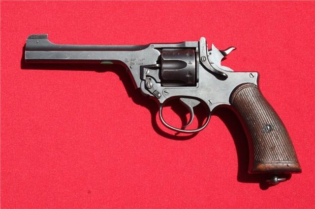

    Hi,i just bought one tanker type,i would like to know cylinder gap front and rear,thank you
    05-26-2024 @ 07:16 AM
    16,523
    05-28-2024
    05:24 PM
    Rear 0.07" must pass across striker hole
    Front, with cylinder held forwards. Must be between .002" and .018" on each chamber

    I just got my Enfield No.2 Mk1.
    Thanks for the info.

    I will be most happy to accommodate Peter.
    My pics were gone so I tried again.
