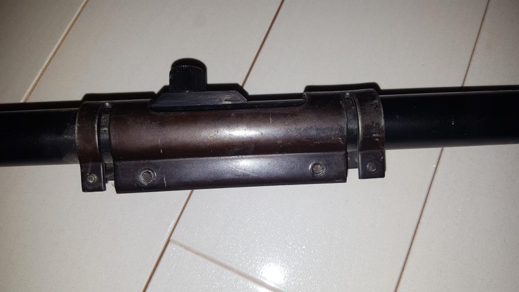

    A T01 mount was neatly installed along with an optic I can find no information on.
    Any info, comments, questions are welcome.

    The small marking on the scope/scope mount reads SUWA. It is a Japaneseicon scope name from the 1970s. Argentineicon used SUWA scopes on their M1909/73 sniper rifle, just to give you an idea on the period.

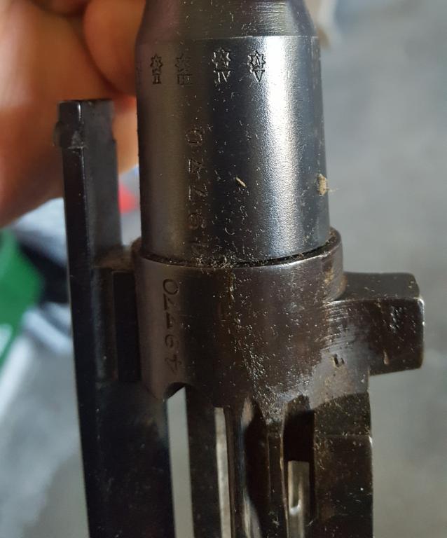

    is this what you meant under rhe sight? What does it tell us?

    Not quite, the underside of the one with the range graduations on it.
    HV = High Velocity
    SC= Short Cone

    Gave it a light tear down and cleaning and am pretty impressed with this sporter job.
    Whoever did it understood the enfield.
    Tight, rebuilt draws, barrel contact at the knox (or is the chamber section of the barrel the reinforce?), free floated then contact at the end of the forend.
    Parts are like new inside, no wear at all on the sear and the barrel is excellent.
    Going to remount this scope as it was canted and try it out again this weekend.
    Maybe i just dont what to look for but I dont see any FTR markings??
    MA VT on barrel is the american impprter??
