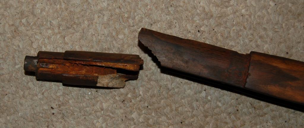

    The Swede news went from bad to worse. After breaking two screwdrivers and stripping the screw head, I decided that I was going to need a new screw anyway so I drilled it out.
    The trigger assembly is all froze up and is a Timney, not sure but I don't think these are original to the rifle. The action and barrel under the stock do not look terrible, not nearly as bad as the last 5 inches.

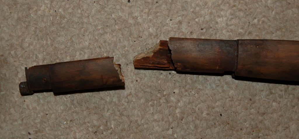

    The stock however is all dry rotted and I couldn't tell this until now. The end just essentially fell off. So the project to return this to "original" status just got a lot more difficult.
    My options are to cut the stock down, cut it back to the band and add a new end or get a new one. I guess all that depends on whether I can save the action and barrel first.

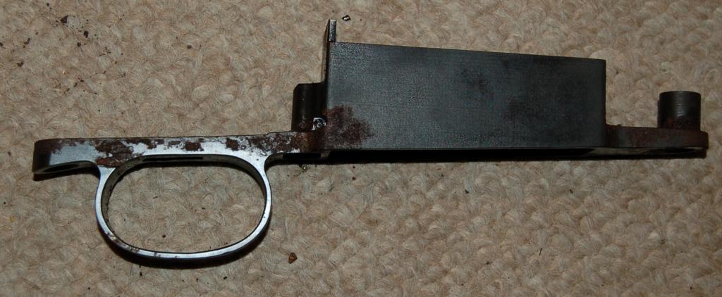

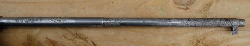

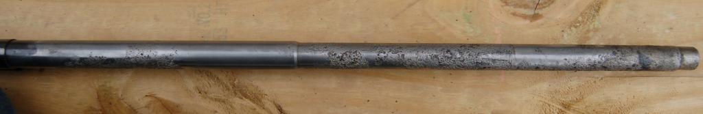

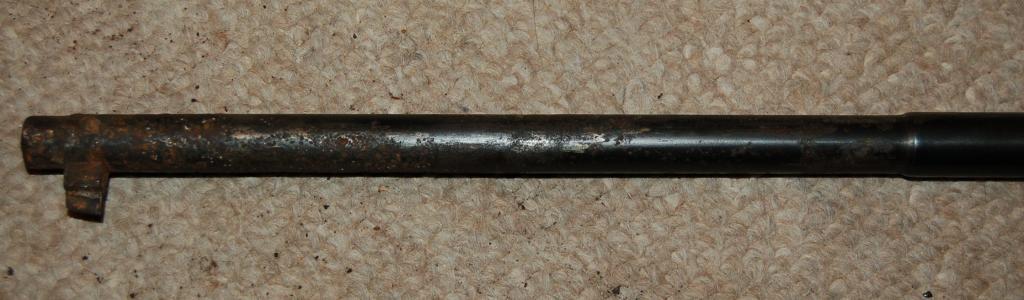

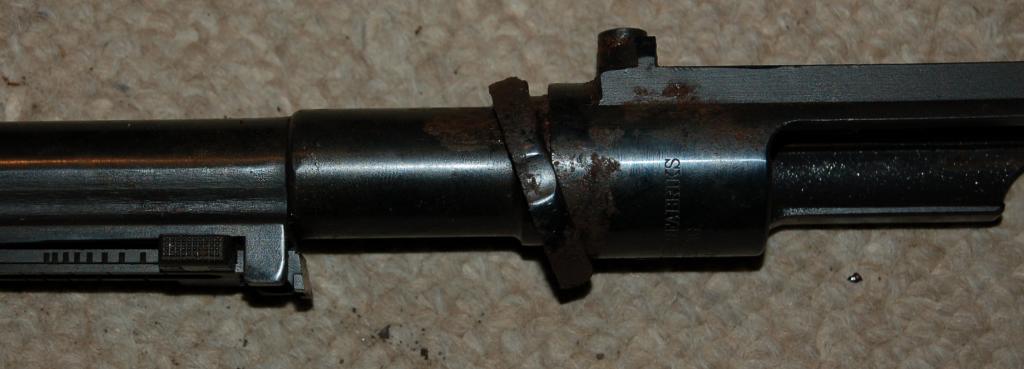

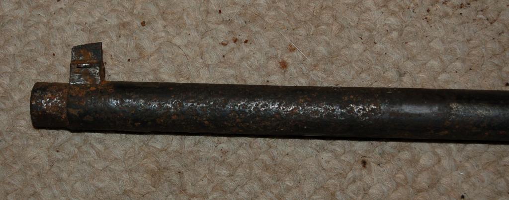

    As of now, I have most of the scale off the barrel. The barrel bands are soaking in vinegar, the bolt is pretty well cleaned up except for one tough spot. Here are a few shots of the barrel and action and the dry rotted stock end. It looks like the dry rot may extend a bit beyond the barrel band area. I may end up putting it in that old carbine stock that I have. It was cut down also but it looks nicer than this one anyway.

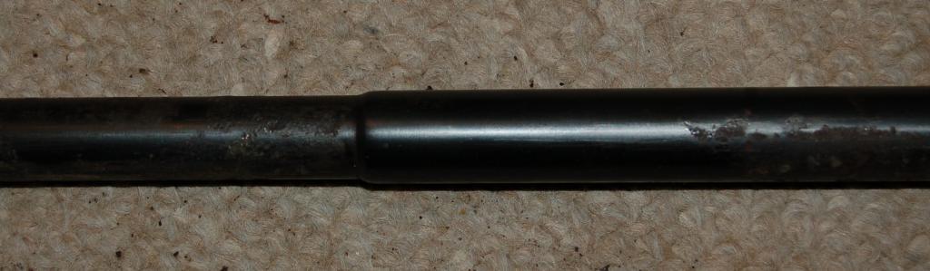

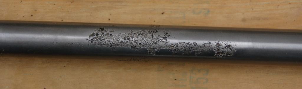

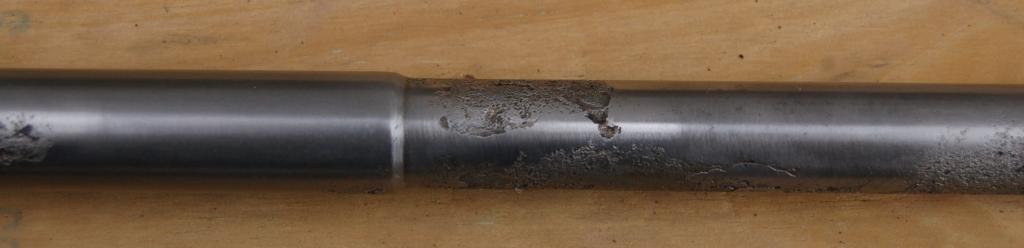

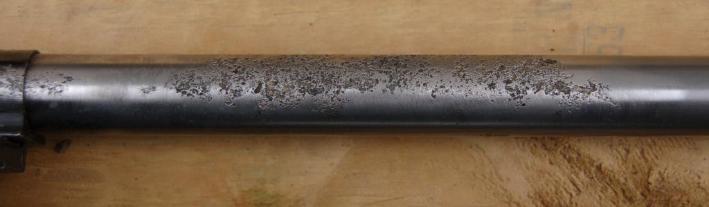

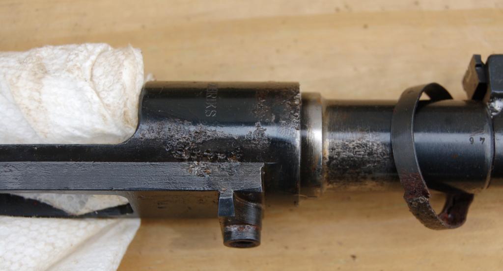

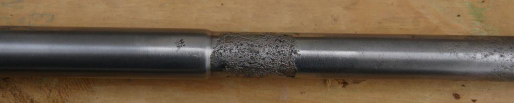

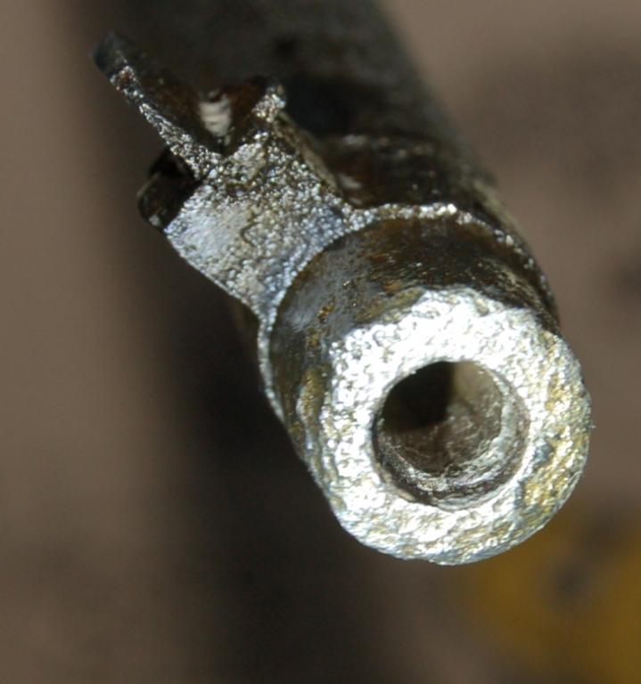

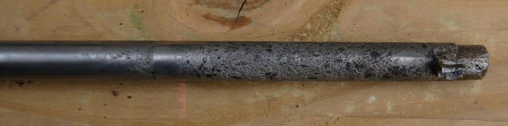

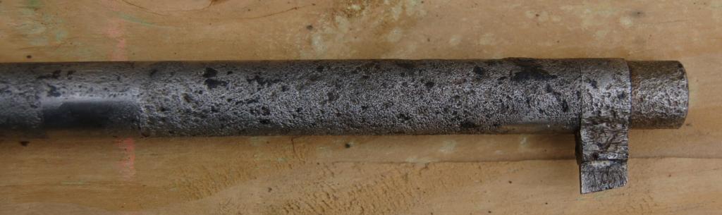

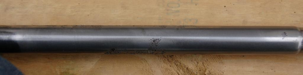

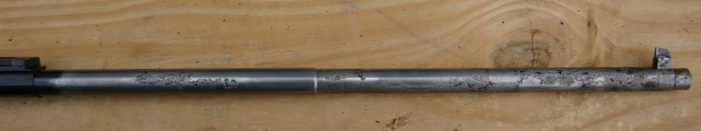

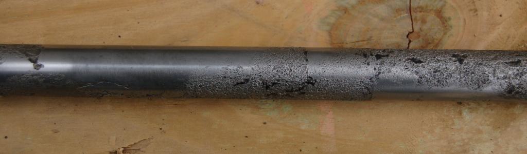

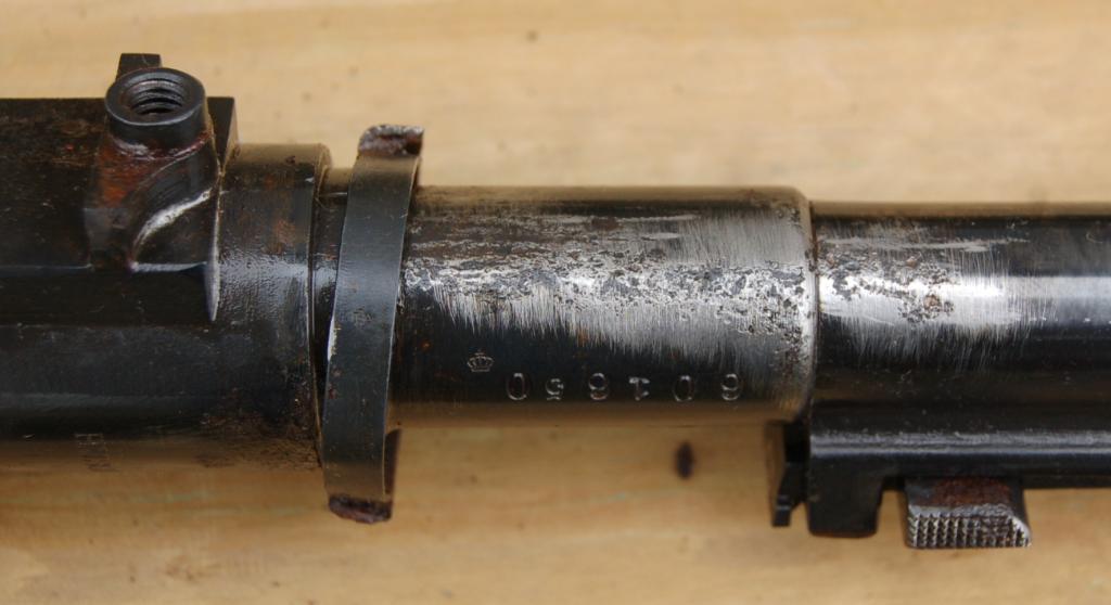

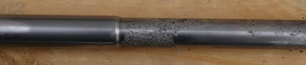

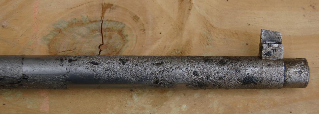

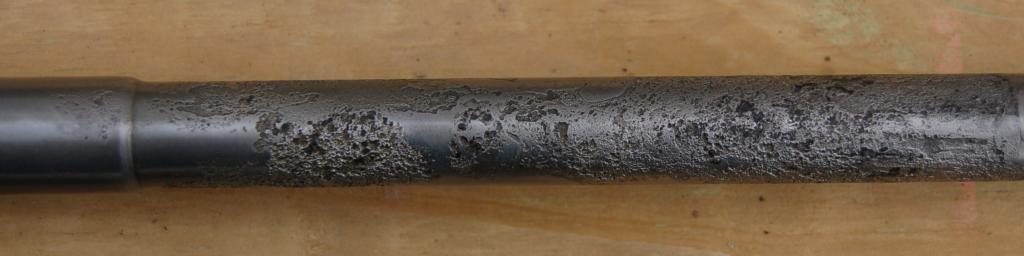

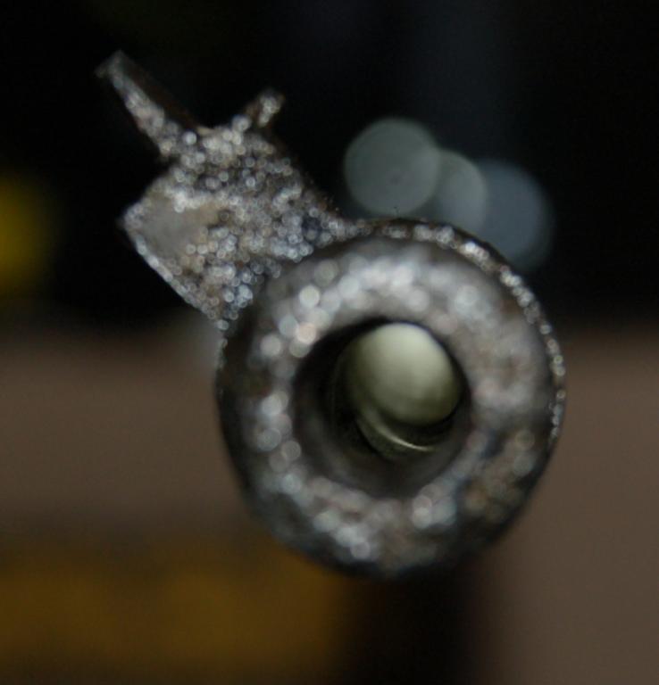

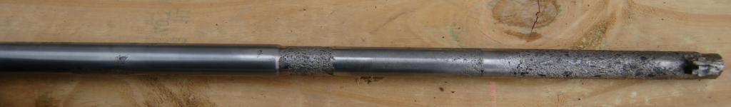

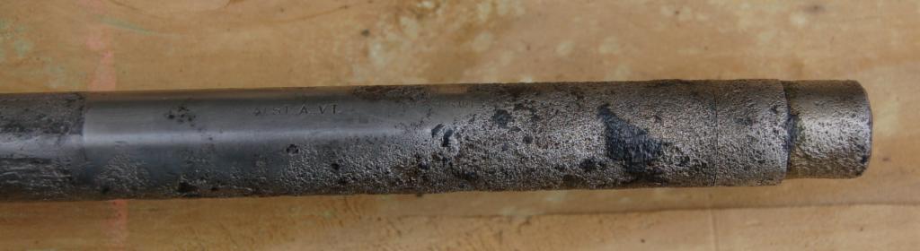

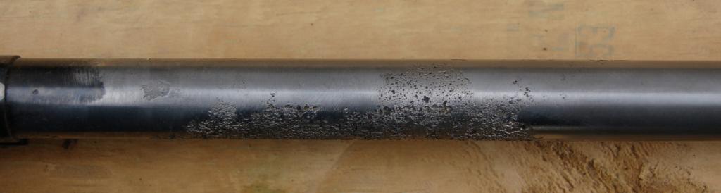

    Gave the barrel the vinegar soak today. Five hours in the vinegar a scrubbing and another hour and another scrubbing. Then a hot water bath with dish soap, dried off and then sprayed liberally with Liquid Wrench. I hope the photos are good enough to judge condition. I took them in order so there are four or five per side with a full length to show where on the barrel the other photos are taken. The dark brown areas still contain rust. Overall, I don't see anything extremely deep but I have no idea how deep is too deep for safe function.

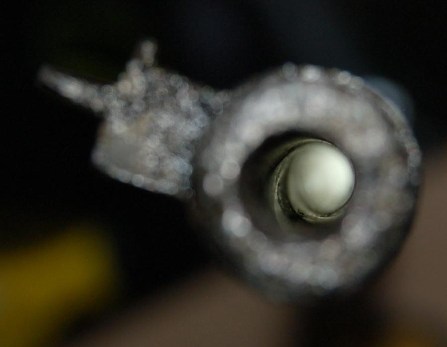

    Here are my best attempts to take photos of the bore, I have yet to figure out how to do this so they aren't the best. The barrel has already been counterbored about an 8th inch. The rifling is good almost right up to that counterbore with the exception of a couple of spots where it is pitted another 8th inch or so.
    And finally, the worst areas on the receiver:

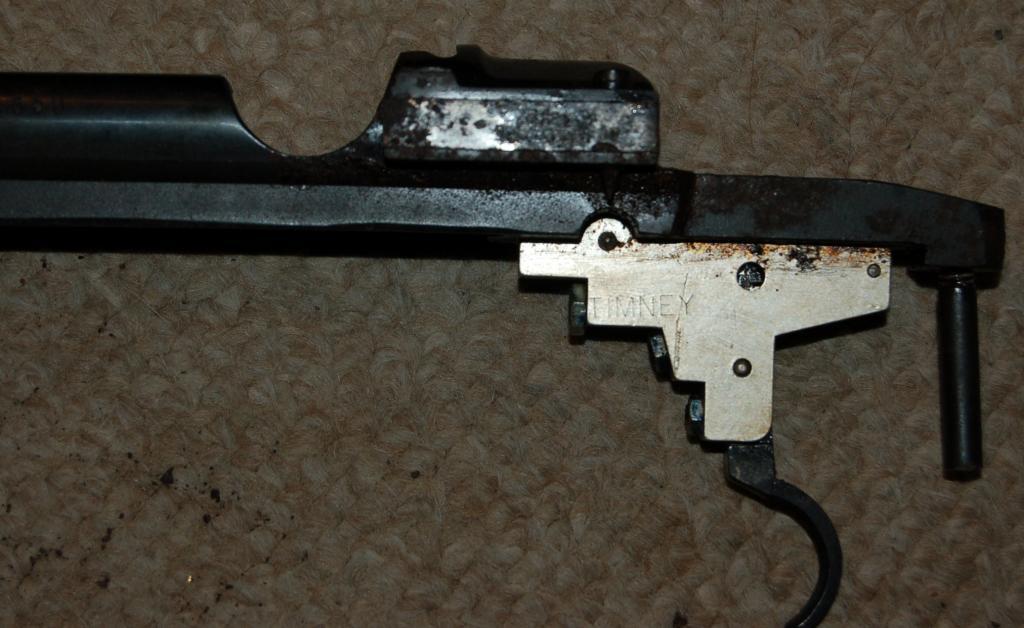

    So what do you think, is it functional? Safe? The Timney trigger I was able to get off and get working again. The previous owner had it set at a hair trigger and it was frozen in place on top of that. Is working fine now and I set it to a more normal setting.

    You're a brave lad for tackling this one!
    I am in severe doubt as to whether that barrel will ever be usable (I can't judge the depth of the pits from here) but if you want it to at least look respectable, then a complete electrolytic derusting is the only way to get all "red" rust out of the tiny corners where no brush will reach, or at least converted to "black" rust, which is chemically the same as bluing (sorry, I keep on confusing ferrous and ferric oxide, and can't be bothered to dig out a chemistry book right now) followed by a parkerizing process as described here
    https://www.milsurps.com/showthread....762#post256762
    then fill with "liquid metal" (i.e. metal-loaded epoxy), smooth and paint with Suncorite or something similar.
    At least it would look better. But shooting????

    Thanks Patrick for your advice. I gave it a second vinegar treatment today and nearly all the rust is off of it now. I think for now I'll oil it up to stabilize it for a bit while I can think on what to do with it.
    I'm not sure I want to make it look "nice" if it isn't functional. It isn't a rare piece and even if I wouldn't shoot it, someone else down the road might make the attempt.
    I'll see if I can find someone locally that can evaluate it. It's a shame because the interior is nearly perfect with the exception of the last half inch.
