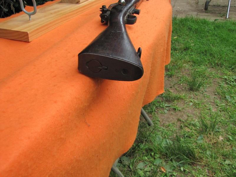

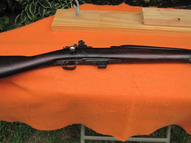

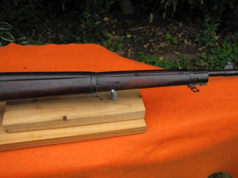

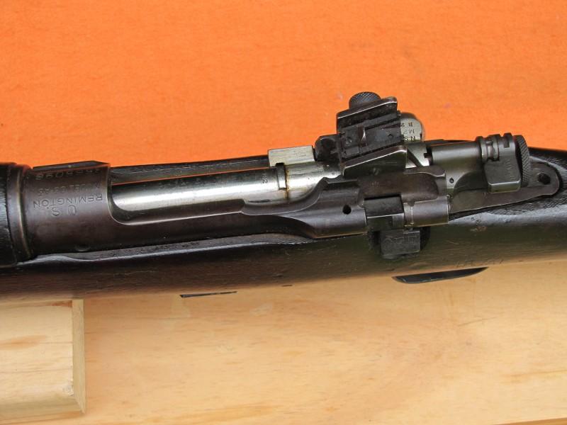

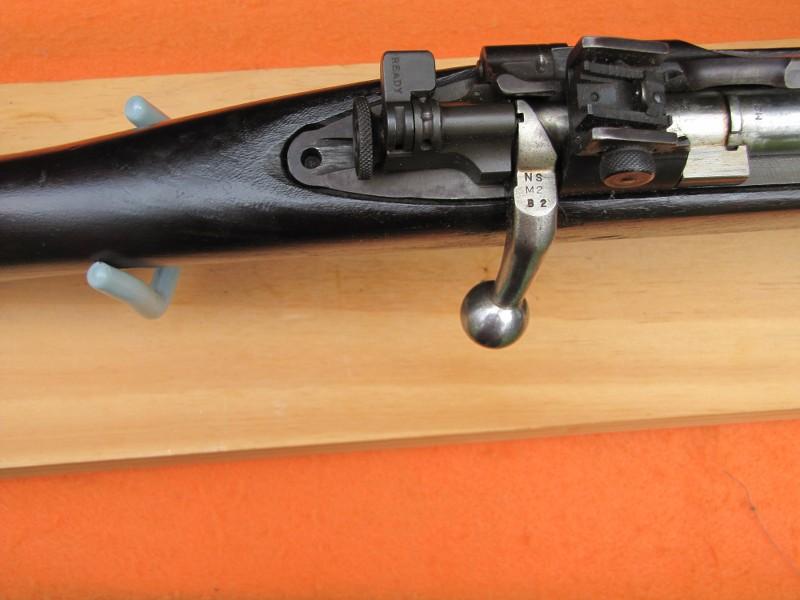

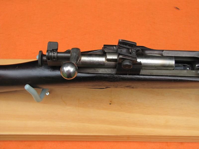

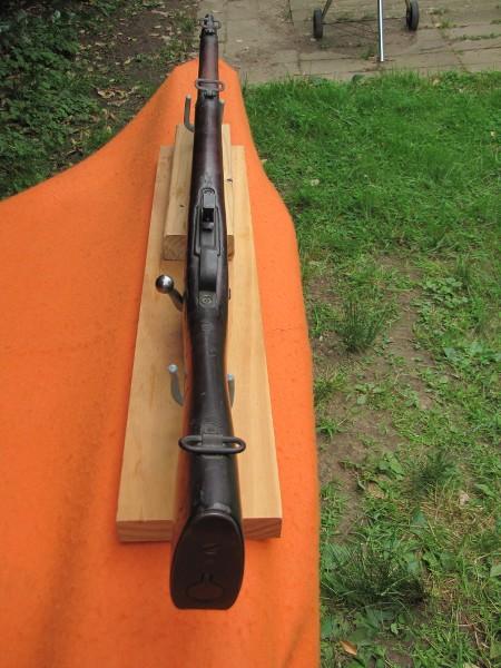

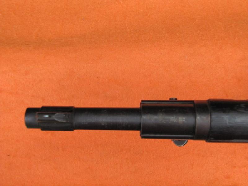

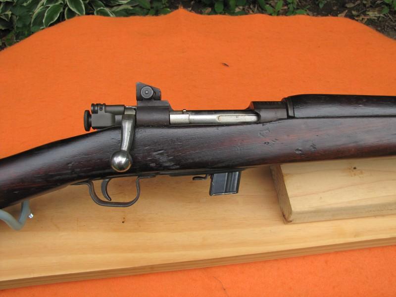

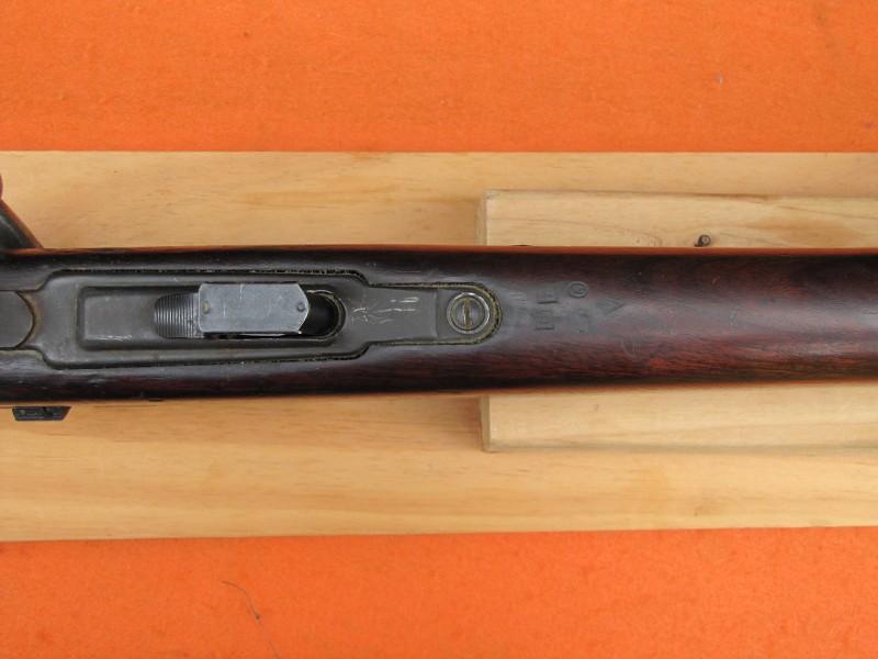

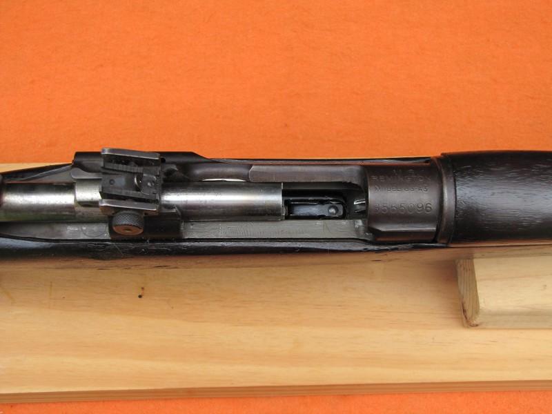

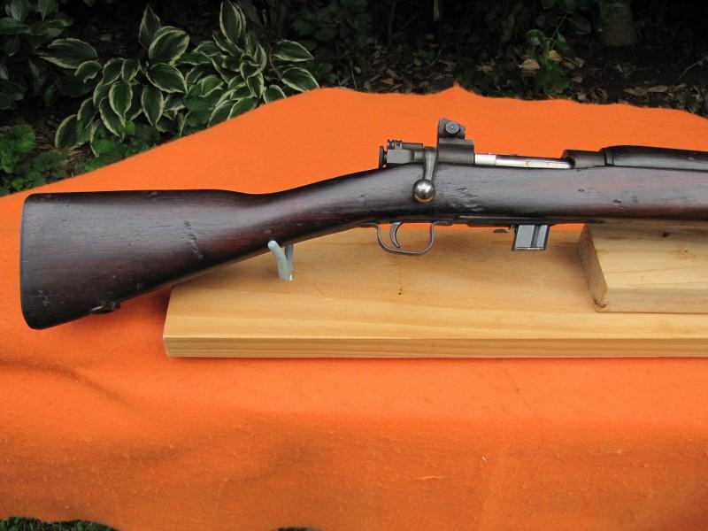

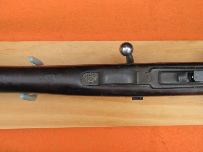

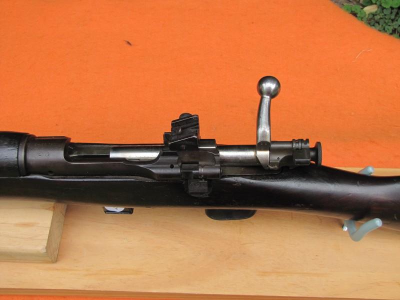

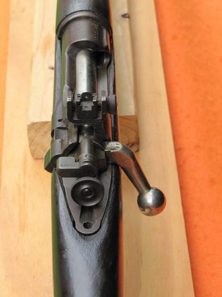

    building a 22 rim fire on an M1903
    A few years ago, I bought a well used low serial numbered (1915) Springfield 1903 barreled action from the CMPicon. The barrel was burned-out. I found a man in NC who installs full length quality 22 rim fire barrel liners on 1903 barrels, they have an extension to fit the Springfield M2 (with the headspace adjustment). I had a M2 bolt and was able to put this together, also used a Lyman 438 pre WW2 scope. Gun Parts sells a 03A3 trigger housing modified to use a magazine too.Attachment 48562Attachment 48563Attachment 48564Attachment 48565

    I have a question, what 22 rim fire magazine is used in the Numrich conversion kit ?
  9. #16
    Legacy Member flatheadsal's Avatar
    Feb 2011
    08-01-2021 @ 06:43 PM
    florida
    13
    06-03-2024
    02:41 PM
    one just sold on ebay from gunparts corp, it says Marlin 89C, 56 semi autos and fits the numrich conversion, they are probably available directly from them, flathead

    I believe the magazine would also be the one that fits the M65 Reising. With that said I would love to add one of those to my military .22 collection. That is a real prize!
