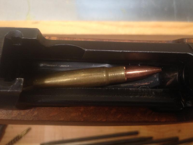

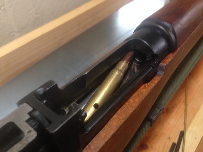

    Here are some photos of the Lee Enfield jamming.
    Rick
    Nose up on the last round
    Bolt brought forward resulting in last round jam.

    What mag follower is in there?

    It is the No 4 follower I believe, the magazine is serial numbered to the rifle.

    Feed issues No.4
    Has the mag got the front spring in it which slides down the front of the follower I think the part No. is CR42 it is a small flat thing with a short end bent over with a small hole in it that locates onto a nib at the front of the Mag but could be wrong it looks as though the follower is coming right up as the front lips are even under the front of the follower, guys can I ask a really dumb question was the floor plate a different shape for the NATO 7.62 round I am just being obtuse in a swapped follower who knows this things history do not cane me ok also the bullet profile what projie is it the same COAL as a Mk VII? I have had a few feed issues with different profiled bullets but changed the length so they fed properly.

    The magazine follower is stamped F 52 so I am guessing that it is a #4 follower made in 1952 at Fazakerly. it does have the front spring on the magazine.

    Yes, the 7.62 is a different magazine completely. The follower might not even fit in a proper #4 mag. I have seen some different ones in there though. Perhaps the front feed lip is too high and not holding the bullet until it starts up the feedway. Yes, a shorter bullet will give problems...these were made for the long bullets. The old ones were round nose but long. The later were long and very pointed.

    Cinders,
    The dummy rounds are using Hornady 174 grain FMJ bullets. I have the same problem with Privi Partisan 174 grain FMJ rounds.
