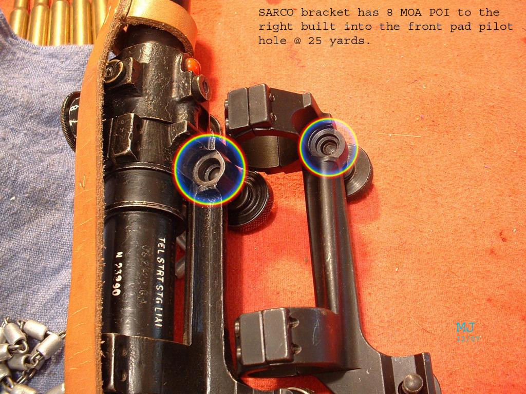

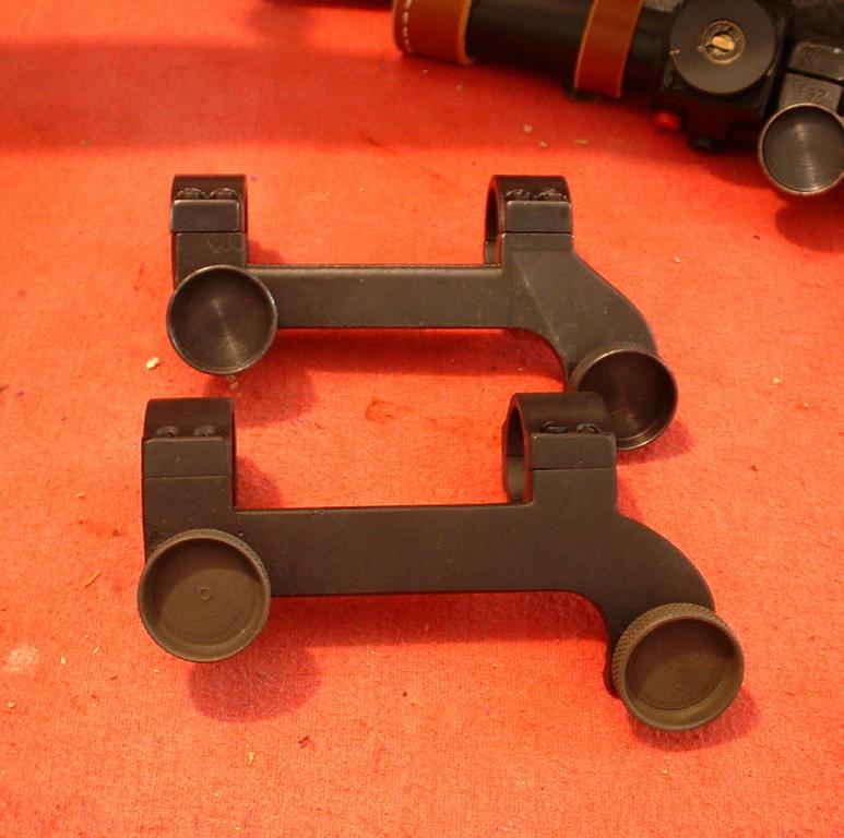

    You should try to obtain one of Roger's brackets. If that doesn't work out a careful inspection can and normally will show what needs to happen to get on target.
    It has been some time but I recall one instance having to sink the spigot hole .060" for a shooting friend who was using a BUSHNELL 1" scope
    Now I'm not an expert on anything but it made sense that the manufacture had left the fitting undone to allow the end user to fit everything to their rife set.
    Also with Roger's bracket you will be owning a bit of history in it's own right.
