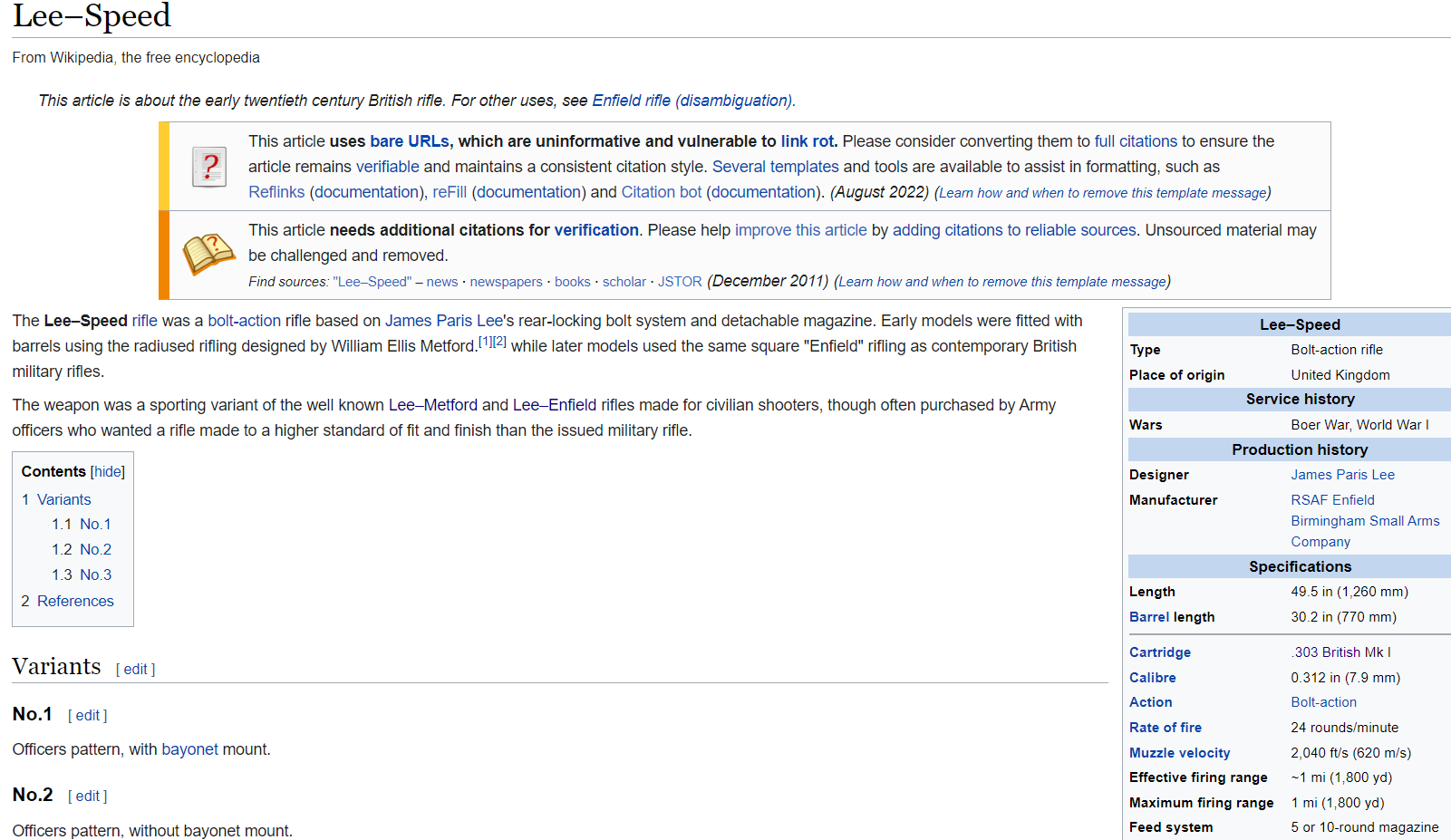

    Quote Originally Posted by waco16 View Post
    All long rifles had the bayonet lug - the clearing rods were abolished circa 1899
    You may be thinking of the Lee Metford. According to the Wiki Lee Speed post (and it may very well be wrong) there were 3 variants; 1) Offices pattern with bayonet mount; 2) Officers pattern without bayonet mount; and 3) Trade pattern.

    Lee Speed variants
