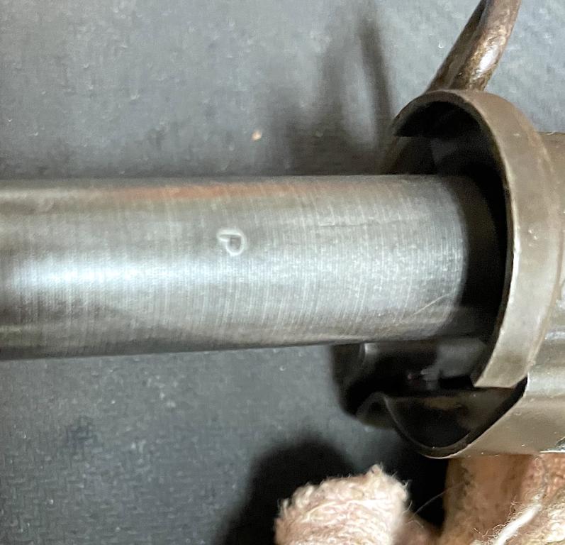

    That's because they were. I know some collectors get hung up on FIFO, but it doesn't explain every anomaly seen by today's collectors. Some guys use FIFO to justify their carbines, in this case, to be original even though it's no more than a leap of faith to think that way. If you really want to know if that barrel is original to that Inland, take the stock off and pull the slide back, then look for a slightly bare area just in front of the gas cylinder. Inland finished their carbines as a unit, so in the case of barrels, they would pull the barrel band all the way back to the gas cylinder and apply finish, this would leave a bare area (maybe a shadow is a better word) just forward of the cylinder. How wide is you bare spot or shadow if you will-that will be the answer to an original barrel on this Inland.

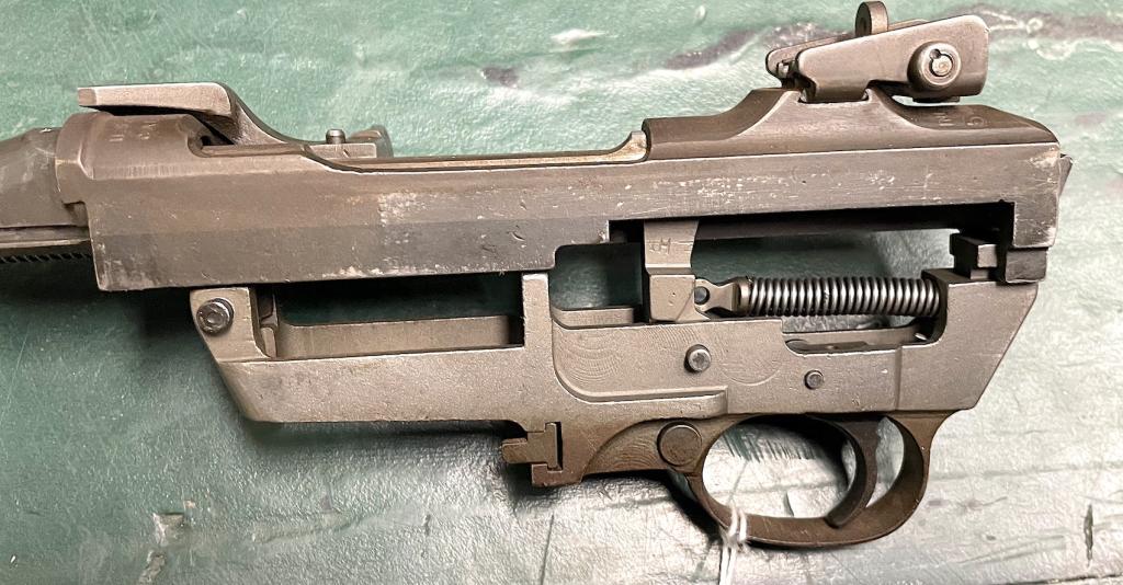

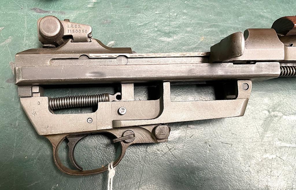

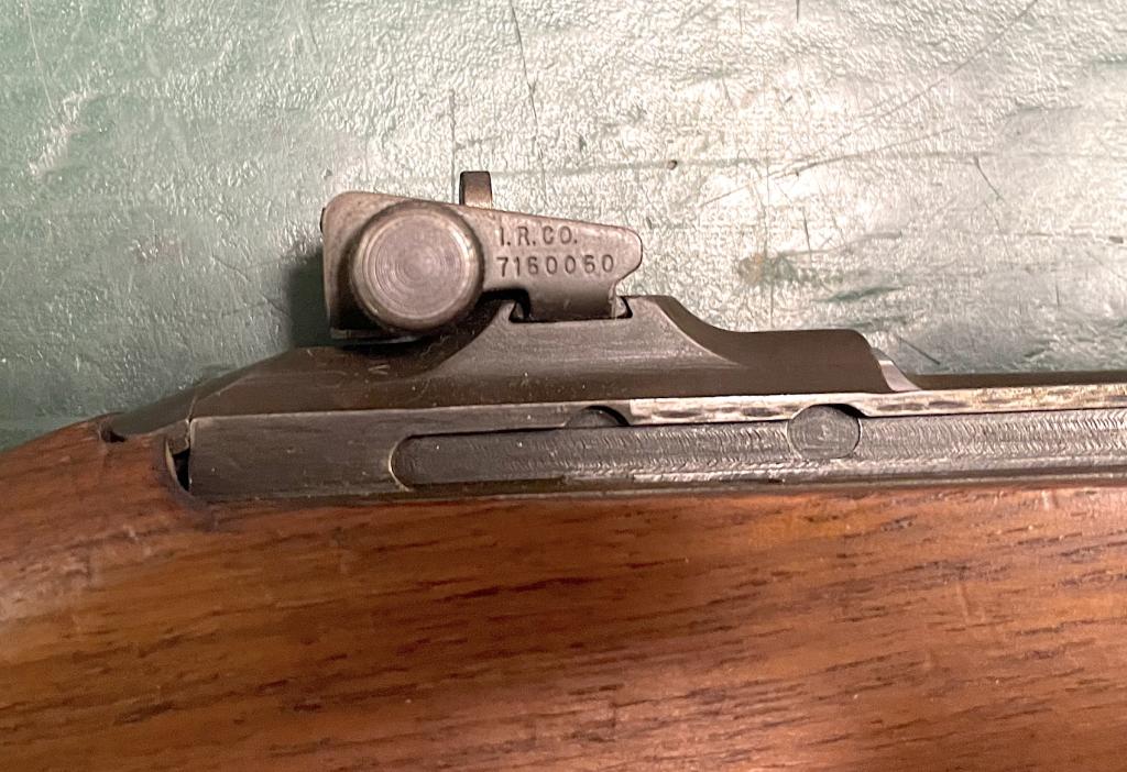

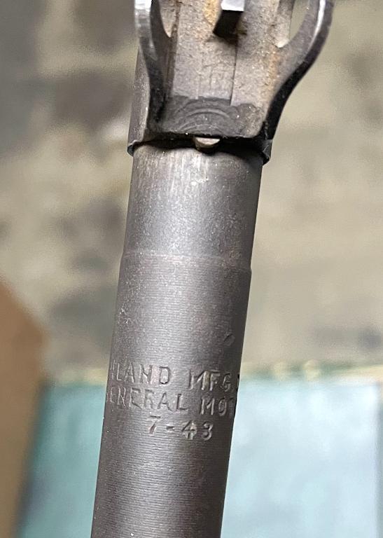

    Actually a 7-43 Inland barrel, which seems about right based on the master list on US Carbine 30 Caliber M1icon.. Any input???? It has a later type V slide, flat bolt, M2 mag catch, and a potbelly stock that seems to just have the original linseed oilicon coating that is soaked in and dry. The stock has definitely NOT been sanded. The barreled action hangs in the stock with about 1/8" clearance between barrel and channel at front. It has a Winchester trigger housing and a REALLY sweet trigger pull.

    Did you notice if that stock was an SA or an Inland? - Bob

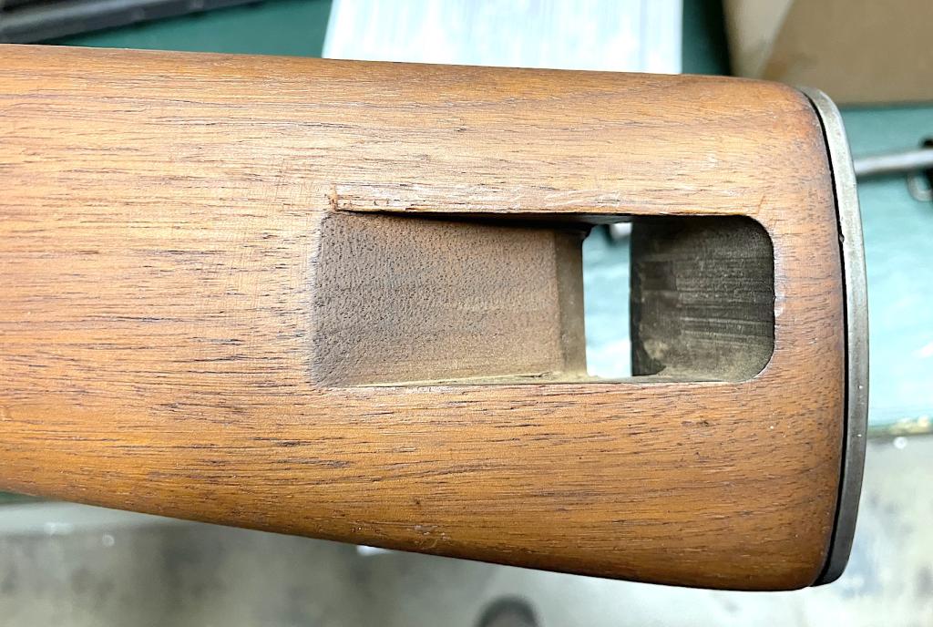

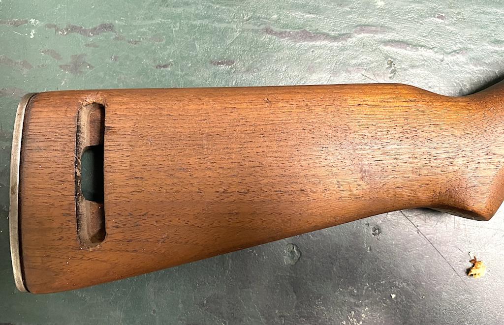

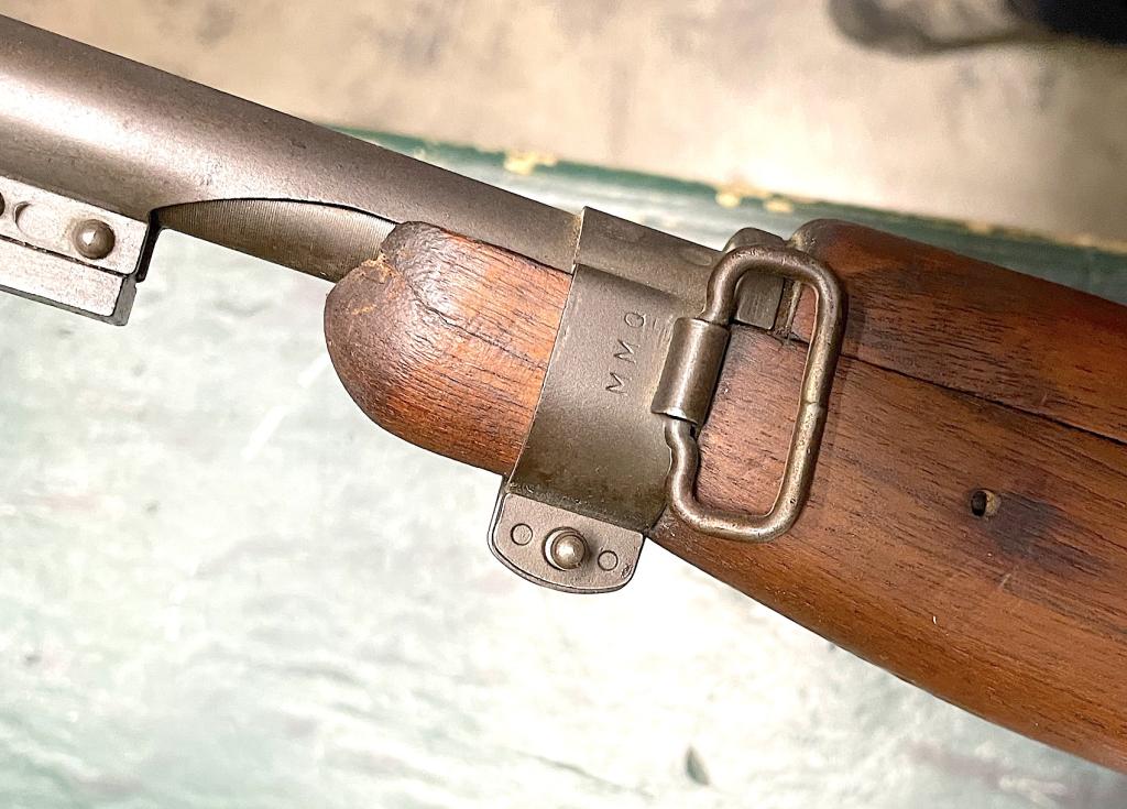

    Pics: EDITED: SA stamp on stock by barrel channel Handguard is IO IIRC.

    The stock really looks like it just has the original linseed oilicon treatment. Would this rebuild have been done in 1945 (after Germanyicon surrendered) when they were upgrading carbines to send to the Pacific for the invasion of Japanicon? Or maybe after the war?
