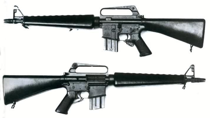

    Thanks for all the input chaps which is very interesting. It's a good idea of Jim's to get the book "The Black Rifle", thanks. I notice that there are 2 books with this title but I need the one that has "Retrospective" on the cover.
    I seem to recall hearing or seeing somewhere it suggested that the barrel was shortened on the "standard rifle" (not one of the derivatives) at some point? Would this be correct?

    As for the shortened one, it was a model 605, with a 15.5" barrel, cut off just in front of the front sight base, and threaded for a three prong flash hider. They had to open the gas port quite a bit, because there was little bullet dwell in the barrel after the gas port. Modern replicas often use a carbine length gas system with a low profile gas block, and the FSB is only for the sight. Also most people do a 16" barrel to keep from needed a tax stamp for an SBR.
