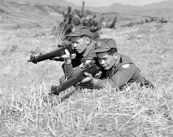

    Korea:

    Pics of my old regiment in the field...nice.

    Yep....., clearly posed, but you can't get better than that! Quite how the Lyman coped with the atrocious conditions heaven only knows. It didn't fare well in the UKicon. Mind you, the rain in the UK is what we call '...lazy rain'. It doesn't bother going round you - it just goes straight through you!
    Would be interesting to find out how many were disposed of to the European Armies. Presumably they went in chests. The Brens did, i crates marked as European Aid - or was it Marshall Aid. Anyway. Thanks Robert.

    clearly posed
    Of course...as you know a sniper can't be seen when he's afield, just ask any of them...Gil?
    The second chap's a Van Doo actually: - Veteran Stories - The Memory Project
    The Lyman Alaskan was also used by the Americans on the Garandicon in Korea. Not sure if they had any problems with them or not.
    John George used one on a Model 70 Winchester in the South Pacific without any reported issues according to his book "Shots Fired in Anger".
    It would be interesting to know what the SOP was in regard to the caps on the drums/knobs. Take the caps off on the C67 and you have knobs much like the No32 Mk3, but on the Alaskan you have to pull the rifle back from a firing position and look at the top face of the knobs to see the markings.
    I wouldn't be surprised if the snipers often held over for range rather than removing the caps and adjusting the drums/knobs. By that I mean when they got into a position where the general range of the enemy was known, they could set to that range and then just hold over for individual shots a bit below or above that setting. Targets of opportunity would perhaps make that more or less obligatory anyway, since their time of exposure would be often be so short that ranging and adjusting settings would be impossible.
