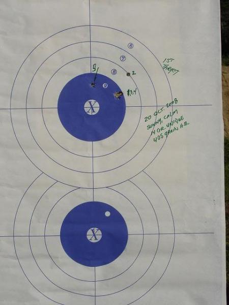

    these are the targets I use. I shoot a relay, rotate the target 180° and then shoot another relay
    the bulls are 12" apart

    Thanks Mark,Nice targets,where did you get them? What type are they?ie-200yd large bore? Lee W.
