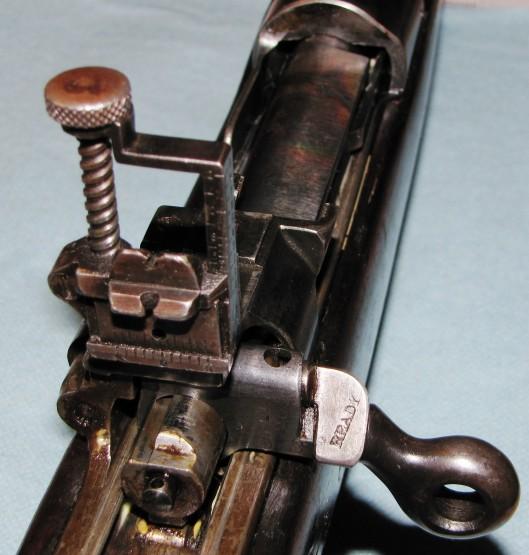

    I have acquired a Canadianicon (?) 22 cal trainer built on an old (7XXX s.n.) #3 BSA. It has a globe type front sight and a rear sight I can't identify. I don't know from SMLE's; the only other one I have is a .308 Ishapore. Any ID info greatly appreciated.

    That is the rear sight from a Mk 3 Ross rifle.

    It's a Cooey Sight for the .22 training rifle.
    On the right side vertical arm you should see HWC in an Oval.
    There were two sights fitted to the original Canadianicon trainers, the other was the BSA/PARKER fitted to a Tippens folding side mount.
