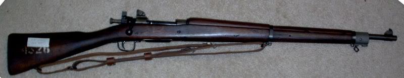

    This one of the 03A3's that I did. I know you can't see much detail. The barrel is a 98-cent DCM two-groove, the stock I think came from Numerich.
