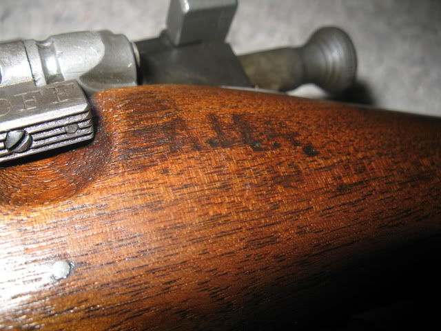

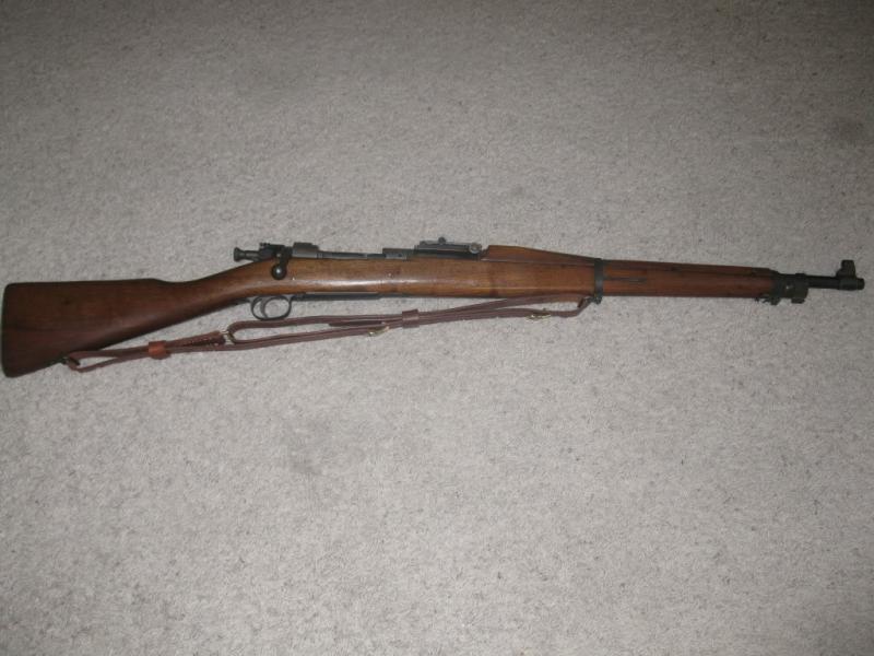

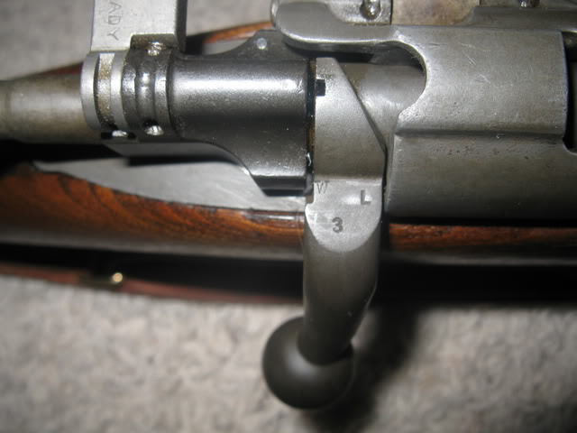

    I just got a 1903 and have some questions. The rifle is Springfield serial 948xxx with a SA '42 barrel. It looks real clean and nice but I have some concerns- the stock has no noticable marks (except what's pictured below) and the bolt has markings that I can not find info on. Those markings are also pictured below. Also, it has a silver colored butt plate that is checkered which I think is not correct- am I right? The bayonet lug has a "H", is that good or bad? Any help / opinions would be appreciated. Thanks

    The receiver is from 1918; the barrel and stock are replacements from World War II (the stock was originally made for a late Remington M1903 or a early Remington or SC M1903A3. The bolt body is from about 1920. It appears that at least the lower band and safety are replacements, as well. The rifle has been refinished. Pretty typical for a WWII overhaul.

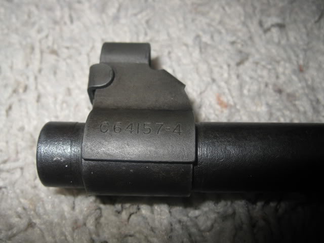

    Any markings on the front sight protector? Hole in left front of receiver?
    Marking on the left side stock is probably an arsenal or inspector's stamp. I'll look it up.

    A fellow named ViShooter has an excellent reference website, http://www.vishooter.net/m1903.html where you can find out lot's of info about your rifle. John Beardicon posts his bolt heat lot info there as well, where you can date your WL 3 bolt. The WL 3 bolts were used from 1921 into 1928, a bit late for your 1918 receiver.

    The books I have say A.H.A. inspector mark is unknown.

    Wow, thanks for all the responses! I'll post some more pictures of the things requested, anything to help you all help me! I guess I didn't take a picture or it but there is a hole in the receiver on the left side near the front. I figured the lower band did not belong but thanks for the info about the safety and the stock markings.
    Butt Plate
    Sight Hood

    I figured Augusta Arsenal, but Mike has better eyes than me. Nice rifle.

    Sight hood is also from WWII.
