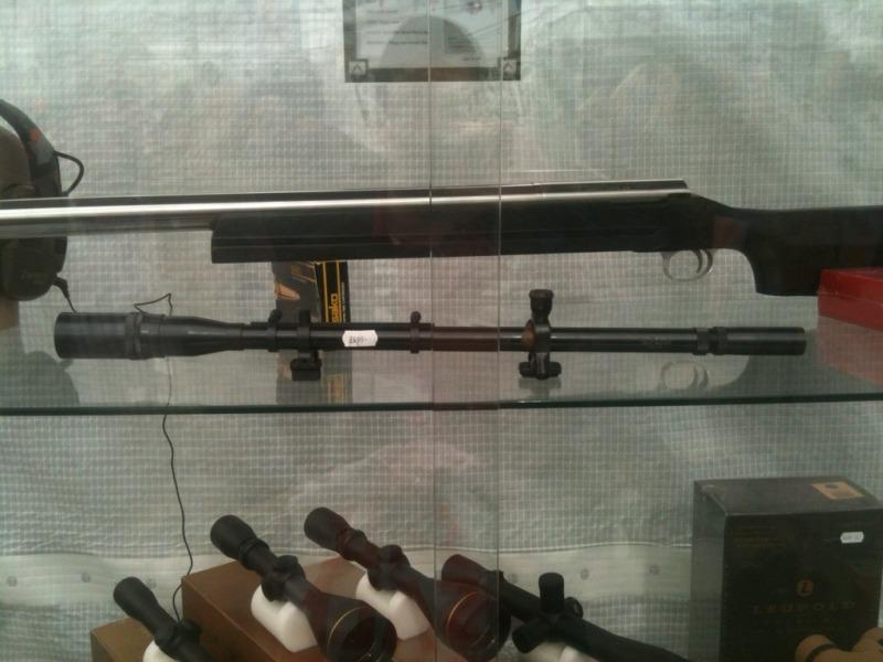

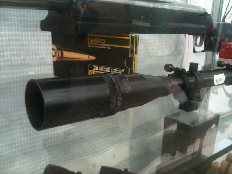

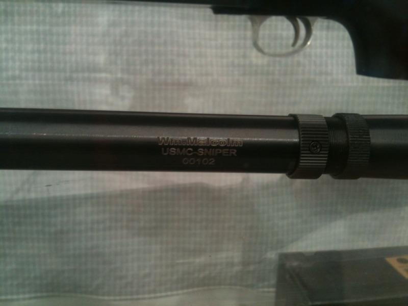

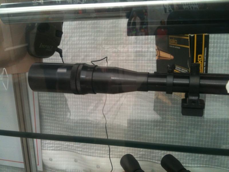

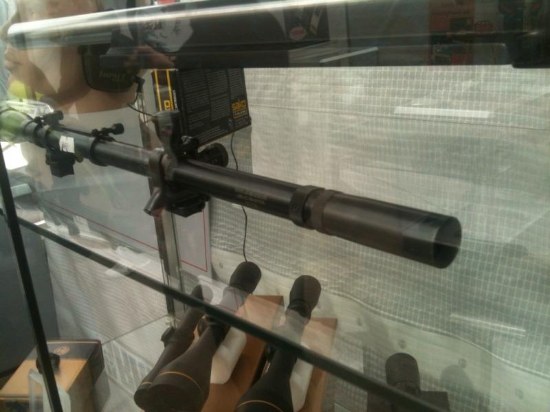

    I don't know if this will help, but here are some actual photos I took of a W. M. Malcolm Unertl scope that was on display at the Britishicon Shooting Show a few weeks ago:
    (Sorry about the quality, photos were taken with an iPhone).
    The specifications page on the Hi-Lux website states that the objective aperture is 31mm diameter (1.22 inches) with an overall length of 23 inches.
    From what I have read, an 8x Unertl scope should have a 1.25 inches diameter objective aperture (31.75mm) and should be 25 inches in length?
    So this would mean that the W. M. Malcolm scope is 0.75mm smaller in objective aperture size, and 2 inches shorter overall?
    Paul.
