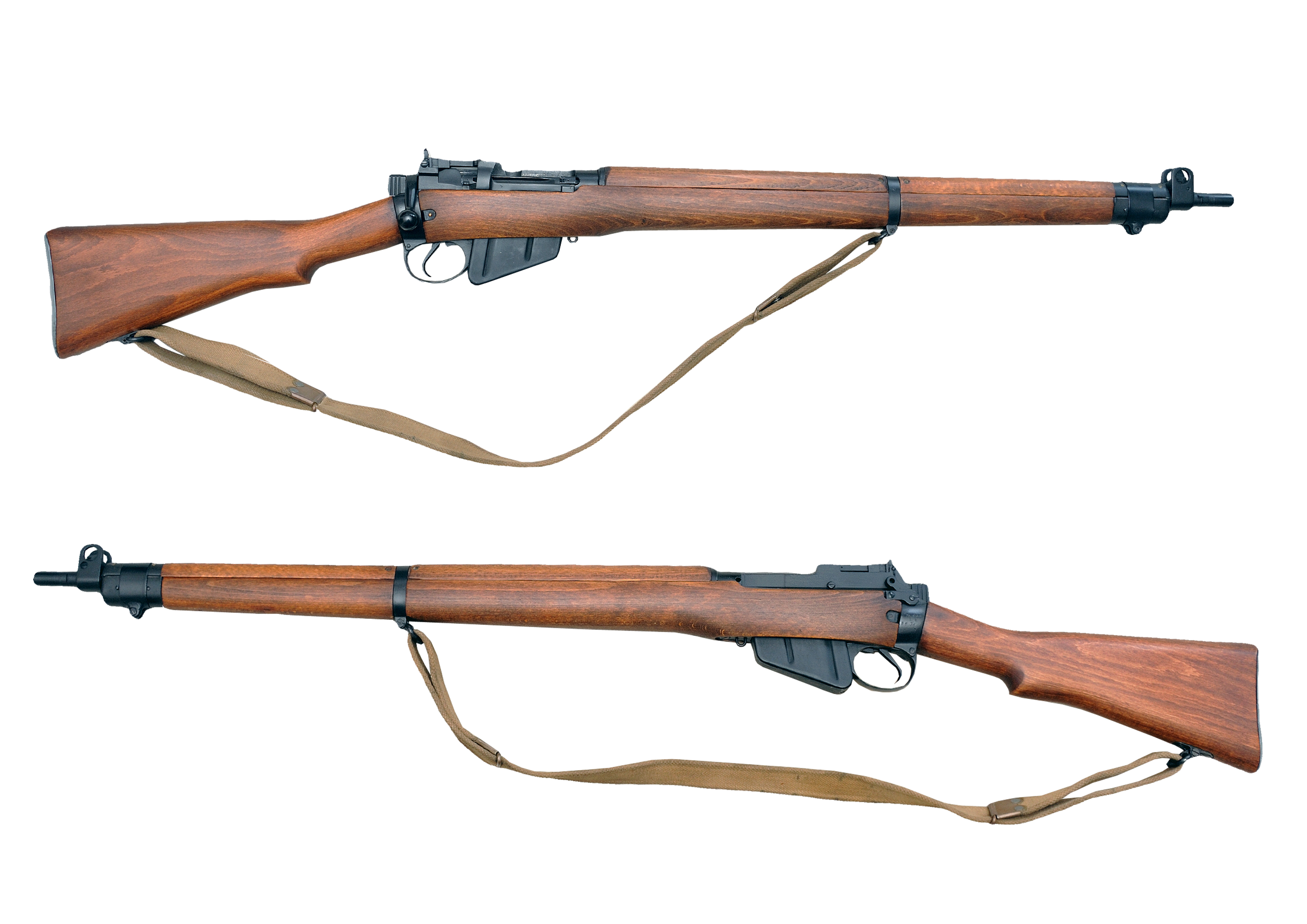

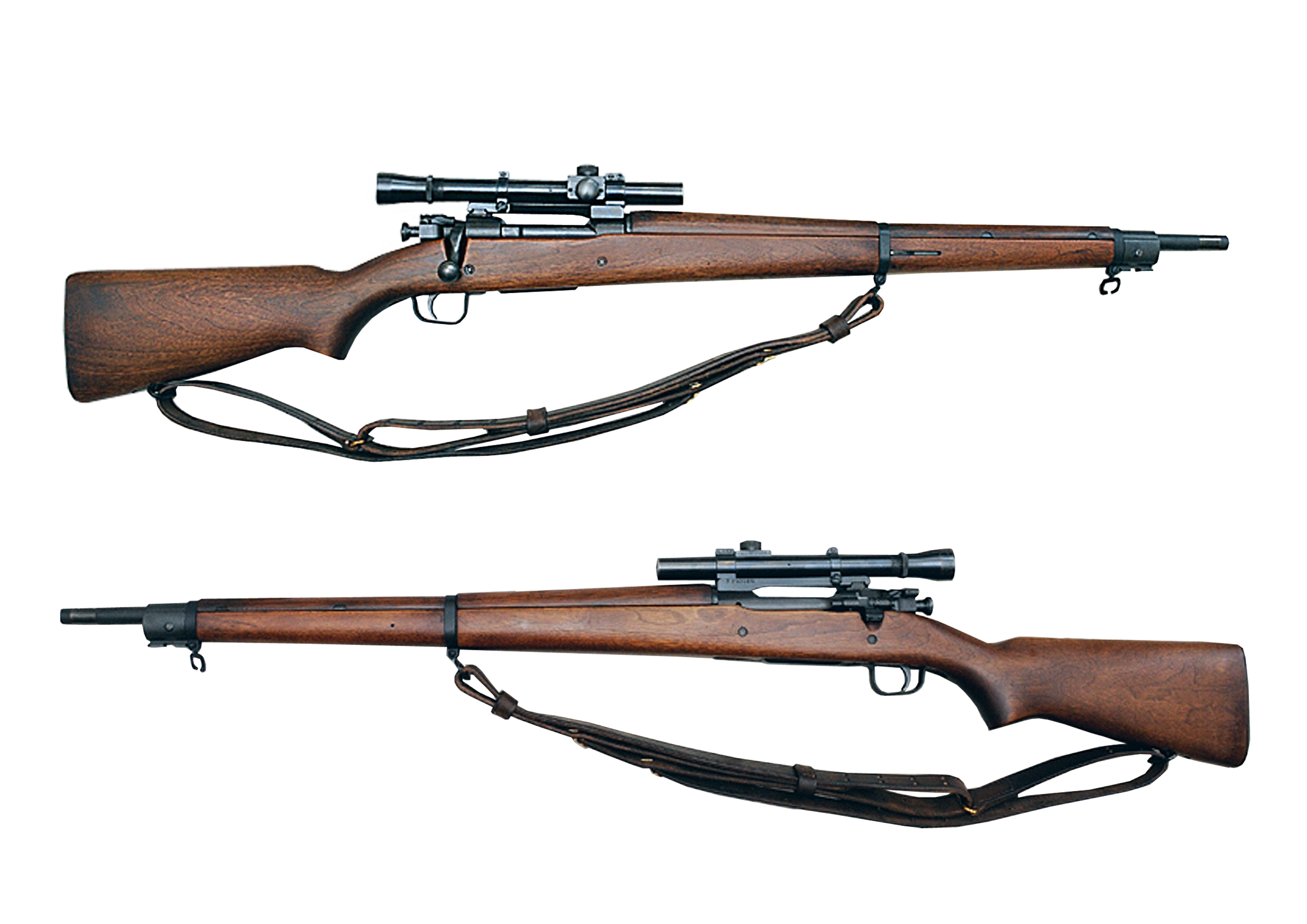

    My system after wood prep and colour, is a few coats of warmed and Terps 50/50 thinned RLO, that really gives the initial penetration and depth of finish into the wood and sets it up for the following neat coats of oil ... Then keep on trucking until it stops going in....
    Two of mine using this system, my A4 build I fitted NOS Keystone stock to and my Maltby No4 build, also fitted with new NOS woodwork.
