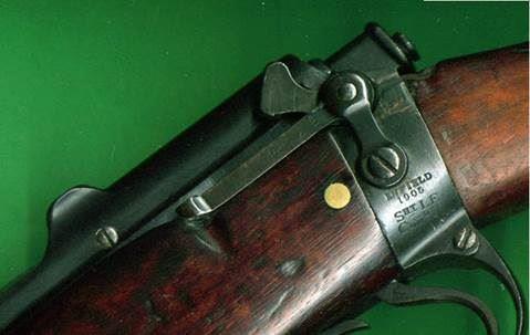

Left-side view of buttsocket, also seen, the volley sight iris.

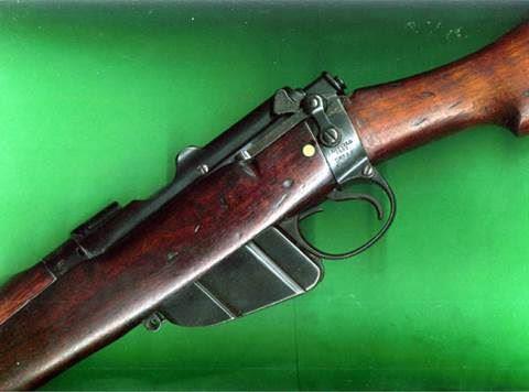

Right-side view of the receiver.

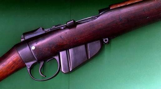

Left-side view of receiver.

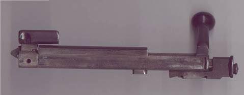

Bolthead mounted charger guide. Face of bolthead with charger guide.

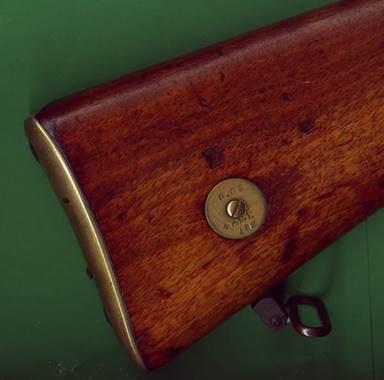

Butt showing unit disc, D/|\ (Australian government ownership stamping). Early type sling swivel.
A.G. Parker of Birmingham stamp along with the .22 Patt 14 No1 stamping on the right side of the buttsocket.

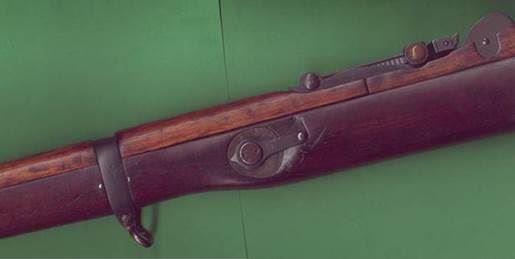

A clear picture illustrating the long range dial and pointer. Notice the early style sling swivel screws (solid, not hollow like the SMLE), also the position of the rear sight guard ears.

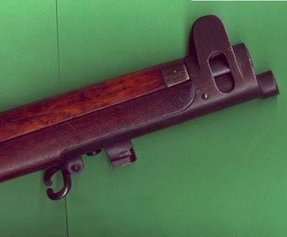

The nose cap and piling swivel.

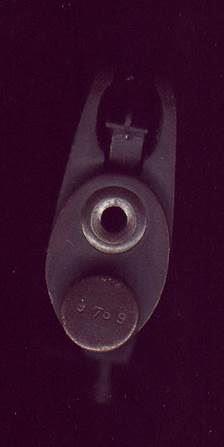

The muzzle showing the pressed & fitted .22 caliber sleeve.

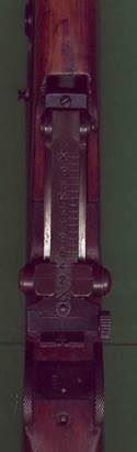

Close-up of the rear sight. Note the 25-yard marker on the right side of range bar.
