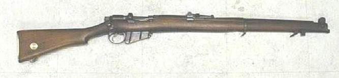

The No2 MkIV* Rifle
The No2 MkIV*, 22 caliber training rifle was made to simulate the exact weight of it's big brother the No1 MkIII*. All outer appearances and mechanical operations were the same as for the .303 version, the exception being that as a .22 this rifle was a single shot. The magazine was merely a shell, which excluded the follower and spring; its purpose was to catch the extracted cases after firing. These rifles were made/converted from worn out .303's. The conversion consisted, more or less, of changing the bolthead to accommodate a rimfire striker and extractor, removing the magazine follower and spring. Removing the magazine cut-off (if present) and fitting a new .22 caliber barrel. Lastly, re-marking it as a No2 MkIV*.

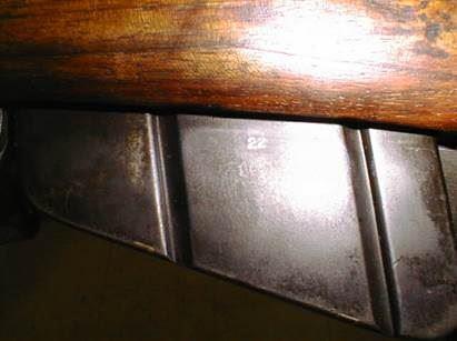

Visible on the left side of the magazine is the 22 stamp. To distinguish it, while off the rifle, as being a 22 trainer mag. So the Company Quartermaster Sergeant (CQMS) didn't have a fit, when he noticed it was missing the follower and spring.

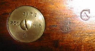

A good example of a Butt Disc, being a bit cryptic they were not the easiest things to de-cipher. This one appears to suggest a Taken-On-Strength (TOS) date of Jan 1931, 2nd Regiment Royal Artillery and perhaps a stores rack number 750. Also seen clearly in this photo are two Canadian C Broad Arrow stamps indicating Canadian government ownership. Which leads me to question the Royal Artillery Unit Disc.

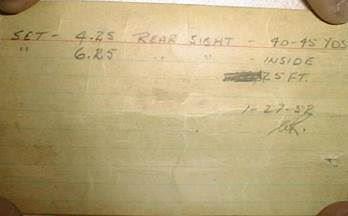

Pictured is the armourer's sight adjusting notes I found in the butt trap. It gives the rear sight settings for firing at 40-45 yards and at 25 feet. Dated 27 January 1952 and signed.
