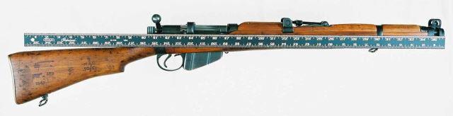

This last image illustrates the Bulldog's shortened length, approx. 37-1/2 inches overall. A full size No1 MkIII* will measure in at 44-1/2 inches.

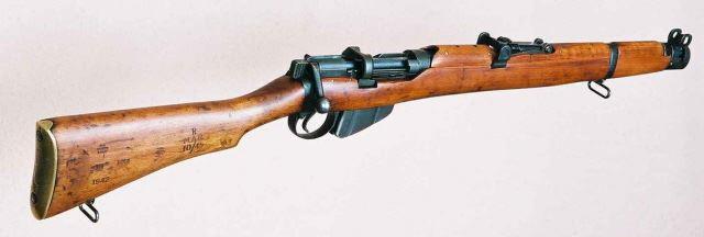

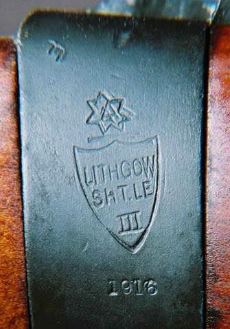

Here is a very clear shot of the Lithgow Small Arms plant marking and the manufacture date 1916.

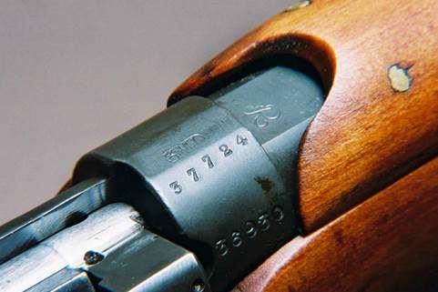

This image of the receiver/knox form really shows the refinishing of both the wood and the metal. Seen as well are some more stampings, 3MD (3rd Military District Australia) and the stylized R indicating that the bore was found to be rusty by an armourer.

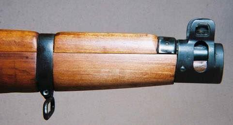

Several things stand out in this image, firstly the absence of the bayonet lug and boss on the nose cap, as well the slight cant of the nose cap and finally the grain of the wood on the fore-end. Notice either side of the stock band, the wood grain doesn't match. The fore-end would have been cut under the stock band in order to shorten it to accommodate the cut and shortened barrel.

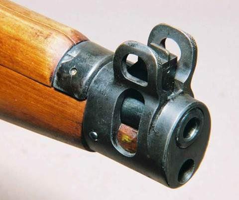

This image shows again the modified nose cap. A hole where the bayonet boss was machined off. The handguard also has a cut mark along its length.
