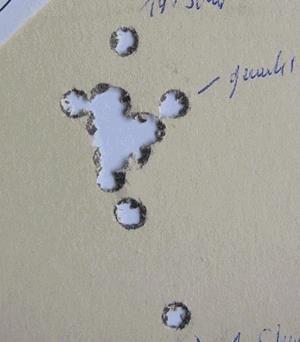

Group1 (10 Shots)
Shows the starting point with 17grs Viht N110. The action was Epoxy bedded like you explain it on your Stock Bedding Page.

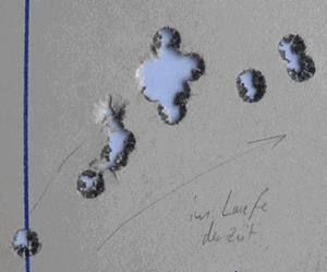

Group2 (10 Shots)
Shows the results after adding the center bearing with 10-lbs. upward pressure at 5 inches from the action.

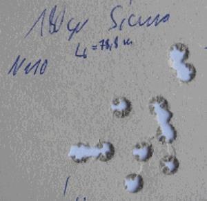

Group 3 (10 shots)

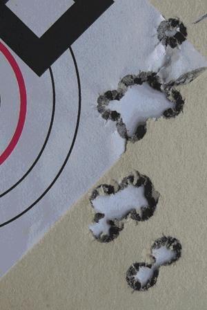

Group 4 (10 shots)
Shows the results after I had removed as much wood as possible between the center bearing and the action screw. This was replaced by Brownell's Acra Glas (red). So I tried to make the forestock stronger and more temperature insensitive. As you can see, the rifle was now very accurate but "double grouping" - no longer drifting! Group 3 were first 2 groups like Group 4. The last shots just landed between the groups.

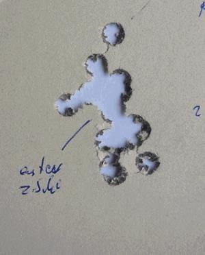

Group 5 (20 shots)
Shows the final results. I opened up the center bearing slightly with fine sandpaper, so that the barrel is just able to move better in the bearing. I hope that the size of the groups is easy to estimate by the size of the bullet holes.
