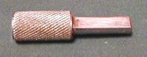

Nice, mag mandrell for FN mags. L1, C1 or SLR...I guess would be correct. I forgot about you having the most extensive collection of FN stuff known...

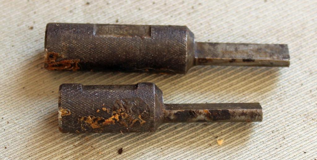

No scale again. Gas block/cylinder reamer/cleaner?

The biggest one is 2 inches long
Ours looked like this one except I think the bottom had a square block to grab in the vise. I find it almost unbelievable that this one was made by a tradesman but stranger things. Our armorers had to make many of their tools, the most common was the butt spring tool for the FN...I'm sure you guys remember.

Meat tenderizer for the post-exercise barbecue? :beerchug:
The two 'baby' gauges are:
Gauge, Hinge Pin Hole (‘NO GO’)
Gauge, Trigger Mechanism Hinge Pin Hole (‘NO GO’)
These are the Mk. 1 gauges, the design was changed as there is an inherent fault with the design. They are designed to provide a 'NO GO' gauge for the Gas Block, Gas Plug Hole and the Hinge Pin Hole.

These are the Mk. 2 versions, both sets of gauges were to be made by the Armourers. Ohhh they are shown in the Australian EMEI, not the EMER

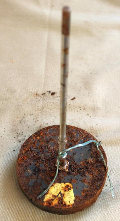

Now for something I'm not sure about. At one stage it did have a tag, but that's long gone.
Armourers, put your thinking caps on........ this is as it seems, a 1 inch block of steel with a SLR gas piston welded into a hole in the base. Its a full length Gas Piston. What could this be used for in a Base Workshop ......... it might not of even been used with L1A1 rifles. Any and all ideas welcomed.
https://www.milsurps.com/images/impo.../uo0YvqF-1.jpg
Quoits at smoko?:)
