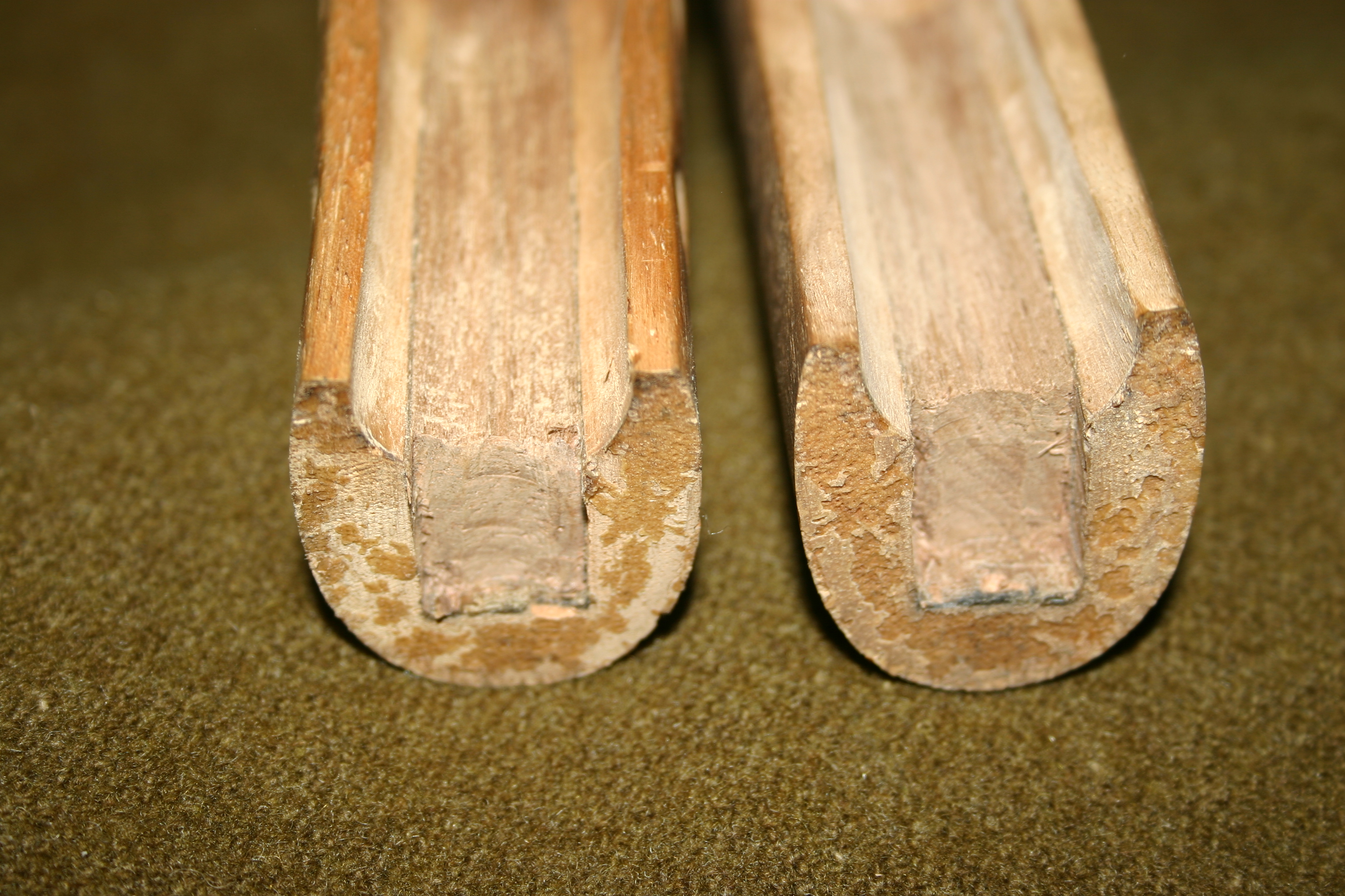

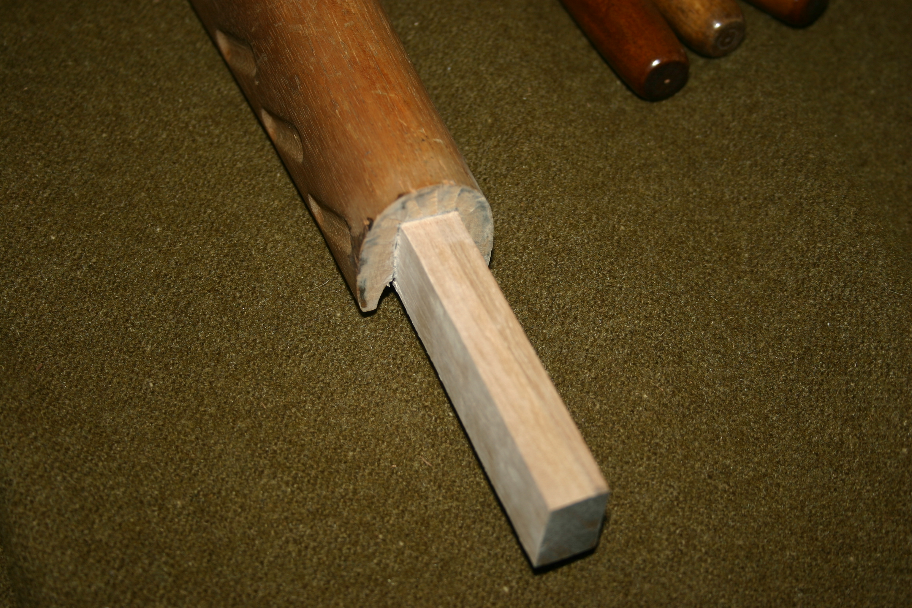

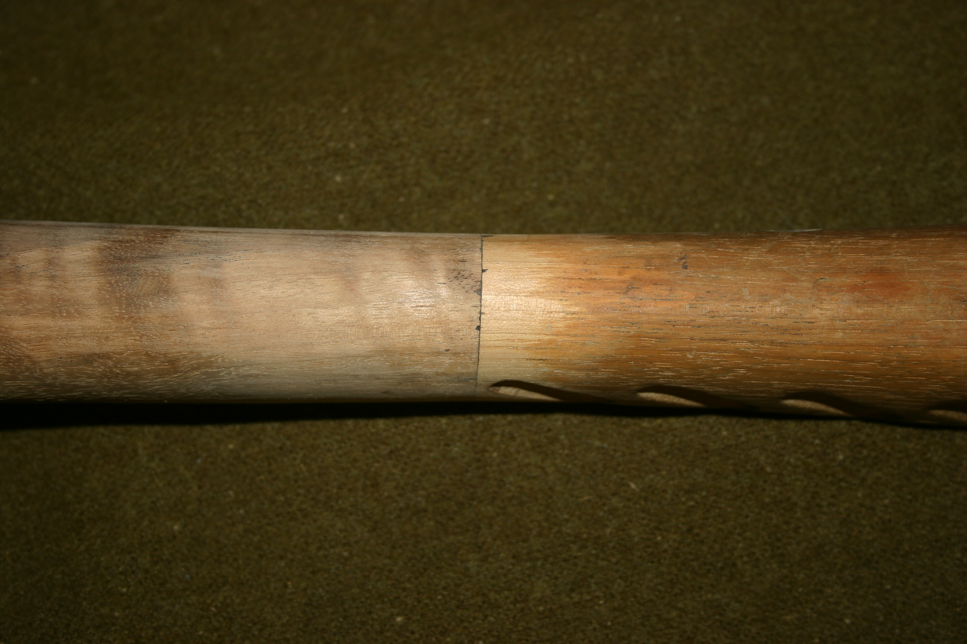

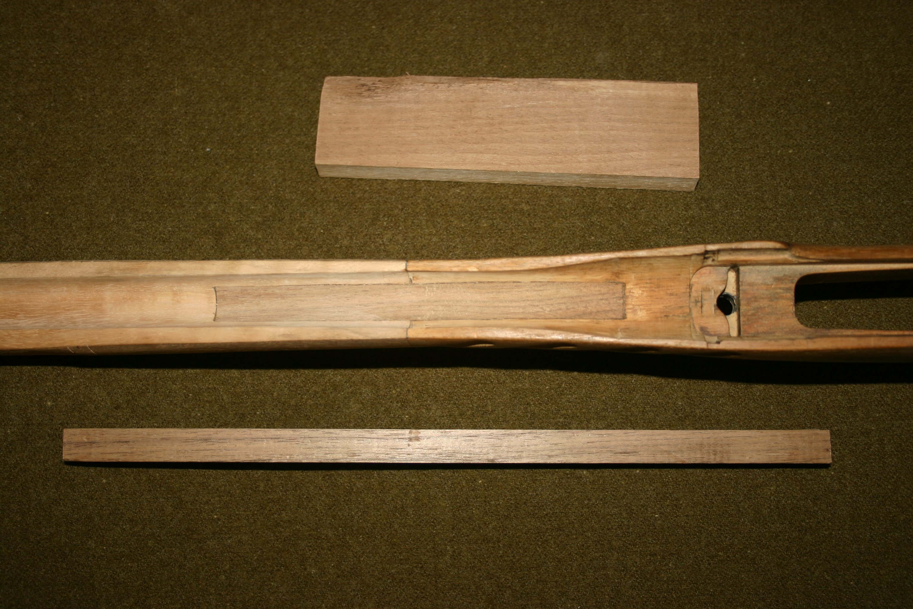

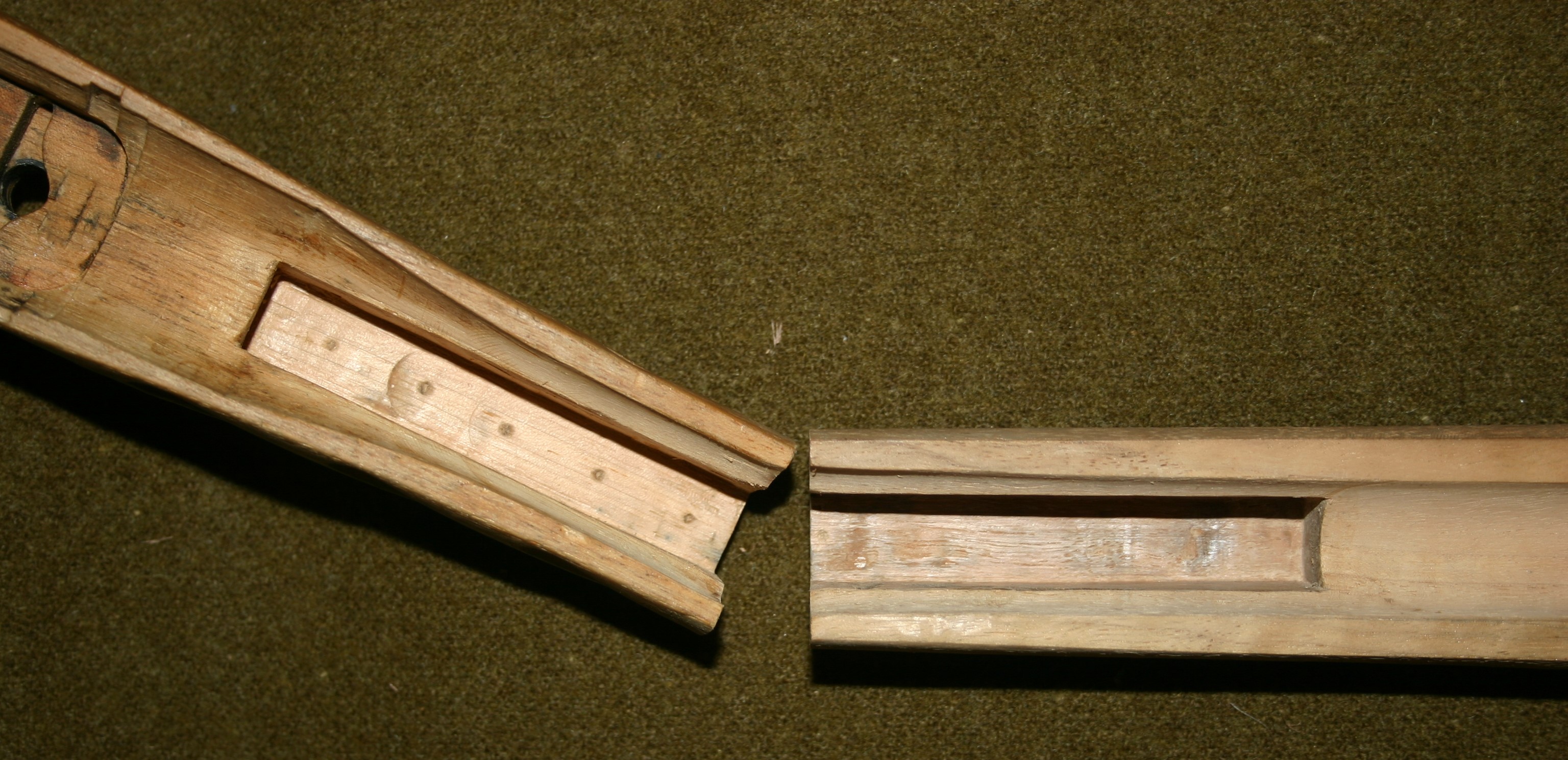

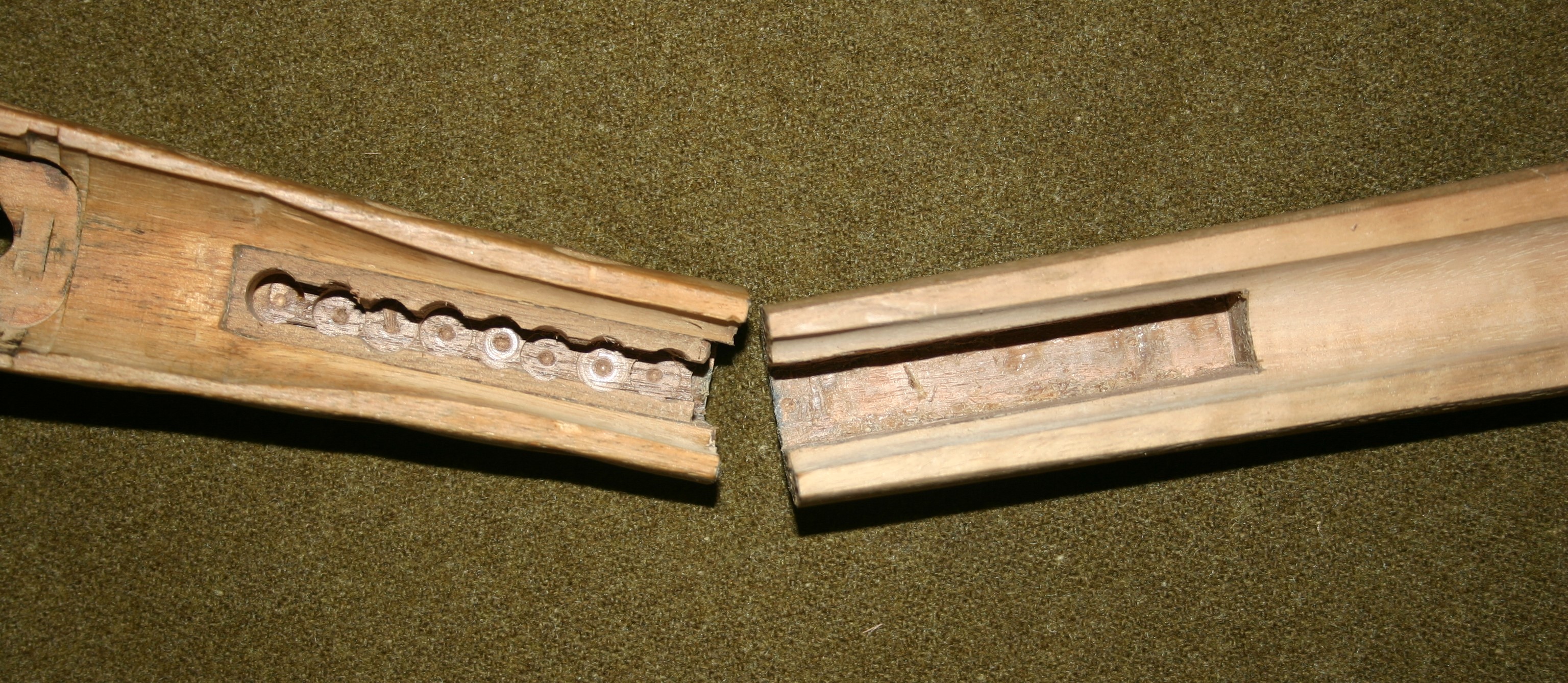

Well my doubts about how solid the splice and the glue were have been relieved....
It took me 4-5 hours to remove the dowel holding the splice in place.
So i guess it was solid.
The two parts are now cleaned and ready to start over again.
Attachment 123685Attachment 123686Attachment 123687Attachment 123688Attachment 123689

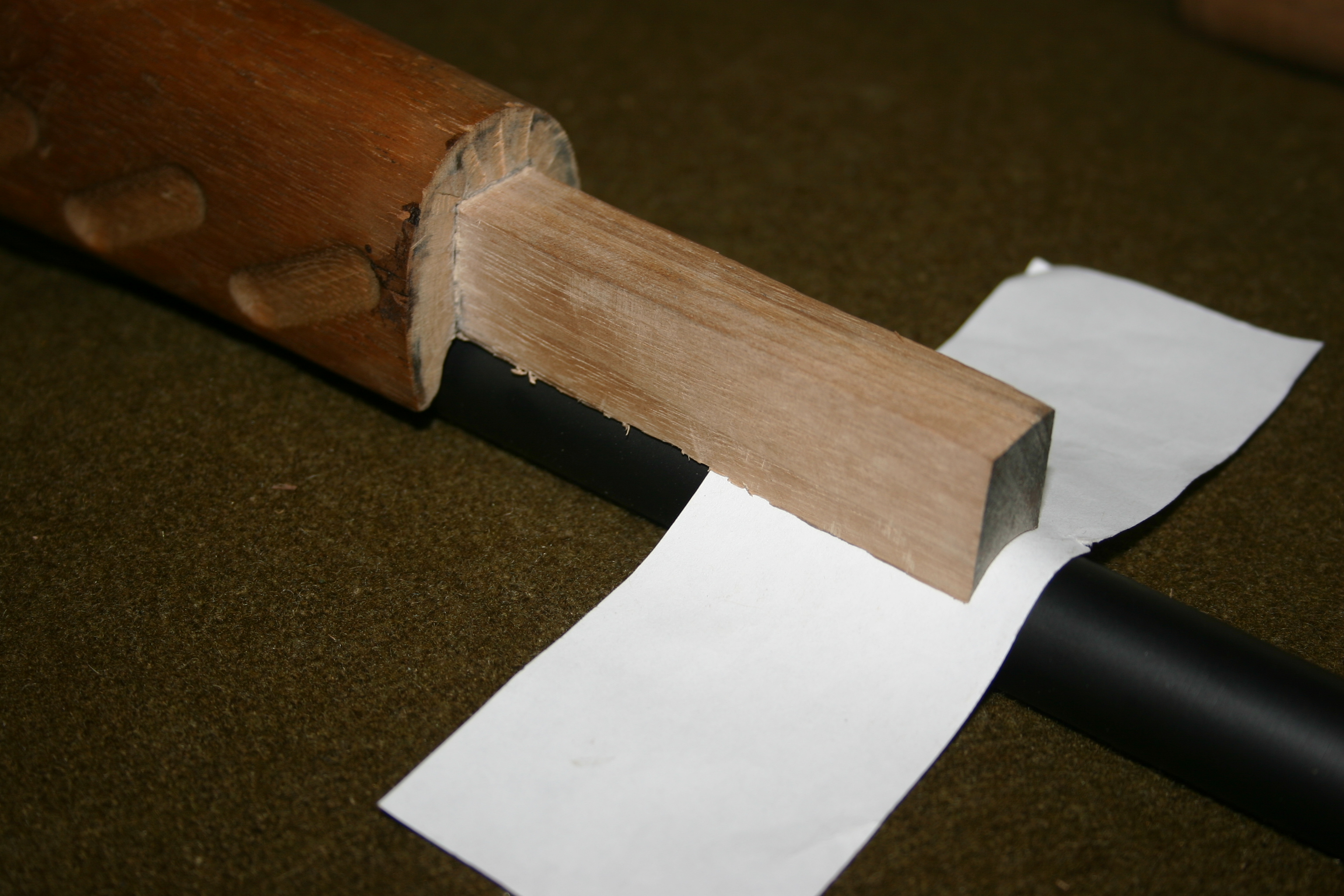

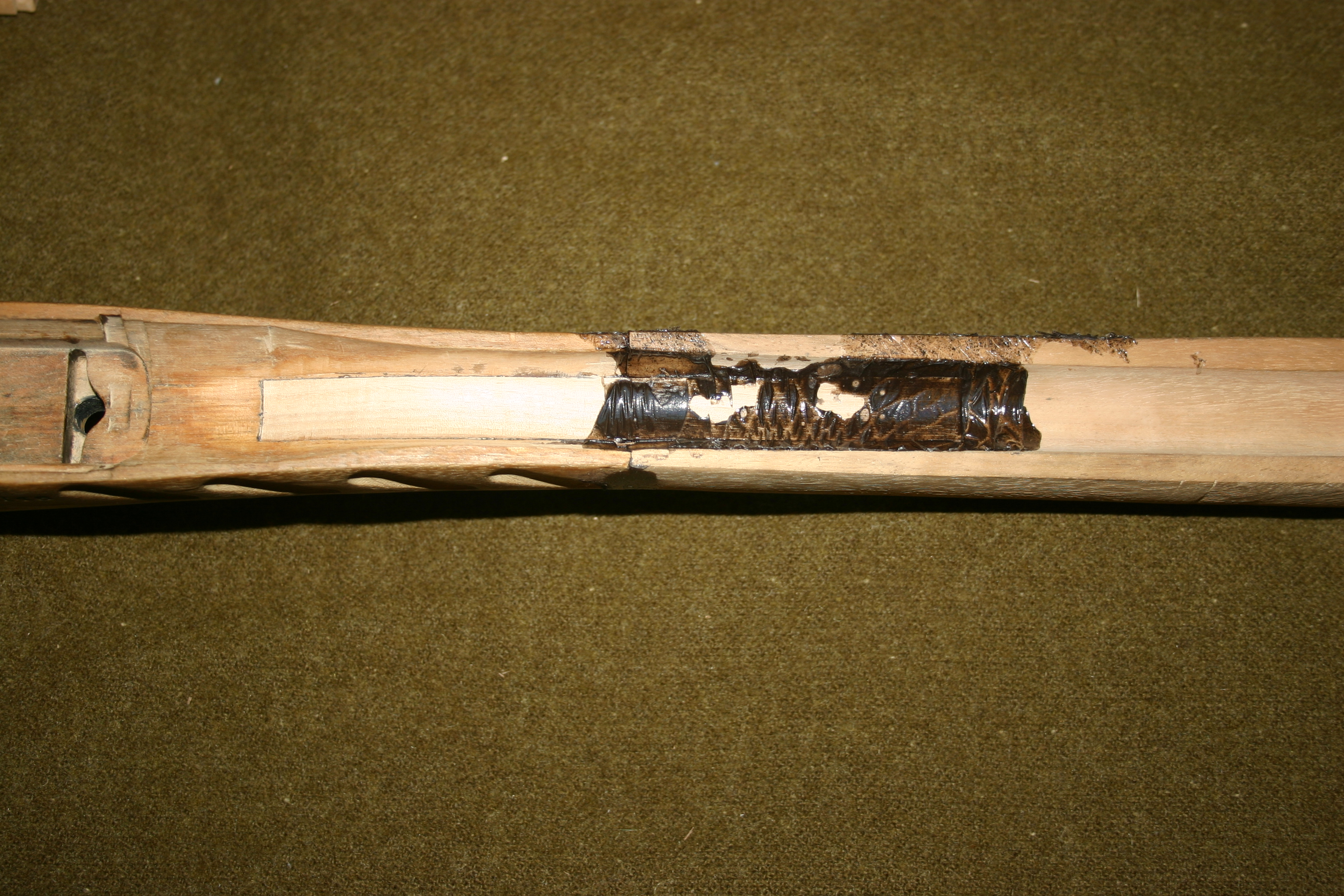

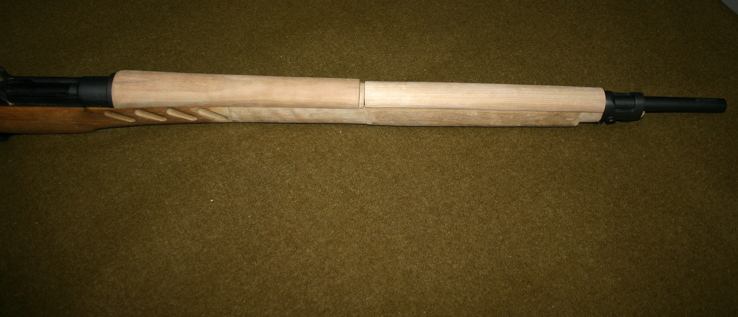

Got a bit more done.
In these pictures i glued a new dowel in the fore end and mated both sections.
The dowel also had to be shaped to the barrel channel so the barrel wouldn't touch the wood.
The numbers of hours to fit everything nicely equal to a good day of work...
Attachment 123769Attachment 123770Attachment 123771Attachment 123772

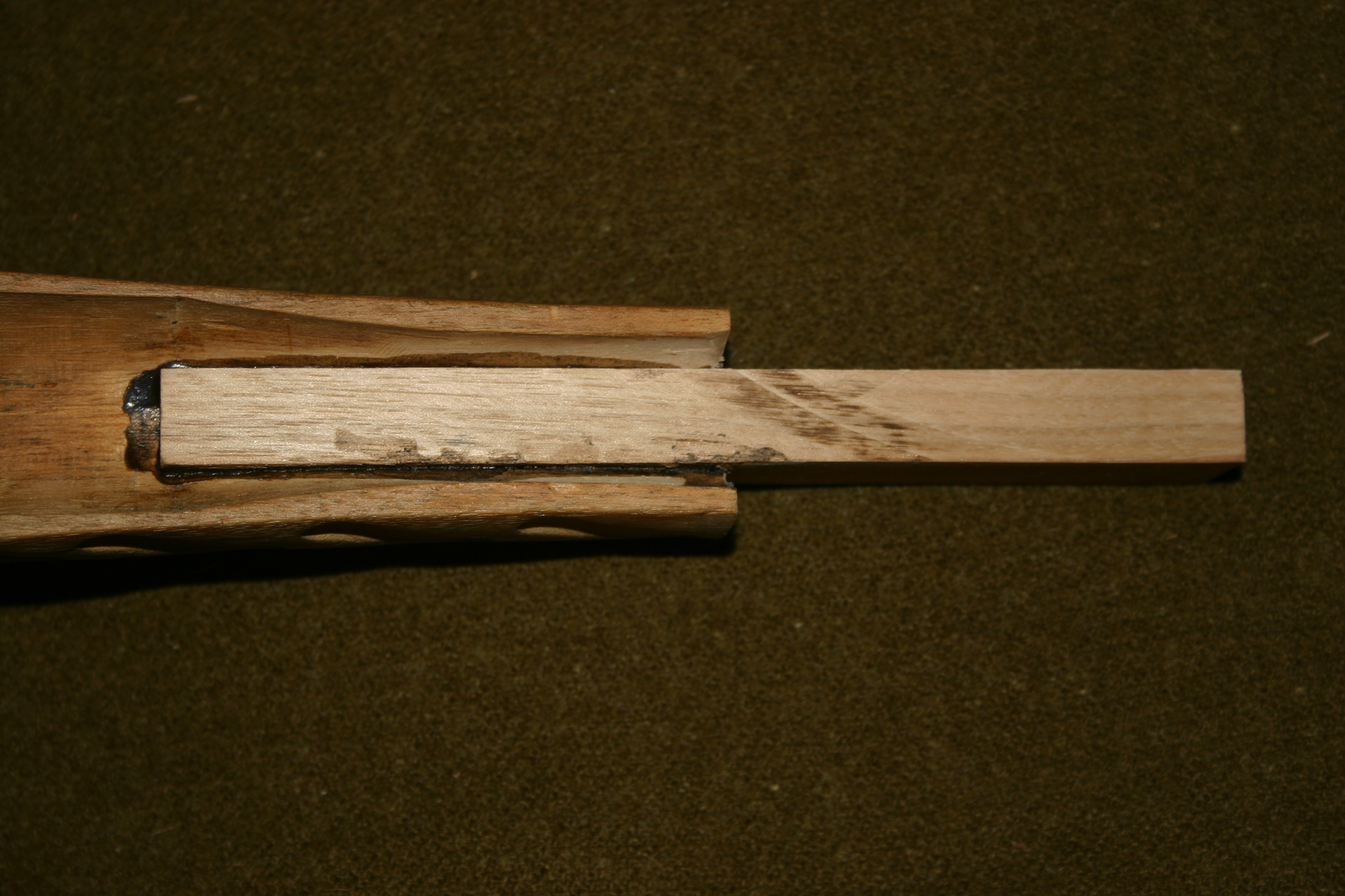

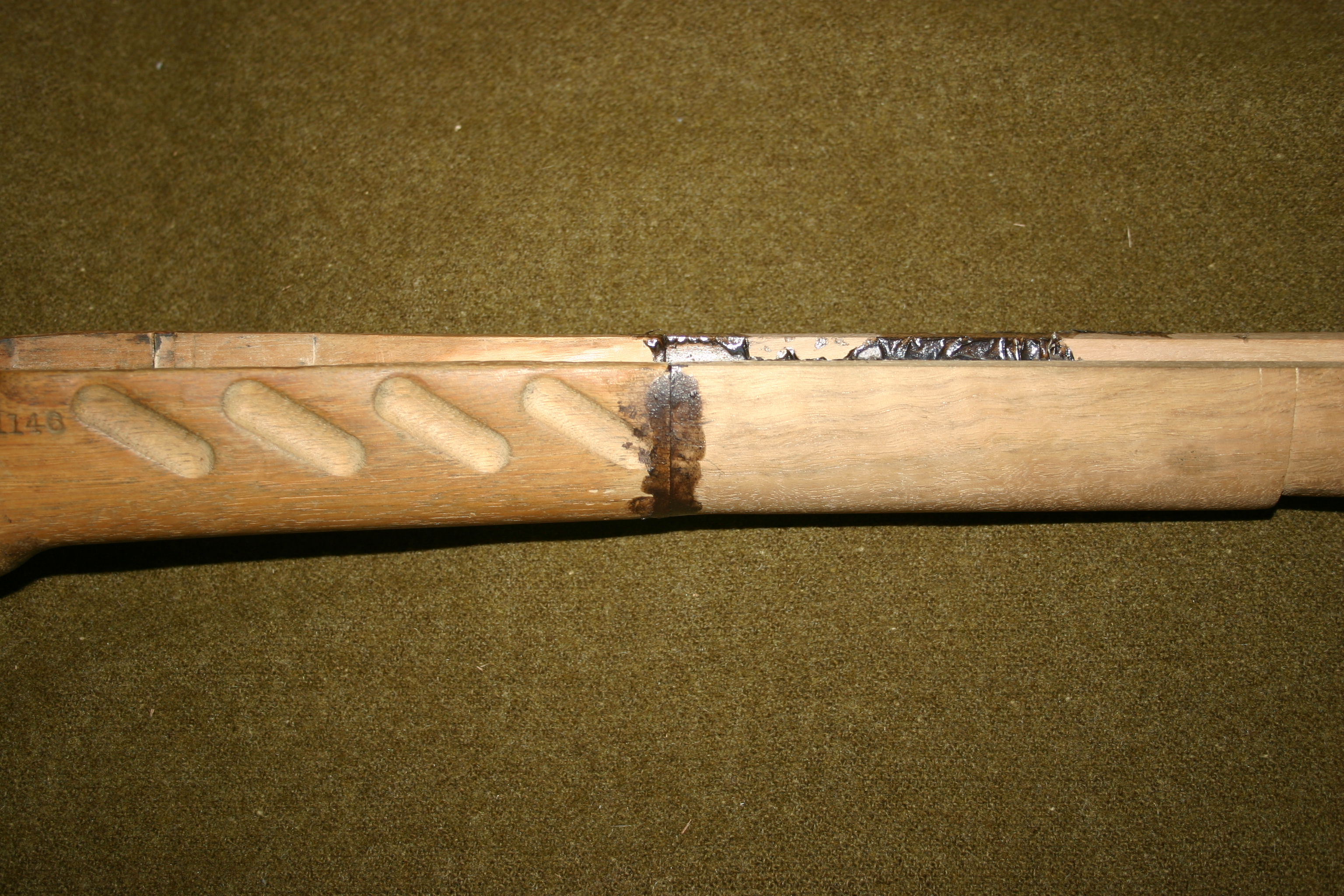

Things are now glued back together... hopefully this time is the right one...
A bit of a mess but it should clean up nicely.
Attachment 123773Attachment 123774Attachment 123775

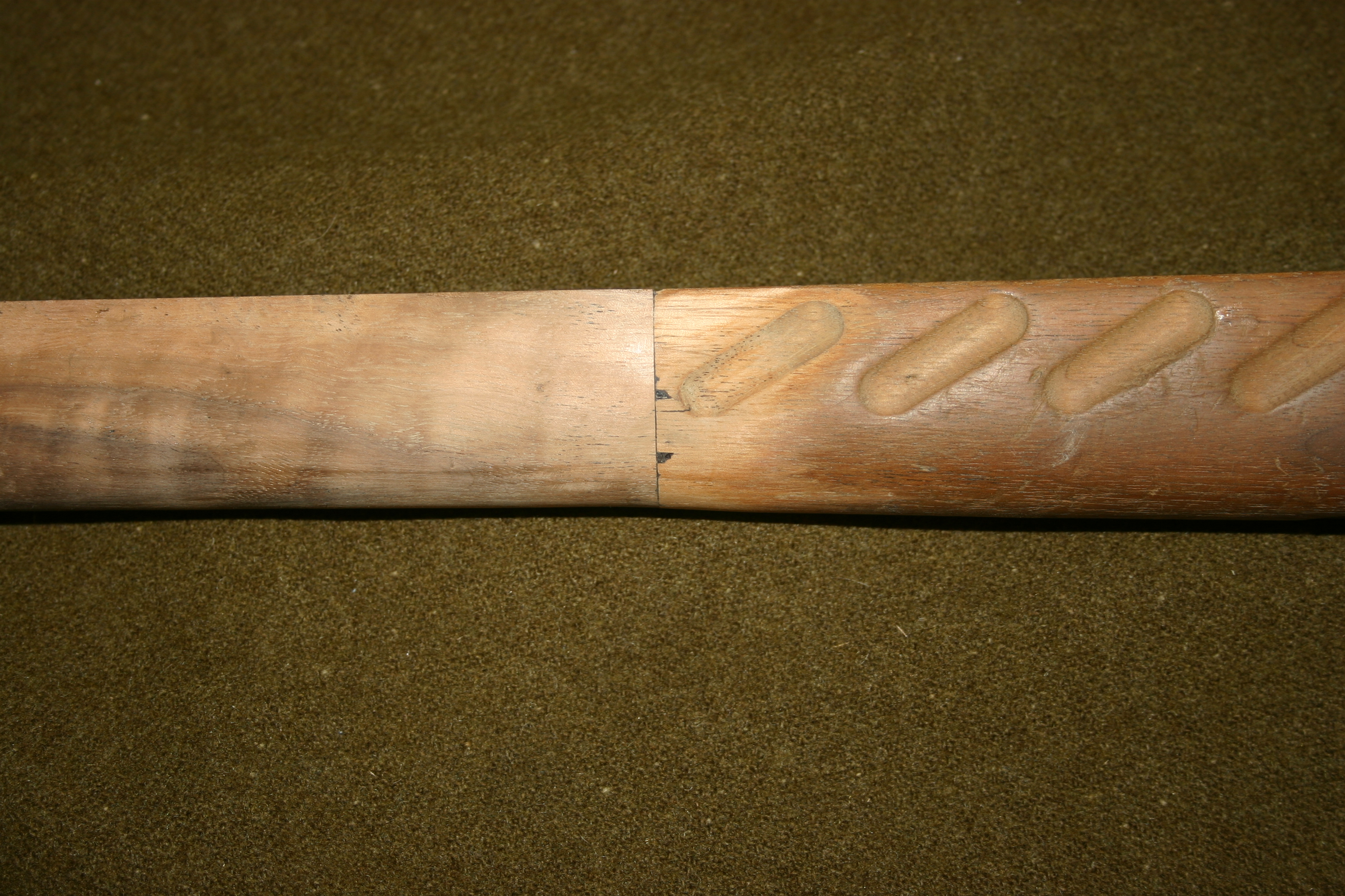

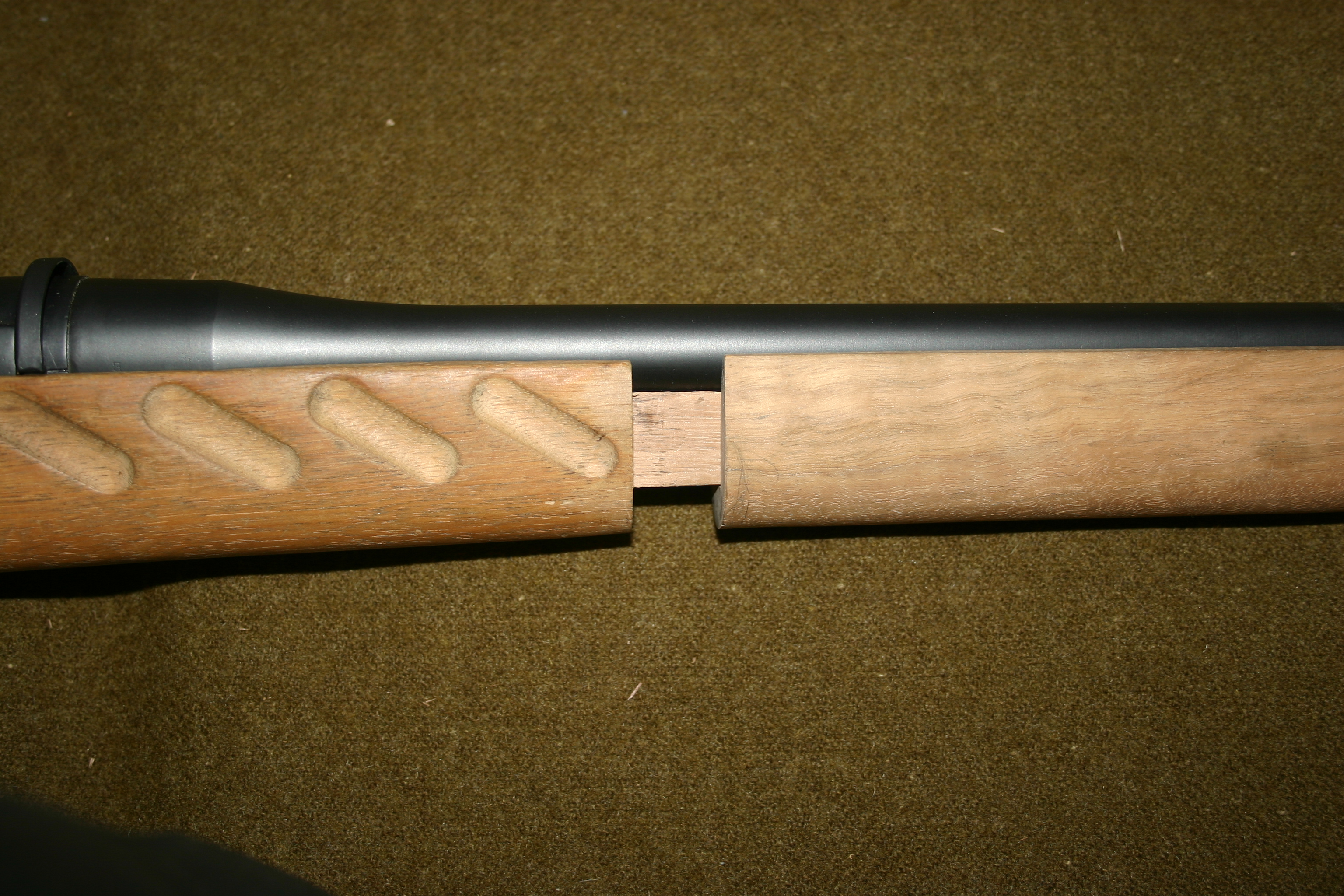

Success ... other than some tiny chippings the splice is now pretty much straight and centered to the barrel.
Attachment 123804Attachment 123805Attachment 123806
The sanding and staining should take care of the chiplets...

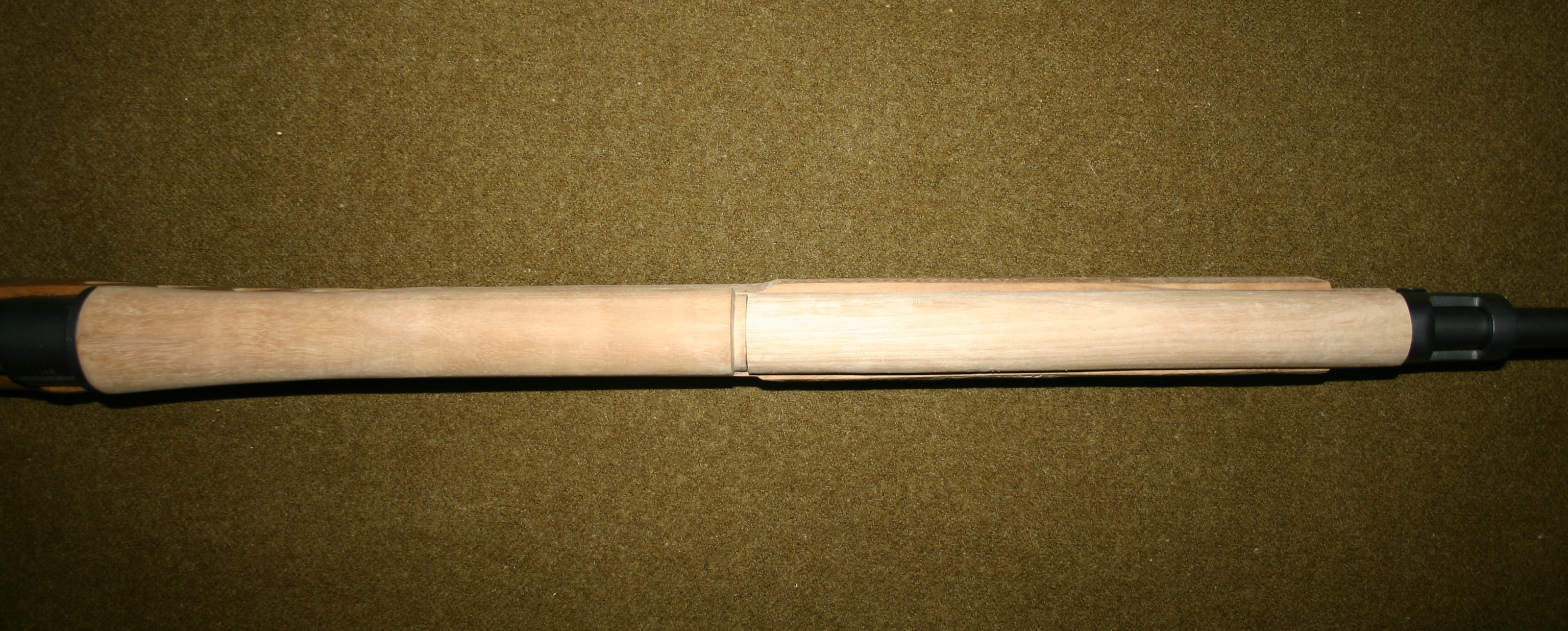

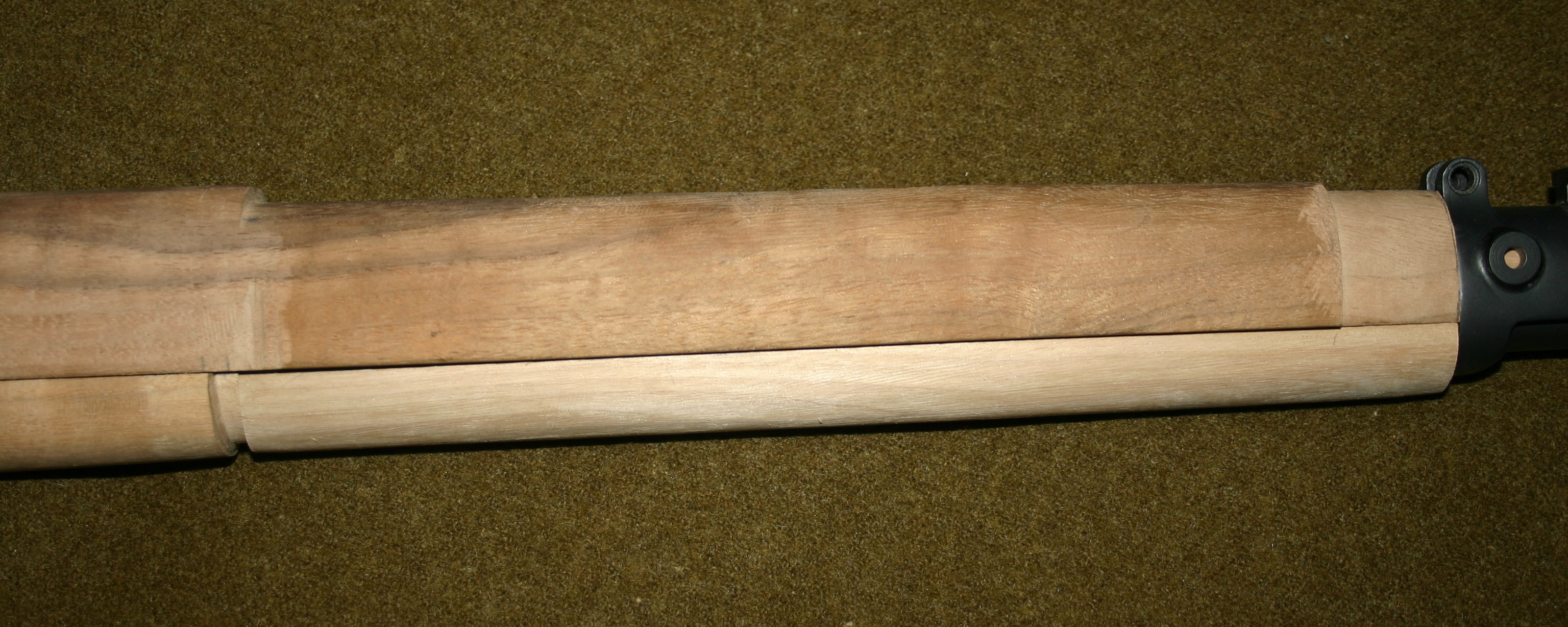

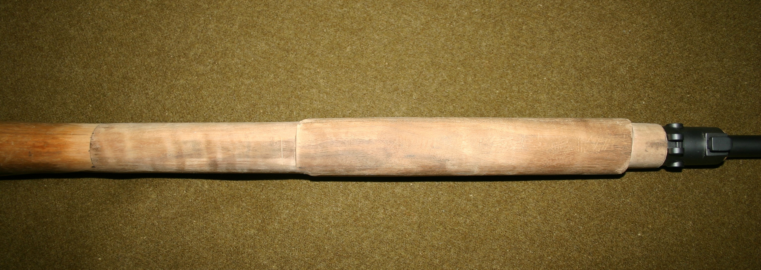

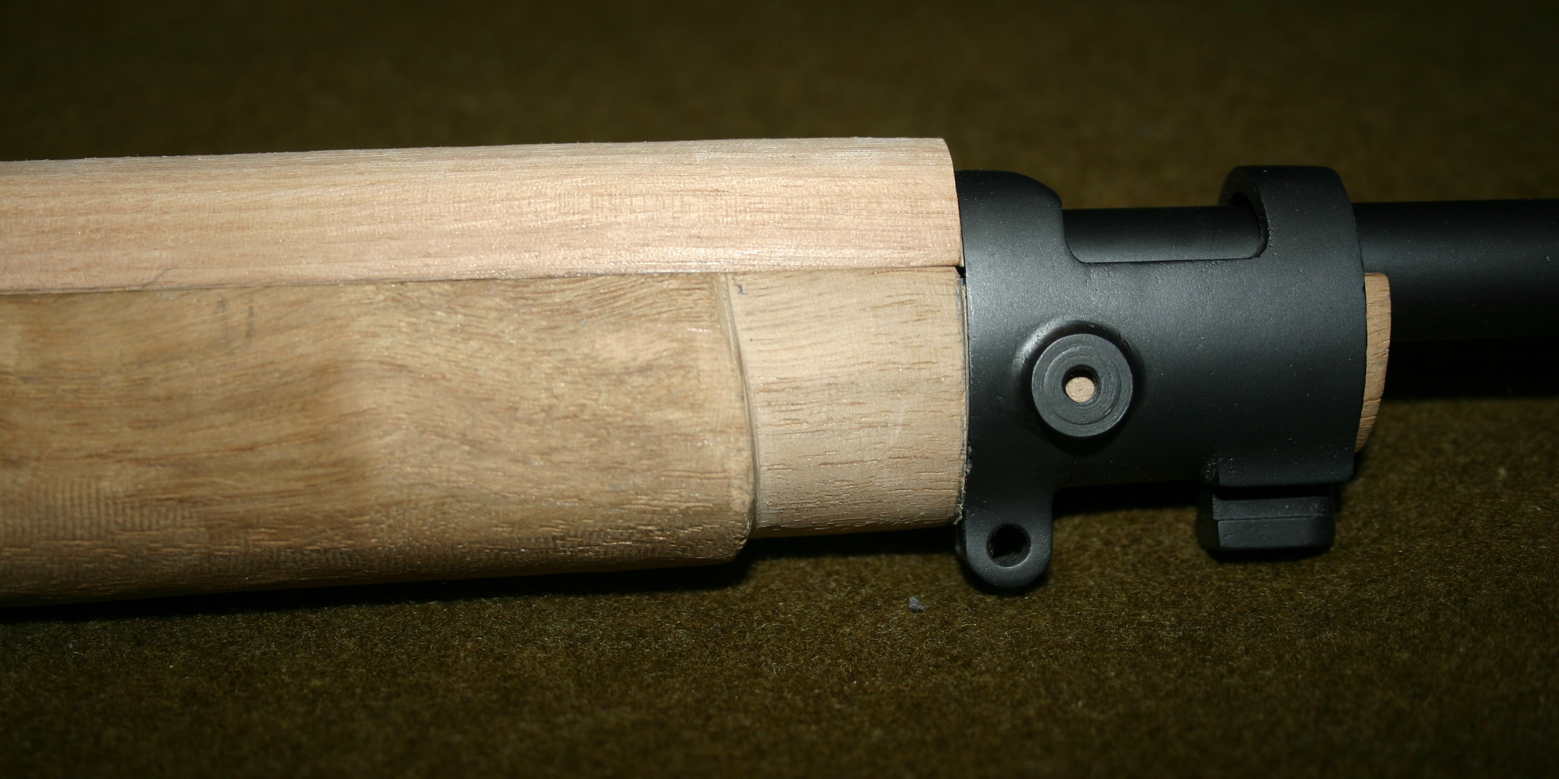

Made a bit more of progress again... the ''rear'' portion of the splice, the rear handguard and the nosecap fitting are 95% done i would say.
A lot of time is spent measuring and drawing lines to help with the shaping process
The last 5% will be slow and time consuming too as it is done mostly with sandpaper and is fine tweaking and finishing work.
More pics.
Attachment 123904Attachment 123905Attachment 123906Attachment 123907Attachment 123908
