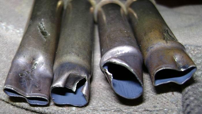

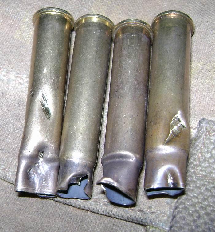

here is the damaged cases from last time at the range
https://www.milsurps.com/images/impo...a2d3e036-1.jpg
https://www.milsurps.com/images/impo...f3c0bcd7-1.jpg
the worst was the flattened case that was stuck between the bolt and the barrel with a live round half in the chamber on the right side. it was firmly wedged in there and I had to pry it out.
