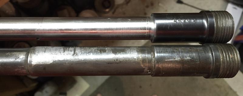

    Here's an example comparing the rear sight area of both barrels after the sights are sweated off (Argentine on top):
    Note that the argentine barrel is thinner. I've already cleaned the ruling off in prep to solder on a collar to increase the diameter. Also, I already turned the the front of the chamber area at the step to get rid of the radius there. The sleeve will now fit flush and we can re-machine a nice, sharp step like a K98k barrel.

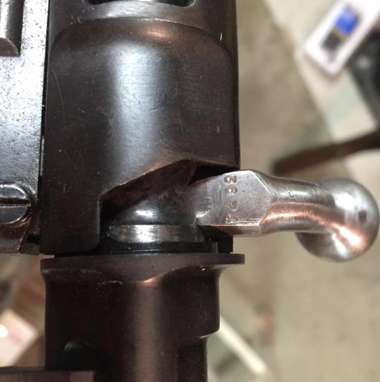

    VZ24 bolt handle bent to close approximation of military K98k bent bolt profile (before cleanup). I don't do these myself. I go to Gunco in Ottawa as Jason has the right jig and the right torch to spot-heat the bolt root to do this bend without too much heat getting over into the bolt body. I don't recommend a bolt bend as a do-it-yourself job. Go see a gunsmith who owns the right jig and torch. The jig is too expensive to buy for the few times I do this.
    The receiver I used. note I changed the 4 scallop VZ24 action screws for 3 scallop K98k screws. Apart from markings, these receivers are identical to WW2 German receivers and are really well made. I scrapped a scrubbed Romanian RC VZ24 for this action (yes, I know, someone will be terribly upset, but I couldn't locate a nice sporterized action).

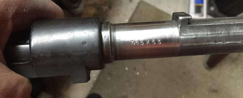

    Clearly marked so nobody tries to shoot .308 or 8mm in this rifle. That would not be a great idea.
    Bolt re-numbered at the root, as the electro-penciled SN on the RC bolt was destroyed when I sanded the scale off the bolt handle post-bend.
