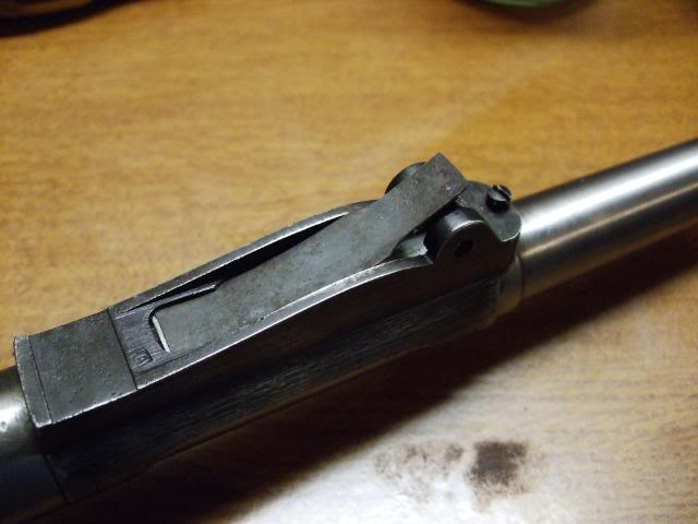

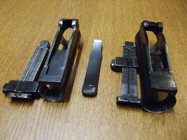

    After a few phone calls i managed to get a sight base (thanks to Tery Abrams) as you can see compared to original the diameter is larger, also the recess for the leaf spring was shorter than original will come back to that

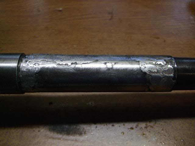

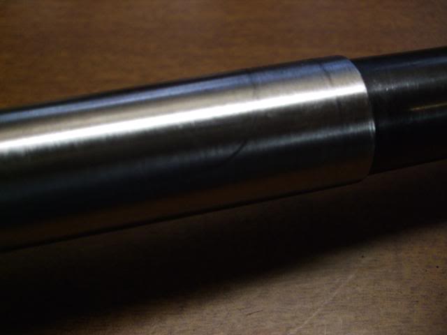

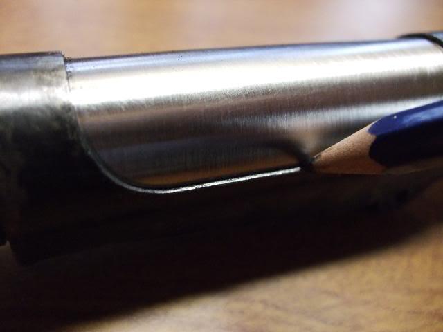

    First job was to clean up area on the barrel where the rear sight will fit and then mark a guide line using pencil to give an idea of the areas to be tinned this was also done for front sight
    Next job was to tin the area,s

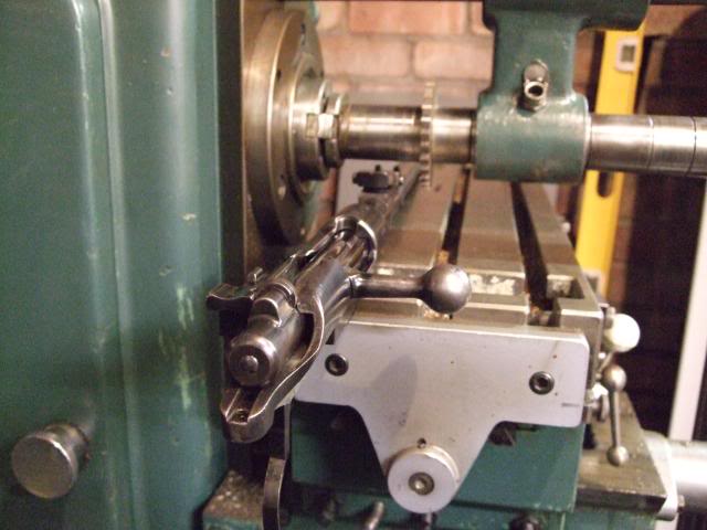

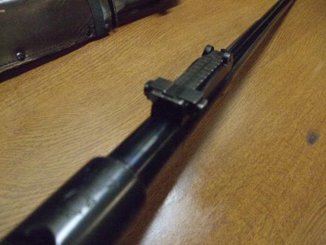

    Major problem then was to line up the sight base this was done using the milling machine table were the action sat and the table was positioned under the arbour then it was a matter of gentle taps until it was level with the arbour
    after the set up heat was applied to area to be soldered same set up was used for the front sight. The areas that require solder must be clean my first attempt did not go well due to the sight base still full of grime, its also a good idea to clean the solder,

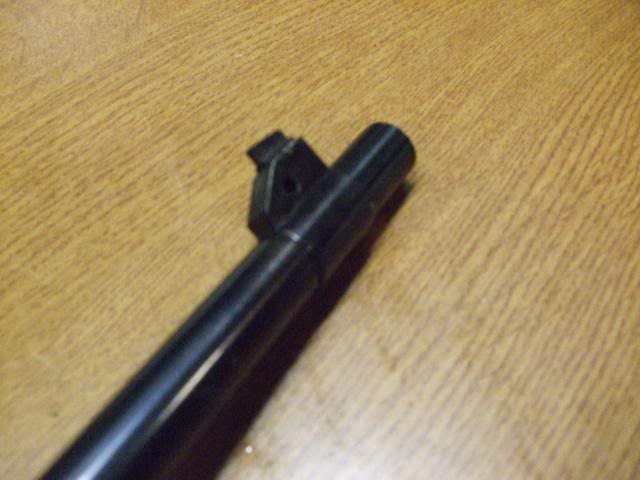

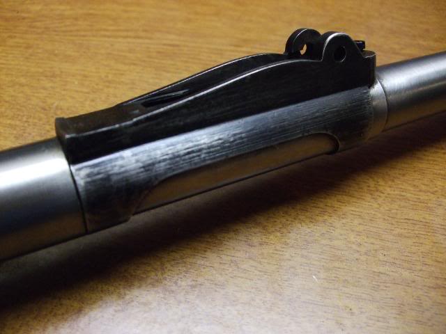

    sight base secured rear and front

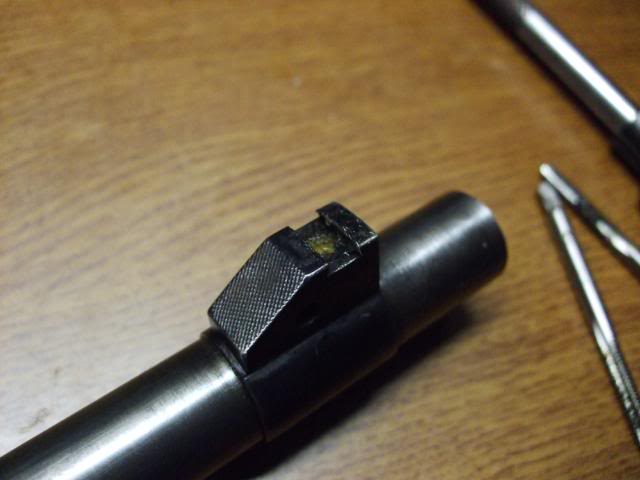

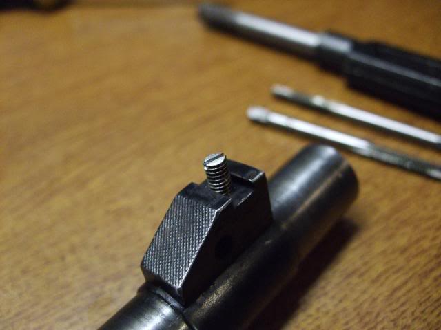

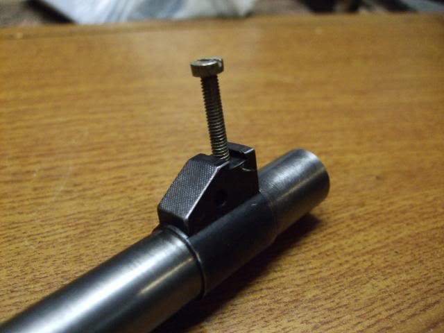

    the original front sight securing screw didnt want come out so it had to be drilled and tapped, then had to make a new one i had a few 4BA bolts on hand so one of these were used the pic above show the bolt before cutting to height.
    below new securing screw made and secured into position and greased ready for the blade to be fitted

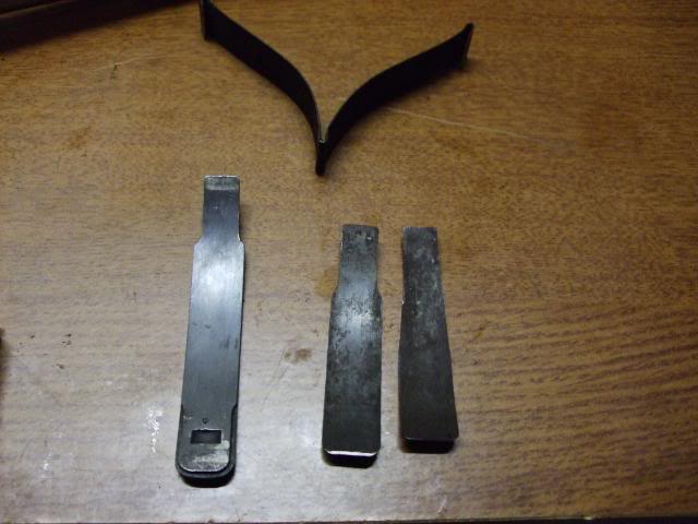

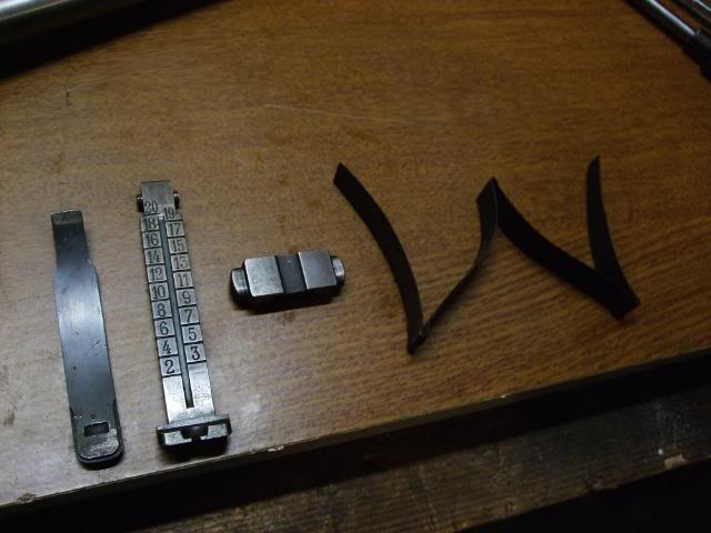

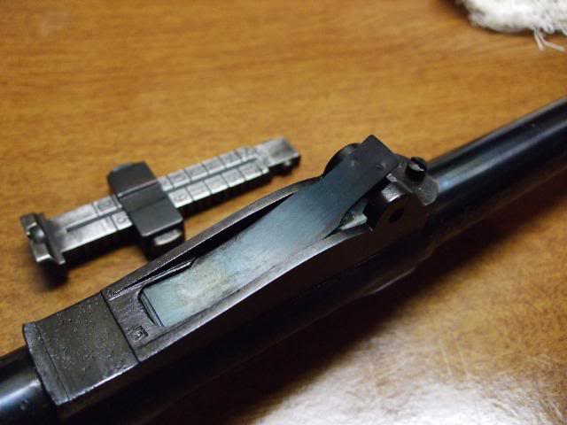

    Next step was to produce a leaf spring i used an old mag spring (from a P14) for the metal
    the 2 shapes were cut and filled to suit, notice the length of original
    they fitted ok
    th

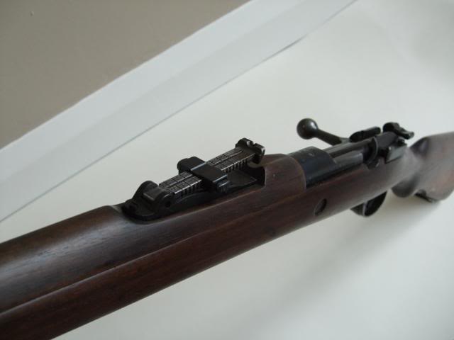

    these were then cleaned up and blued along with the sight bridge, i used the heat and oil method.

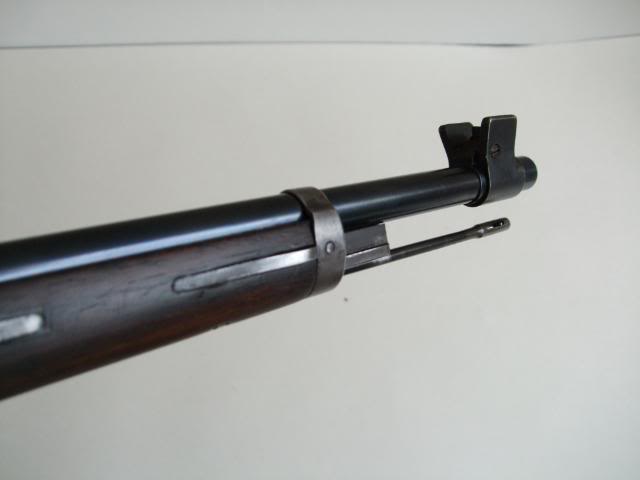

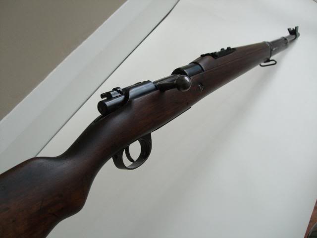

    After this i give the whole barrel and sight base a clean up and reblued using the birchwood casey paste, originally this is what i used, i wanted to rust blue, but this was a good match the only thing with the paste is its not hard wearing i will probably rust the whole rifle at a later date but was happy with the results.
    Blued barrel and base waiting the finishing touches

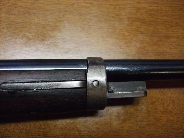

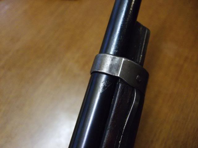

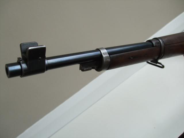

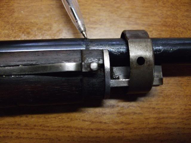

    One thing i had overlooked was the forward barrel band would have to be altered to allow for the K98icon barrel Step (the stuff on the barrel is grease it was used to protect the finish)
    after a few strokes with the file the barrel band was relieved of a 1/8" on the top rear of the band to accomodate for the barrel step

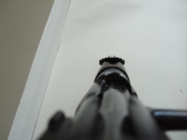

    That was the main work complete, before the full assembly i greased under the barrel and other parts that would be covered this included the inside of the barrel bands and the foresight protector. All thats left is to get to the range to run the barrel in plus a visit to the proof house i will post pics of how its shooting, think it will be fine any bad group will be down to the operator.
