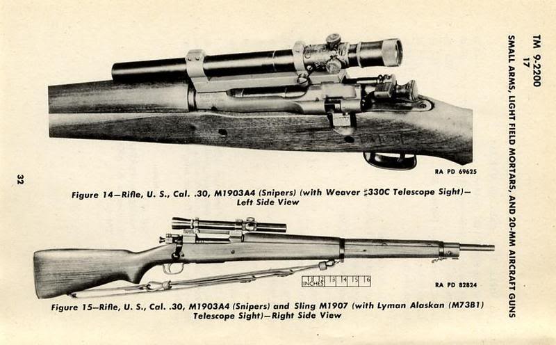

    The M73 version of the Lyman Alaskan was standardized in 1943 with a fine crosswire reticle similar to that of the M73B1 (Weaver 330). At least their are engineering shop drawings that date from Sept 43.
    The post reticle was introduced with the M82 scope in early 1945. As mentioned before the M81(crosswire) and M82(post) incorporated a sliding sunshade on the objective lens and a rubber eyeshield.
    The following picture is from an Oct 1943 Tech manual and illustrates, in the lower picture, an M73 mounted in the top split rings. (NB: The original caption writer made a mistake in the nomenclature - The upper picture shows the Weaver 330C (M73B1) and the lower should have been labeled M73).
