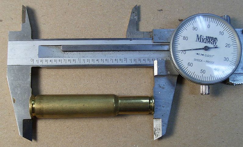

    Use Parashooter's technique below to get the relative headspace of the *fired* cases, and (if not different by more that a few thousandths) resize to match the smaller case.
    Quote Originally Posted by Parashooter View Post
    With a good caliper and an empty 9mm pistol case, you can perform relative measurements of head-shoulder dimension to compare fired and sized cases - and at significantly less cost. This will enable you to determine how much, if any, adjustment is required for your sizer or shellholder.
    (Note that a .38/.357 case does fine too.)
    If *more* than a few thousandths, either resign yourself to slowly stretching cases or segregate your reloads.

    Thanks', MEHarvey, what I was thinking about..
    as I have a Sinclair Intn'l Bullet Hex, thought about using the .358 gauge, to get a quick reading. Have plenty of 9mm & .38/.357. I presume to use a "sized case"??

    Depending on the neck dimensions and shoulder configuration of the cases to be measured, a 9mm or .38 pistol case may not be the best choice. They're OK for some 7mm's, but others would do better with a .32. The pistol case has to be a close-but-free slip fit over the neck and also large enough to avoid contacting any radius at the neck/shoulder junction.
    It's also a good idea to make sure the pistol case mouth is undamaged (truly circular and square to the head) and to run a fine file over the headstamp to remove any burrs (or primer protrusion if not decapped).
