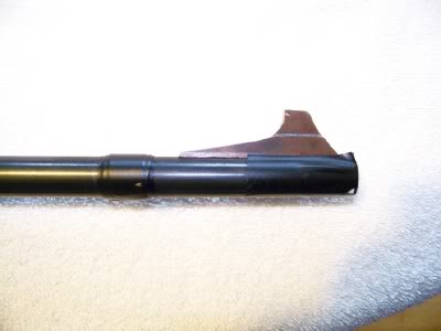

    Today @ 08:20 AM
    Central Wisconsin
    1,647
    Frank Derrico
    07-03-2025
    10:46 AM
    This would have prevented that.....Frank
