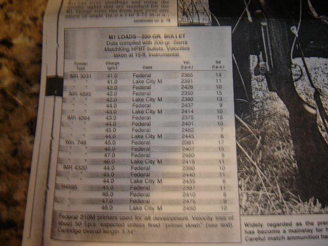

    That photo of the American Rifleman article on Reloading for the M1icon is nice to see. I thought I was the only guy around that remembered or used that article. And the data was especially helpful years ago when I got my "Blue Sky" M1 Rifle reimported from Korea.
    Legacy Member AKA Hugh Uno's Avatar
    04-12-2020 @ 07:37 PM
    303
    05-03-2025
    01:48 AM
    American RIfleman Article
    Quote Originally Posted by truckboy View Post
    it's proven to be an "argument ender" more than once!
