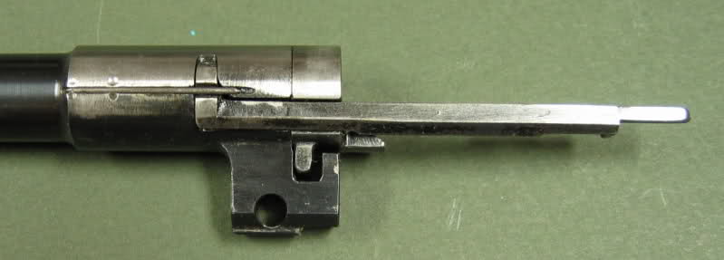

    This old Bacsi got a Colt Ace 22 conversion , no documentation . I can't figure out where/ how the Ejecter mounts ? I would appreciate some advice.

    The early conversion units had a milled ejector and the later ones had a stamped ejector. The ejector goes under the spring on the left side of the chamber area.

    Thank You
