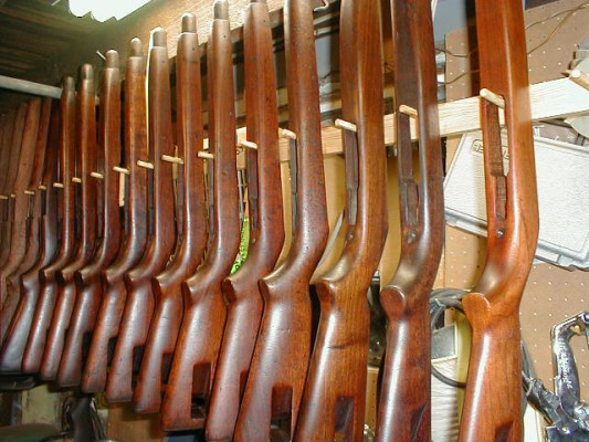

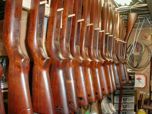

    you have always done good work. Here are two pictures of Rick Bicon's work. I sent him a dozen carbine stocks twice. pictures are the first twelve. These were Blue Sky painted, black, druged behind a tank stocks. Rick used more red than you. I like your color better.

    Rick Bicon does some very nice work. I have a few here that he did the repairs on and were passed on to me or I ended up buying them and have refinished them.
    The stocks in my picture above are not stained, except when a wood patch was installed. Normally I Strip the old finish, gunk and rack paint. Then Use a 2 part painters wood bleach solution on the darkest ones. Then dropped in to a warmed/thinned BLOicon mix overnight. After drying 2 more coats are applied and buffed with #4-0000 steel wool soaked in oil to buff down the shine. It's amazing how much the stocks soak up the BLOicon and improve the metal fit. Reminds me of my Father making us brush warmed up BLO on the old wood truck beds.

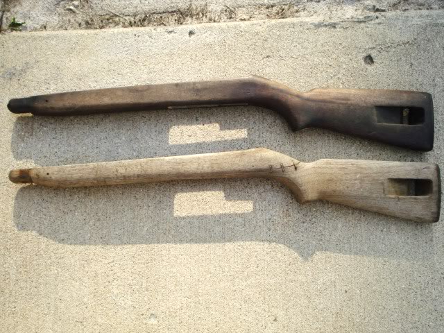

    Tossing in a few BEFORE pictures
    Here is what many of these stocks look like when I get them.
    Think that Stan Pro will soak up any oil?
    Cheers
    Charlie-painter777
    Top One Win Type III....Bottom one Stan Pro Type II
    Winchester with a boxed G.H.D. stamp, and W marked slingwell,
    Stan Pro showing out line of the CC and slingwell markings. Along with some needed repairs,
