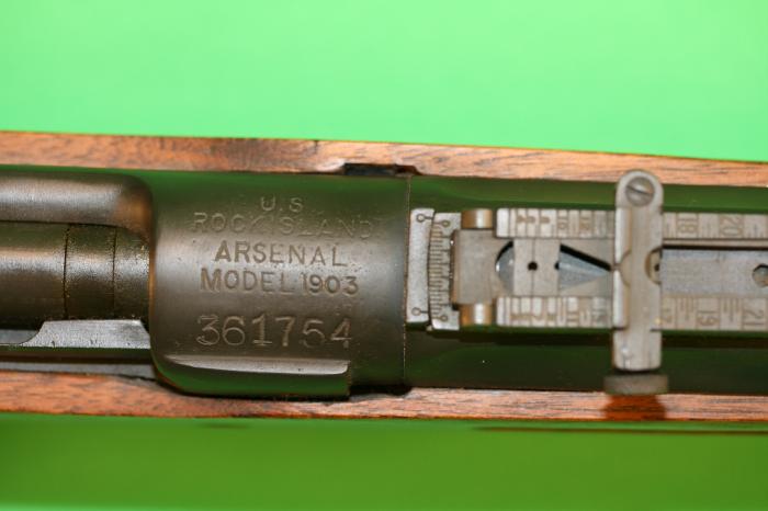

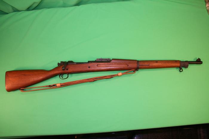

    Look at this auction. It appears to be a former Miltech rifle. "5-42 RI barrel," and look at those grasping grooves! (on a reshaped K-marked Scant stock!!)

    Nice router work, too bad it is the wrong shape.

    Routing work OK, but trying to get the cigar finger grooves is tough. Sellers name is spot-on! But buyers name will be "afoolisborn". This auction bears watching, sorta like a train wreck.

    typical miltach park job, every screw, pin, and spring were parked, ill bet he paid a mint for that job,
    iv redone a few miltech park jobs, i do it right, and charge a bit less.
    stock looks cheesy..
    id bet thats a RA marked barrel.

    I could do with fewer bulges, but that scant stock NEEDS one right behind the trigger guard to make things right.

    The serial number does not look right. The "3" looks to be etched on. It looks nothing like my RIA 03. It may be the angle of the picture, but I would want a written return policy on this one.

    Cool Retouched SN
    What it looks like to me... is that refinishing made the SN faint and shallow and they touched it up with an electric vibro-pencil. If you look closely the 3 has doubles line and the 1 extends below its base. Very likely the other numerals have been "enhanced" by following their impressions with a vibrating pointy object.
