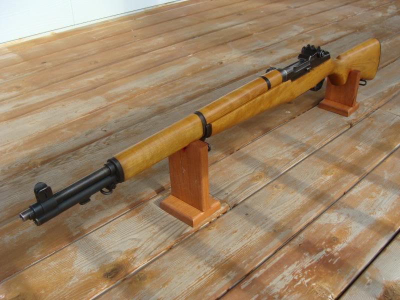

    Here are some pics of one of the Dupage 2nds in birch. I stripped off the brown stain with lacquer thinner, then dyed it with dark brown leather dye, and finished it with tung oil. I applied the stain and immediately wiped it off with a paper towel to try and get the red only color. I was going for that orange look that the older birch stocks get. Paul

    That's the way to do it. Nice job.
