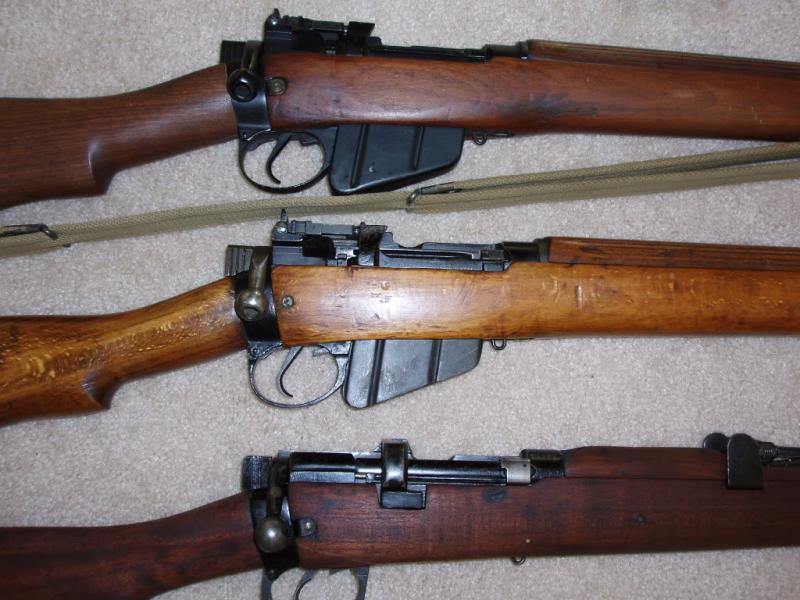

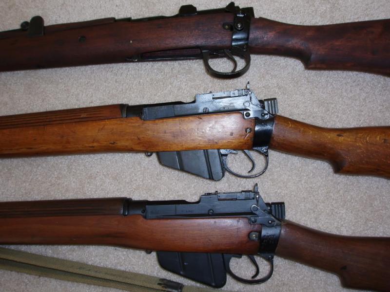

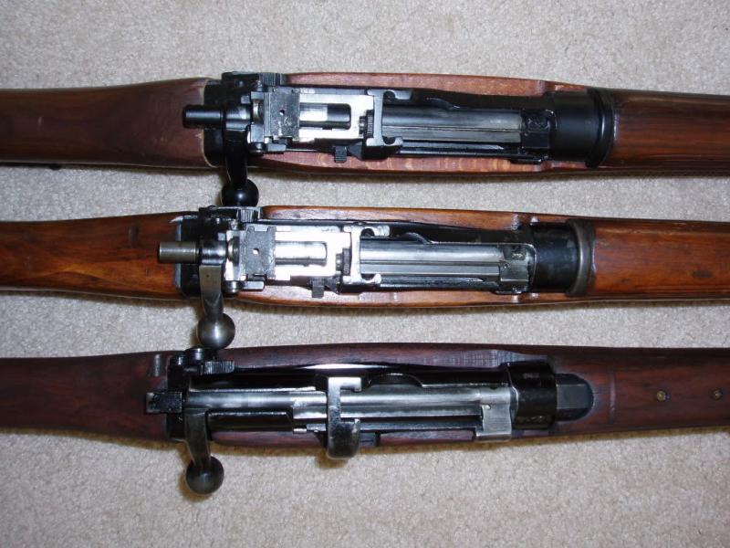

    Guys, I'm not a huge Enfield guy at all. The #4 with the sling was given to me by an old Britt who claims he carried it while in the service. No import stamps and he is a pretty straight shooter so I believe him. It is all matching to include the magazine and what I have been told is the original finish. It is dated 1943 on the grip band. The other two I bought along with a very early Remington Wing Master 870 shotgun, an H&R Trooper .410, a sporterized model 99 Arisakaicon and a 100% original Standard Products M1icon carbine. I got all for $500.00 so I don't think I did too bad. This was two years ago.
    The other #4 has no markings on the grip band and a very small import stamp on the left side of the receiver.
    I think the #1? is .308 because it has a 1968 date on the grip band and says 7.62mm also. I know next to nothing about these Enfields so please educate me. What can you tell me about them? What do you think? TIA

    The second enfield down is a No.4 mk 2 - you can see the beech stock and the cross screw in the fore end just before the butt socket. Probably made at Fazakerley in the 1950's.
    Bill take a look at the left side receiver wall as the markings were electropencilled there. The rear face of the bolt handle will also have a serial number probably starting with PF.....
    The bottom one is a rifle made at the Ishapore Arsenal in India in the 1960's specifically for the 7.62mm x 51 NATO cartridge. It does have a different style of magazine and holds 12 rounds IIRC.

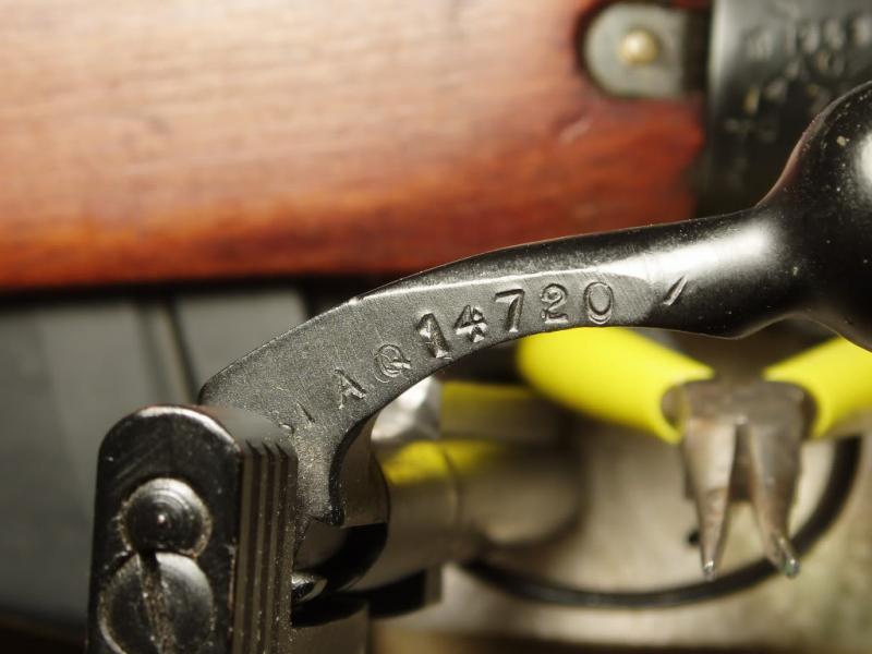

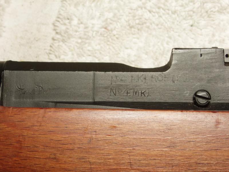

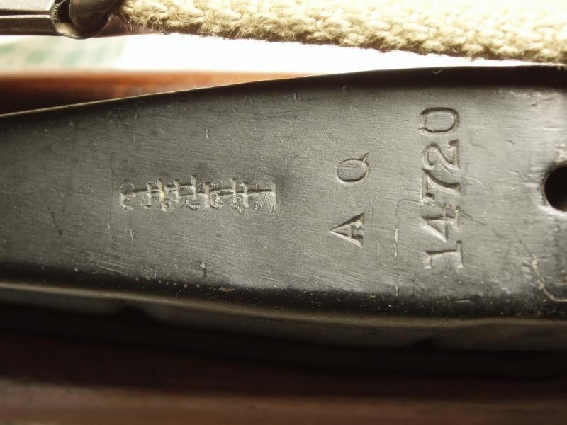

    Is it posible that a rifle like this went through a rebuild at one time? The magazine has the matching serial number but it is obvious that a prior number was XXed out and the matching number applied. Was it originally electropinciled also? Also, on the "left" side of the receiver, why does it show two N04 MKI stamps??? Shouldn't the serial number be behind one of them? Years ago I was told it was original with the original finish. I had my doubts at the time but because I know next to zero about these rifles I'm in the dark. Thanks
    Here are some close up shots:
