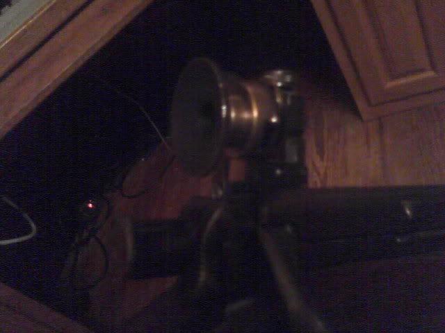

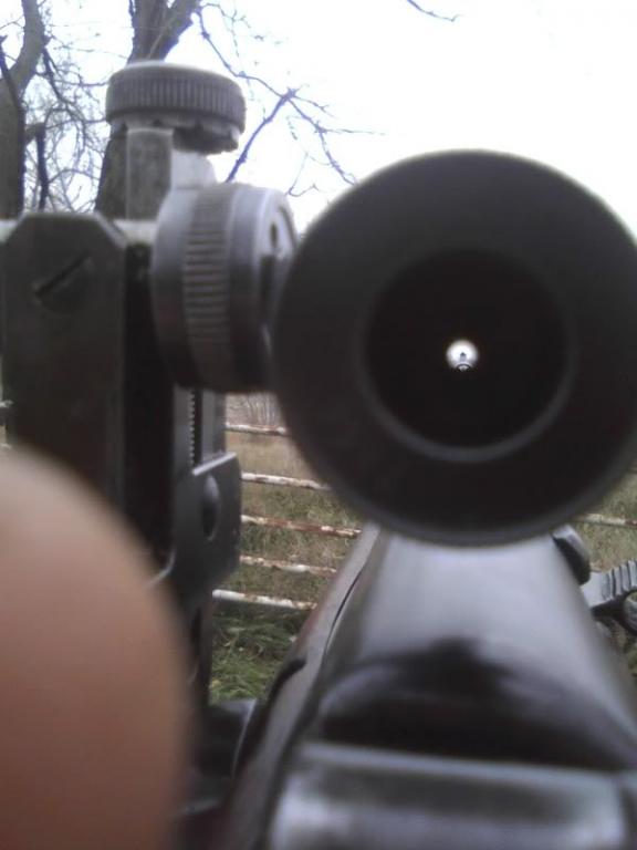

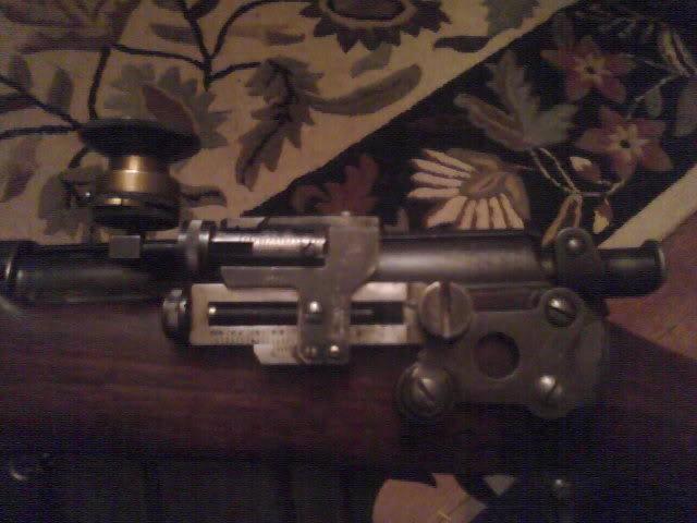

    Here is a picture that I just took today. I have trouble finding the front sight within the eye piece through the cell phone camera. Just too tiny to see anything until I download the photo's to my email. Fred
