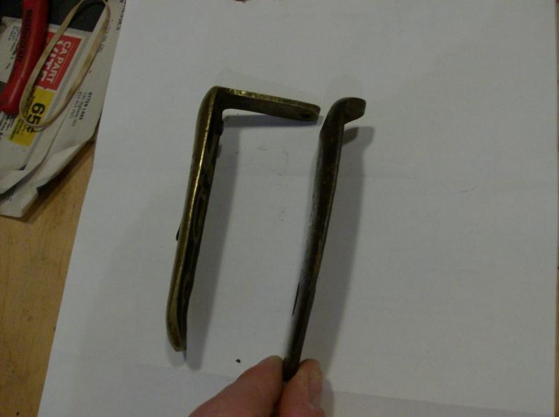

    Hi Laurie, sorry for taking days before getting back to this.
    I took a couple of pics of two older buttplates I've found in my "misc." parts bin. Not sure where to go from here... except asking around for pictures and measurements of the LEC butt!
    Lou

    Here are some photos of the LMC/LEC buttplate and as a point of reference an SMLE buttplate.
    The carbine buttplate, which is on the left and top, has pretty much the same end profile as the SMLE, but is flatter in side profile with a slightly turned-in toe and heel and is a little more rounded in the upper heel area. The lower screw on the carbine is in roughly the same location as on the SMLE, but the upper screw is much higher and enters at a marked downward angle. The screw spacing on the carbine is 3.35" centre-to-centre measured at the exposed face of the butt. Due to the angle of the upper screw, the measurement would be somewhat less on the inside.
