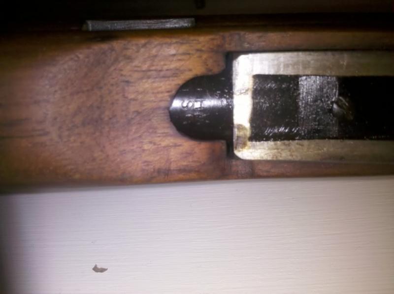

    Can you post pictures of the "cancelled" DP marks on the metal? I'd really like to see what they look like.

    Here are the "cancelled" DP marks
    The BNP post-1954 mark
    The HV and SC(SG?) marks below the rear sight leaf
    Another view of the cancelled DP marks
    Finally the makers mark

    Its probably a rifle that was un-DP'd in 1940, along with quite a few EYs and GFs. You do see quite a few with these cancellation marks.
