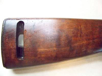

    After a deep cleaning or a full strip on a stock, I can get an idea of how dark the natural grain is by wiping a coat of mineral spirits on. This gives me an idea as to how dark it would be if just oiled. Many are lighter grained and end up being stained. If it's a dark cut, I move on to just oiling the stock.
    Before strip,
    After strip....NO STAIN,

    Just wanted to add that on stripped stocks that are still too dark......I use a 2 part Wood Bleach Solution made by Klean-Strip. It lightens the stocks' natural color and can really pull out hidden markings. Also helps to pull out those spotty black marks along with water stains.
