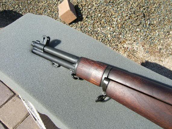

    I went ahead and grabbed it.
    It is a welded receiver, IH 5094200, with the drawing number of D6528291-W. Most of the parts I have bothered to figure out are SA. The barrel is an Arlington Ord 7.62 barrel with a really good looking bore, and it has a Smith Enterprises brake on it.
    It does have a plastic spacer in the bullet guide, and op rod looks great (piston head looks almost new). the stock has some dings, but locks up tight.
    I did read Scott Duff's input on welded receivers somewhere online yesterday before I went to check it out. I did pull the spring out and the op-rod and bolt slide freely fore and aft when the rifle is pitched up and down within 30* of horizontal.
    I'm going to try to get it out tomorrow and try it out. The owner stated that a few times out of the maybe 200 times he fired it it didn't fully return to battery.
    I think I will get a Wolff spring made for the "tankers" just to be safe.

    Well, I got the rifle out this morning and I'm pretty pleased with it.
    Out of the 98rds fired I had 3 that misfed-the nose of the bullet became misaligned with the chamber it seems as they were srtipped from the clip (two were nosed to the left of the chamber and one was a stovepipe, but with the unfired round). Other than those issues (and I'm curious if they couldn't be indicative that I should get the Wolf spring made for the shorties) is shot really well.
    I got 7/8 rounds onto the black of 200 reduced for 100 target that I shot off a wobbly carpeted block on a bench at 200yds, and was hitting about 60% on 10" plates at 200yds offhand. It zeroes at 200 with 8 clicks up and 3 clicks left of mechanical center.
    I ran Portugese surplus 7.62X51 and to my unknowledgable inspection powers I couldn't see any signs of the action or rod getting battered. What should I look for to tell if anything is getting beaten up?
    One thing I can say is that the Smith Enterprises Brake is a very effective brake, the shorty feels like a 223 offhand! Its got a heck of a bark, but no teeth to its bite.
    Are all enbloc clips very rough parkerizing? The ones the owner gave me are all bone dry and the park'ing is very rough-could this drag be related to the few misfeeds?

    If it isn't going into battery- part of the problem could be that the sharp turn in the operating rod is binding up on the oprod spring. See if the spring slides easily in and out of the orifice. The trickiest part of tankers is the oprod. When it is bent, it should be heated so the metal bends withoout kinking. Of course that brings up heat treat issues.

    The spring slides in and out very easily. As I mentioned, I think I'll try a Wollf spring for the shorties and see it that helps.
    Its definately a fun rifle that will be a keeper if I can get the little bit of bugs out of, if not oh well.
    Since its not a collector, I'm curious about the stocks on these buggers. are the rear handguards the standard length and the front cut down, or are both modified?

    The usual Tanker gets just the front h.g. cut down to a stubby inch and a half. Sometimes it's left off altogether, which I think looks unfinished. I had my barrel machined back at the barrel band so my rear handguard and stock are one inch shorter. I used an Italianicon 1/2" short stock and took another half inch off it. Now my front handguard is two and a half inches long and it balances out the look.
