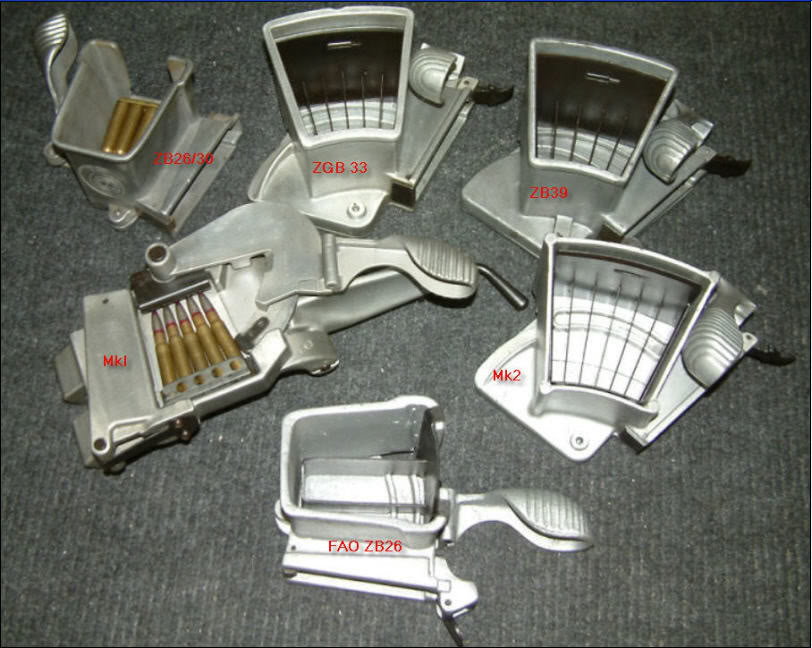

    The only picture I have to hand at this momment in time is a pic showing the 'evolution' of the Czechicon design which starts off with the ZB26/30 and ends with the Spanish FAO ZB26 copy mag fillers.
    Hope this will do until until the sun comes up ?
    ATB Kevin
