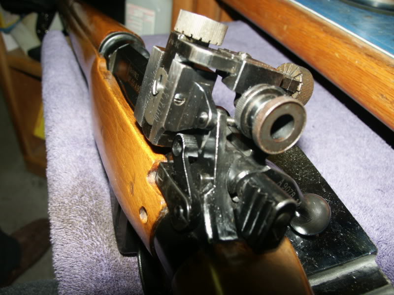

    I finally got around to making an ejector screw to correct length so I could mount this PH5C on blondie. This is the first time I have had an adjustable aperture peep and I like it. Now for the question. The 5C has two models, one in 1/2 moa (small knobs) and one in 1/4 moa (large knobs). I have read a few places that the large knob version is calibrated for 7.62. Is this correct? Or would a PH5C for a 7.62 be marked 7.62?
    I'm not smart enough to figure out the markings anyway with out a cheat sheet so I guess it doesn't matter.
    Meet blondie.

    You get large knobs in 1/2 and 1/4 min. versions. These look like they've been home-workshop made - not difficult with a lathe and a milling machine with a dividing table. I've seen several like this. I've never seen a PH5C that was marked 7.62 (though Parker's 4/80 was so marked, and went up to 1000 only) and I doubt they exist. The PH5E4 probably took over when new production was required. Nobody took much notice of the range markings anyway.

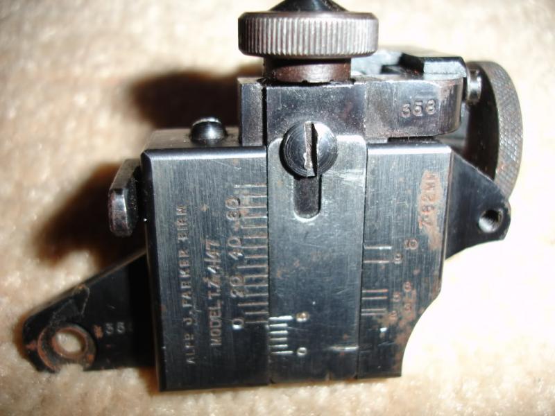

    Not a PH5c but a AJ TZ4/80 sight
    marked 7.62mm -- never seen a PH5c marked 7.62mm -- but have seen the PH5c used on the DCRA NO4 7.62mm rifles.
    I also have 2 - TZ 4/47 sights one is marked 7.62mm just like the 4/80 and the other is not marked 7.62mm.

    Here's a couple of mine - the 5c with big knobs and 1/4 moa isn't marked 7.62, and I assumed it was calibrated for 303. The TZ 4/47 is marked 7.62 though. (I'll have to ask Enfield Trader how he got his so buffed!) Enjoy shooting with the sight madcrate - it's great fun.

    Well first is another pic of a TZ 4/47 marked 7.62mm
