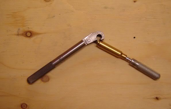

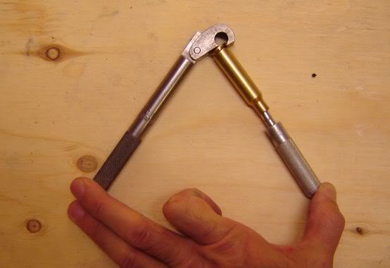

    For those of you who might want to reload your berdan brass... save yourself a lot of trouble and get the RCBS tool, it works like a charm
    MidwayUSA - RCBS Berdan Decapping Tool (click here)
    1- line up the decapping pin onto the stricker depression of the primer
    2- Gently push it in
    3- That's it...

    I have used the RCBS tool in the past, and have one now. It works. Sometimes the case neck can be a bit distorted, but sizing eliminates that. Berdan primers, as commonly used, are slightly larger in diameter than Boxer large rifle primers. I made another sleeve to use with the primer seating attachment of a RCBS press. North Sylva in Toronto is RWS representative, and would be the first place I would look for Berdan primers.
    Apart from the hydraulic system, another way of removing spent Berdans is to drill a hole in a hardwood block that the case will drop into. Cut a slit into the hole. Place the block in a vise, clamp the case in the hole. Make a small sharp pick, drive it into the cap and lever it out.

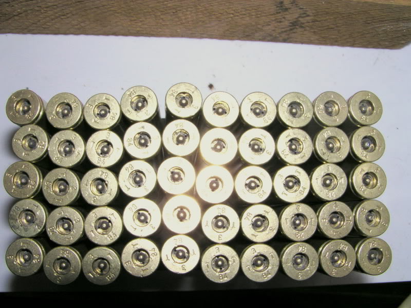

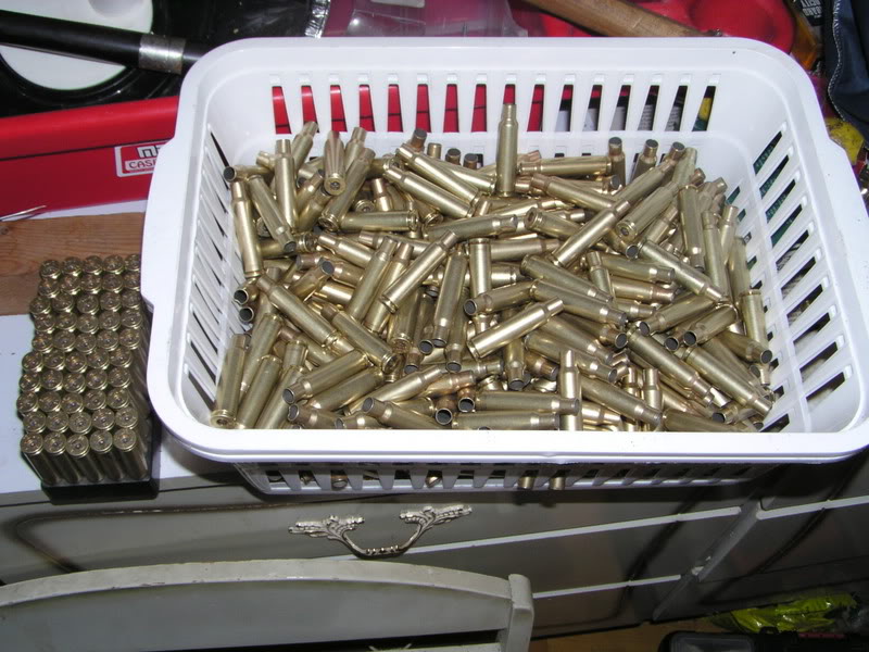

    I borrowed the tool from sillymike and I am amazed how fast it is to deprimed a pile of GP11 brass.

    Most ammo I might agree, but:
    1 Canadianicon RWS supplier is not too far away.
    2 1984 GP11 is not all that old.
    3 I have quite a bit of it.
