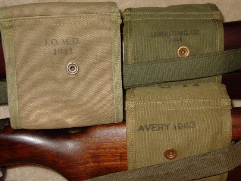

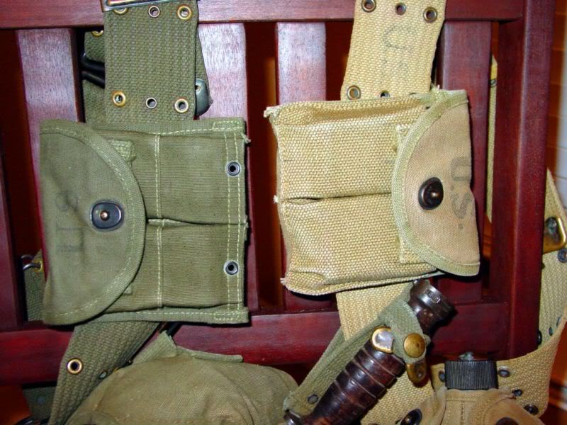

    Generally, it's similar for mag pouches, and all the web gear, but if you are looking for a 'proper' date, it's on the mag pouches.
    There's really not a set rule for most of the WWII web gear though. They were supposed to start changing from OD#3 (khaki) to OD#7(green) in 1943, but manufacturers used whatever they had, so colors can be all over for different dates. Sometimes they'd even use khaki and green on the same mag pouch. (They really weren't that concerned with making a 'fashion statement')
    I'll bet 'Jim4m1s' has a two tone mag pouch in his huge collection. (?)

    The mistake collectors make is they think a pouch or other piece of equipment has to be the same date as their firearm. The pouches and everything else was in one large supply system, so you got whatever was on hand at that unit.
    For instance if you were just issued a Brand New Carbine in 1945, you could have been issued a pouch from 1942, 1943, 1944, or 1945.
    I am not criticizing those that want to dress their firearm with certain dated equipment; I do it too. It is just that what we have in our minds is not at all the reality of what went on.
