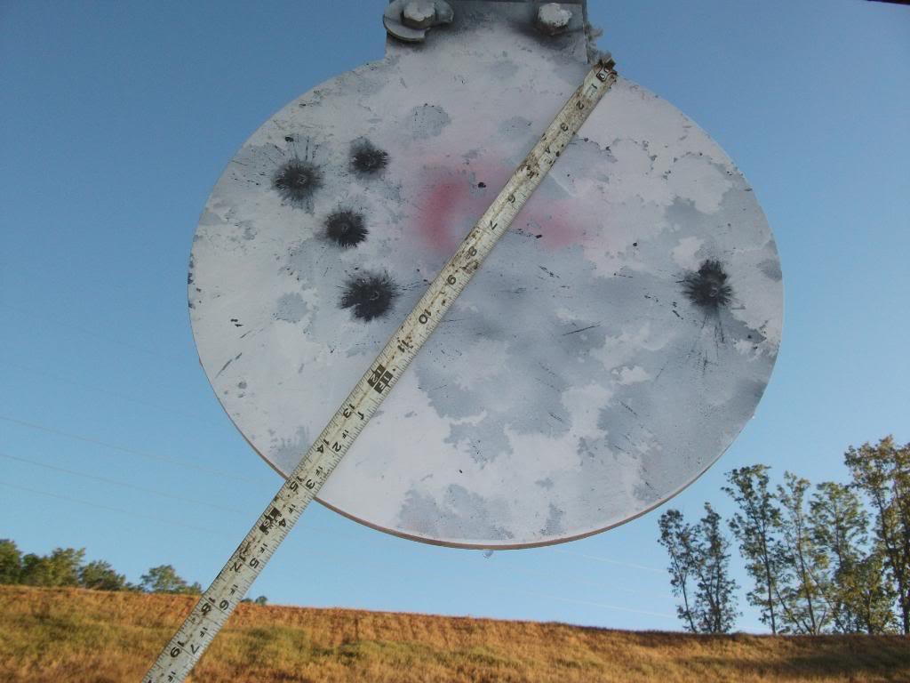

    Ran "Fat B@$+@^d" back to the plates. MUCH better when hits are being made! Scope seems well calibrated for the 168gr FGGM ammo used. Prone, no sling, improvised front hand rest used. Two and three hundred yards were one shot each just to check, then went on out as shown below. If I knew how to shoot hits might have been a bit closer together!
    Five rounds in almost exactly 5" at 400. Can't complain...
    Don't have a good excuse for the RH hit at 500, except I did note that the flags started to move after that one. The rest were in about 4 1/4".
    After the 300 plate this was the next target engaged. Adjusted left a bit after the first two, did two more, and then went went to the 400yd plate after one more small tweak. (The red dots were there already, not my doing!)
