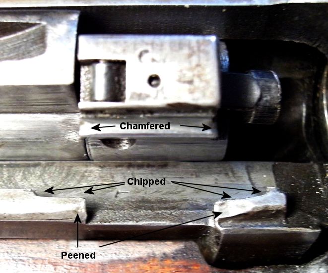

    1/4" back of bolt-closed is near the point where the bolt head crosses the dismount notch on the No4 Mk1* guide rail. It's possible the rail is damaged and/or the bolt head's rail groove is not chamfered. With a cartridge present, the extractor spring urges the bolt head toward the rail, possibly explaining the occurrence of the malfunction only when extracting a cartridge. Try pressing the bolt head down and to the left (away from the rail) during extraction. If the problem is alleviated, you may have identified the source.
    An extreme example of a damaged No4 Mk1* guide rail, also showing chamfered groove.

    Good thought Parashooter. Obviously not case adhesion.
    Best make sure your bolt head guide slot is chamfered like the photo. If not, file it as above.

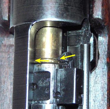

    OK, one more possibility. As the bolt is pulled back, the extractor forces the case to the left, where it drags against the receiver wall. (This friction is what normally ejects the empty case - long before the rim could strike the ejector.) If the extractor spring is strong and the wall is rough and/or dry, the resultant friction can retard bolt movement significantly.
    Try smearing a little good grease on the wall where the cartridge rim drags. If that makes things better, polishing the site of the friction may help, as may keeping it lubed.
