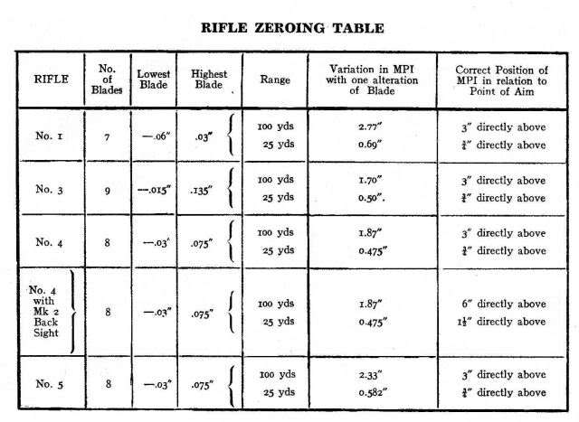

    3ky
    The Mk.1, Mk.3 and Mk.4 with standard military Mk.7 ammunition are sighted in at 100 yards with the sight extended and set at 200 yards. In this position and with a 6 o'clock hold the rifle should hit 3 inches high or above the point of aim.
    The *Mk.2 flip 300/600 sight with a 6 o'clock at 100 yards is to hit 6 inches high at 100 yards.
    (*must be sighted in with the bayonet fitted at 100 yards or 25 yards for correct POI)
    NOTE: this doesn't mean new commercial .303 ammunition will have the same POI as military Mk.7 ammunition.
    Link to sighting in manual below.
    REME Precis No. SA/Rifles/3 (Zeroing of No.1, No.3, No.4, No.5 Rifles)
