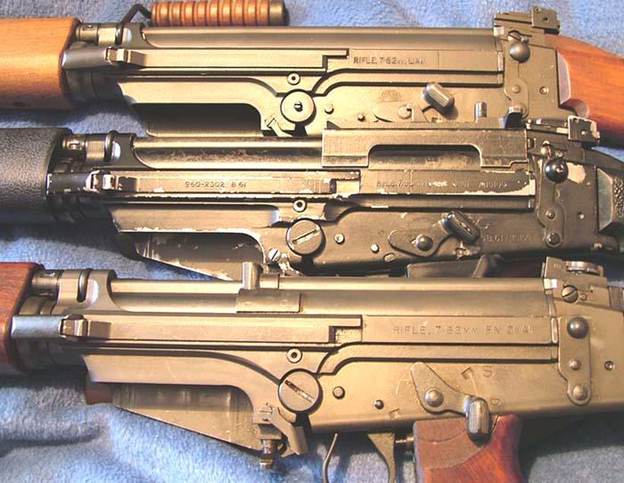

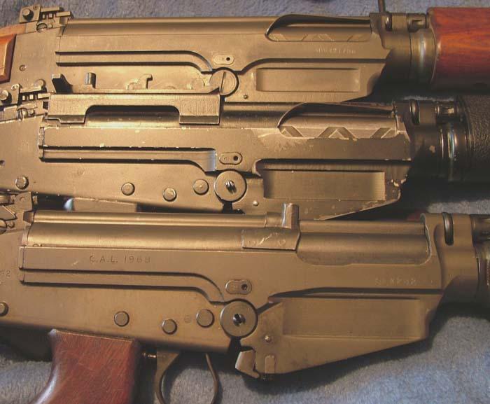

    Early (pre 1971) rifles and parts are only phosphated with a dark grey finish. After 1971 parts and rifles were then given a coat of black satin ‘stove paint’ to lengthen the durability of the finish. Stove paint was applied to exterior surfaces only. Magazines were always phosphated and coated with black stoving paint.
    Britishicon
    From the factory they were finished with stoving Paint over phospating. Magazines were always phosphated and coated with black stoving paint.
    Canadianicon
    The Canadians just phosphated their rifles right through production including their magazines.
    Top to Bottom
    Australian Lithgow L1A1 (1964)
    British BSA L1A1 (1961)
    Canadian CAL C1A1 (1968)
